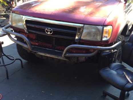

    I was looking in to a bumper that I could weld myself to save on the cost and found these guy who have a good looking bumper for a good price.
    http://nwtrailinnovations.com/
  3. Jun 27, 2017 at 2:53 PM

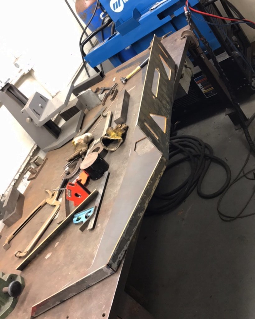

    Got water jet /laser and plasma at work. Very fortunate.
    Just got started. Tomorrow I got day off so lotta welding will happen

    I'm jealous! I got the same equipment at work but cutting my own stuff is a big no no.
    So I'm using cutting discs for the plate work haha

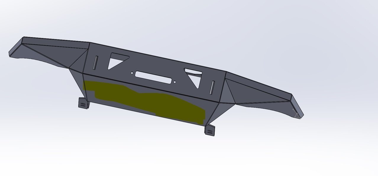

    Awesome. Watching progress. Do you have a plan or drawing? Or are you just rolling with it?

    If you don't already have a 30 amp 125 volt outlet, I would do that before trying to weld a bumper. With average 15-20 amp breaker you will be tripping it every few minutes.

    Long story short. A guy on ttora gave me 2D drawings of his bumper. I used the general dimensions (mounting etc ) and made my own in solid works. This is an older revision and doesn't show the whole winch assembly and support in the back. It's all I got in my phone. I'll post new one up later. I gotta go hunt down more material tomorrow.

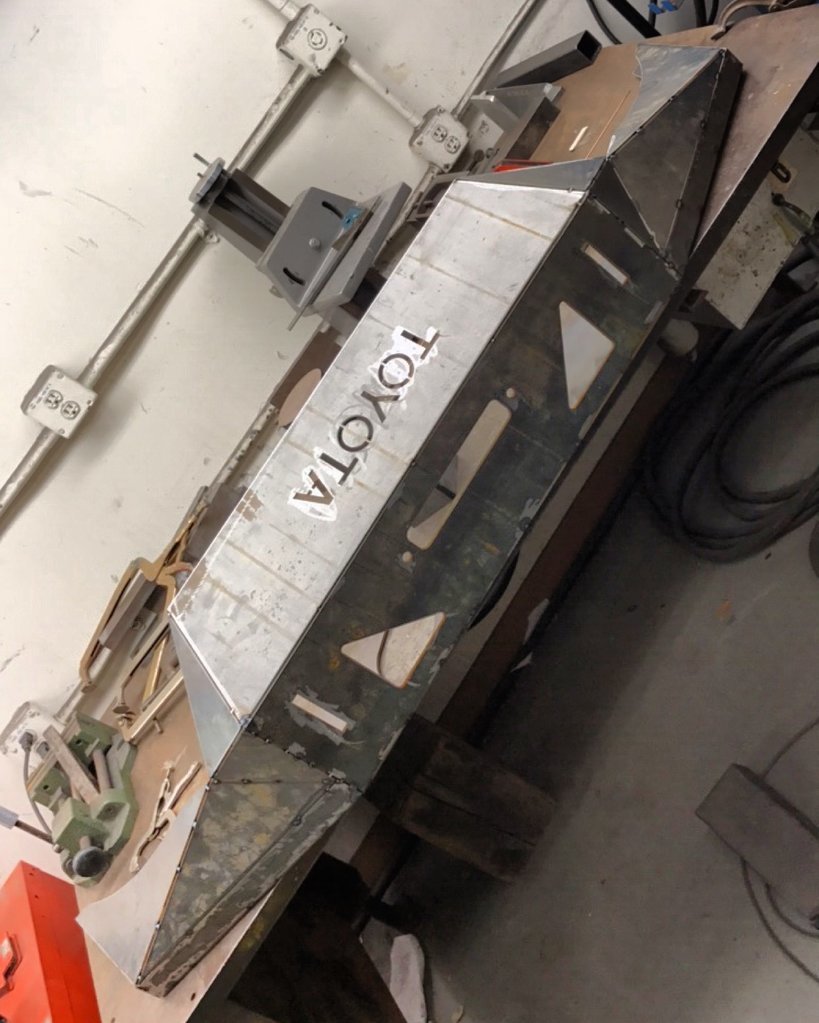

    Progress for today

    I've been welding over 25 years and I've had well over 10 different welders. A Lincoln 125is totally fine as long as your using gas not flux. Turn that dial up to 7 outta 10 and get the wire speed down to where you have no kickback and weld it up. I recommend using .023 wire and take your time. Take a grinder with a wire cup brush and clean all the joints really well and clean the material w some mineral spirits or paint thinner and it'll weld perfect.
    My favorite welder is my trusty miller 140 w .023 wire. I can weld 3/16 like a champ w that set up

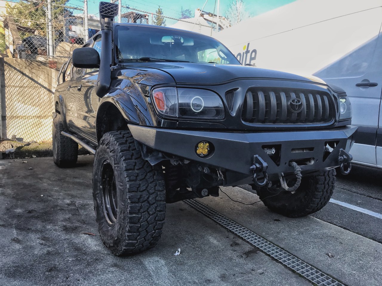

    Did you end up buying the bumper? If so how is it?

    Ended up making my own

    Looks good!! The Downside if it is friends be asking you to make them one.
    The Hard part is explaining why it would cost so much just to break even.

    Thanks and yea it’s also quite a process to go threw
