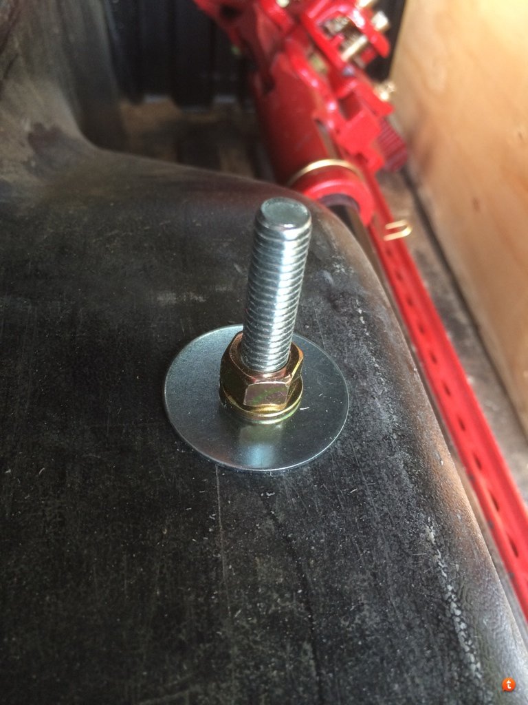

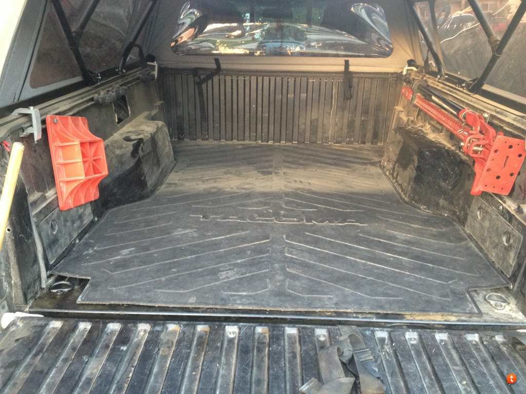

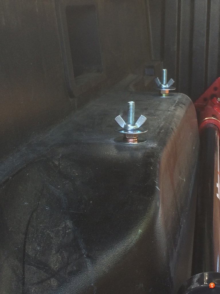

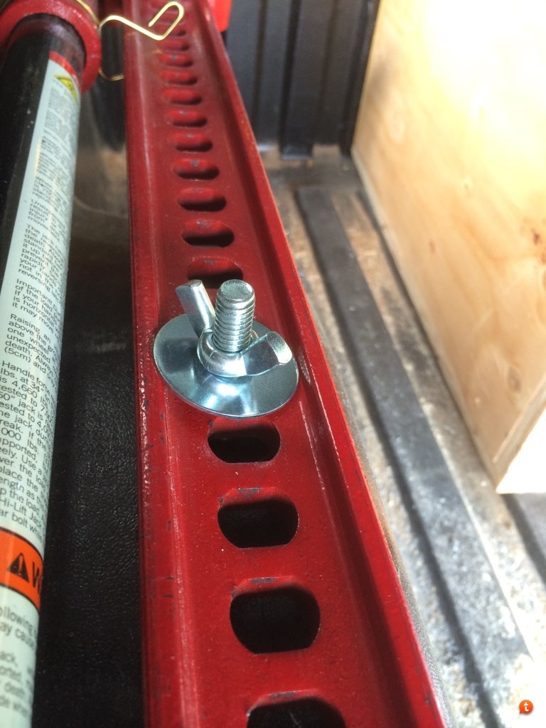

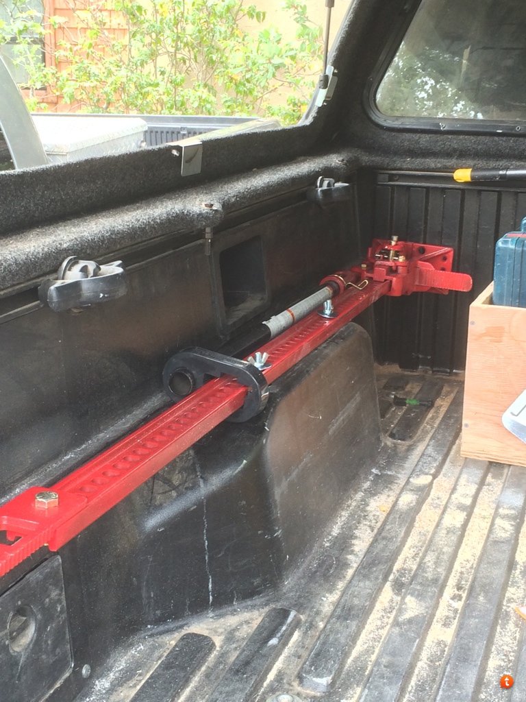

    For all people out there who don't feel like buying some specialty mounting brackets for your farm jack here is a good cheap alternative. It cost me $6 for the hardware. You can mount on the wheel well or on the sidewall of the truck bed
    $6.00 hilift mount:
    -6 3/8" fender washers
    -2 3/8"x2" bolts
    -2 3/8" lock washers
    -2 3/8" nuts
    -2 3/8" wing nuts.

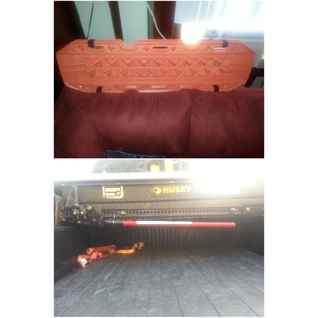

    I used the same method to mount mine to my tool box:

    I did the same but put it in the bed rails....
