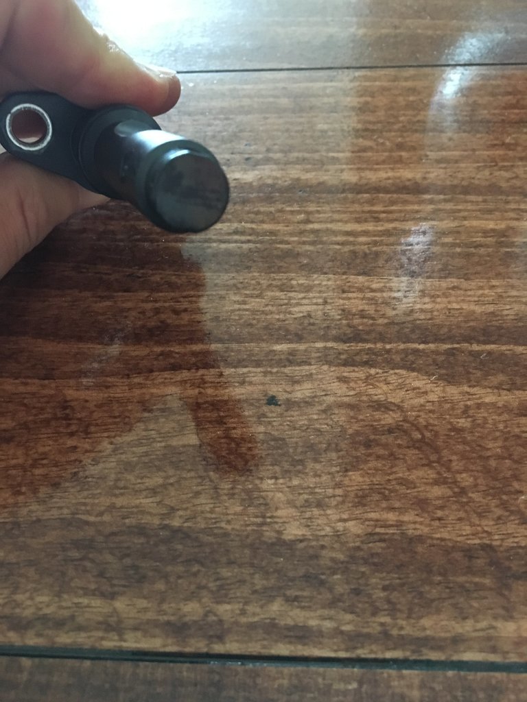

    I decided to replace my sensor for the hell of it as my truck runs drastically better on 93 octane....and it shouldn't. My truck has the updated part if the hash mark is the indicator. However, the old sensor had some sort of greasy splash across the tip that seems like it might be inhibiting the sensor function? I haven't drive it yet other than around the hood and it did seem smoother. See the photo for the grease smear.

    Mine had that stuff on it too. I didn't wipe it off for fear of it causing a problem since my new sensor doesn't get here until Friday.

    Well the new sensor doesn't have it. Maybe that is the extra "anti-corrosion" coating slinging off.....

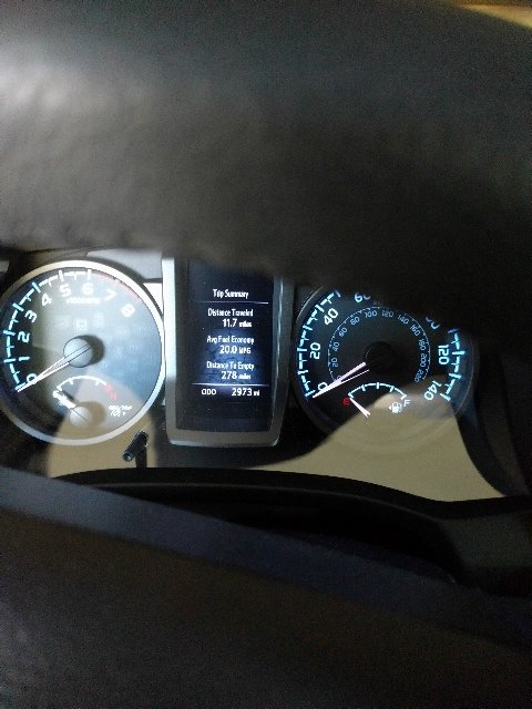

    I just finished CPS replacement. I didn't remove the tire which made things much more difficult. My factory installed CPS looked fine, but I swapped it out anyways. I wasn't sure if I torqued it to spec. I set my wrench to 84inch lbs. I got to a point where I couldn't rotate the wrench anymore, but I didn't hear a click. I am going to remove the tire and retorque tomorrow.
    I did my first drive and got 20MPGs!!!!
    I rarely get 20mpgs unless i hypermile and it takes at least 30 miles to reach 20. This time I did it in 10 miles!
    Looks hopeful! I will see if this is consistent over the next week
