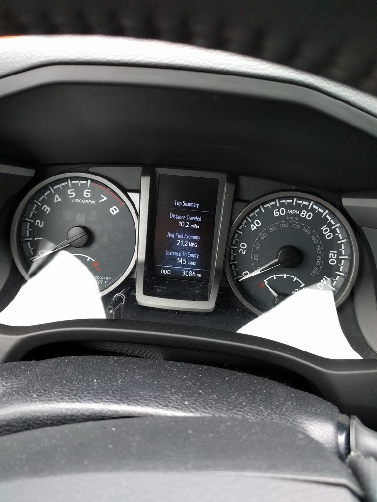

    Ok - Now I feel like I have an adequate break-in/learning period (~1500-1600 miles post CPS replacement). Commute this morning I clocked 21 MPGs - my best ever for my commute, prior to CPS replacement this same trip was generally in the 15-17 range...

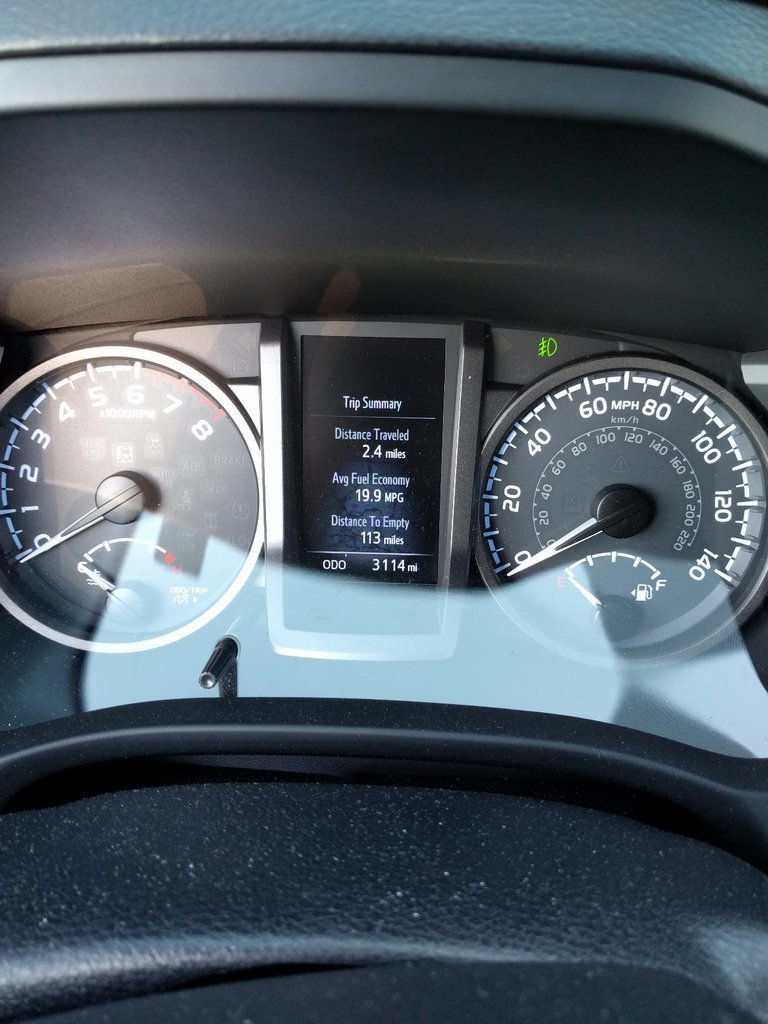

    I good results on my morning commute today. I have never gotten higher than 18mpg on this particular trip before. I commute to different places all the time. When I immediately got of the highway this morning my trip mpg was 22+, the EPA rating is 20mpg for my trim model. This is the expectation I had when I purchased this car.

    I just got 19mpg all city (upshifting) whereas I usually got 15-16!
    But Tacoma World said I got bad MPG because I was a dumb driver? :)tmp-cam-299586778.jpg

    Congrats! I'm staying in the 19-21 range around town now for the last several trips and had similar MPGs as you before.
