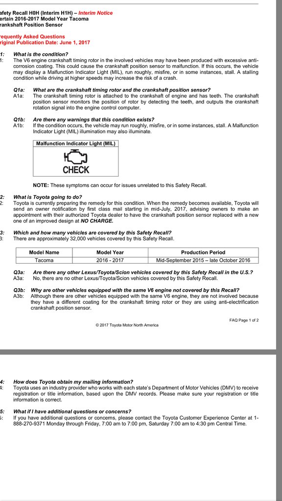

    I'm thinking that if my truck makes it to the recall list then right before I go in for servicing I'll put the stock CPS back in (since it didn't quit working yet) and have it replaced with a new one then go back home and put my "old" new one back in and sell the "new" new one rather than deal with trying to get the money back from Toyota.
  5. Jul 7, 2017 at 9:47 PM
    #85
    DKH
    DKH Member
    Nov 15, 2016
    #202451
    24
    In this case, I believe the letter serves to notify you that the recall is active, since it is still an interim recall at the moment. Meaning if you bring it in to the dealer, which I did for this recall, they will not do anything since Toyota has not officially released a remedy or a redesigned CPS. So I'm also waiting for the letter/checking the toyota recall website to see if the recall is active (which it isn't as of today).
    According to shakerhood, my warranty shouldn't be voided if I do it myself, so I might order the part and do it. HOWEVER, when I called the dealer today to see if they would be willing to change the CPS with the old design, they said the old design doesn't exist anywhere in North America, and so they can't do it. I think that's bullcrap since I went to parts.toyota.com and they're allowing me to order the crank position sensor

    I confronted my dealership SA 2 days ago on this CPS recall and asked him a simple question " if the CPS recall is only for those that fall under the guidelines of this:
    Then why can't you just install a new CPS sensor that was made post October 2016 that's not on the recall list while we're waiting for the official fix?
    He says " because Toyota doesn't have a remedy yet"
    :boink:
    But FYI if you do replace the sensor yourself pre-recall "Fix" by law they will have to reimburse your expenses.

    So this tells me two things. Those of us NOT on the recall either 1) Dont have the excessive coating on the crankshaft rotor itself or 2) We may, but have the sensor that contains "anti-electrification" whatever the heck that is. Looking forward to learning more. Either way, I'm glad I did mine and have a spare.
