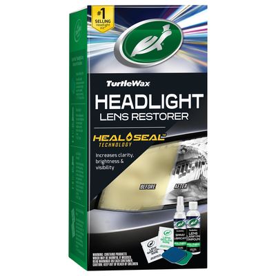

    Now its time to polish
    I used a turtle wax headlight rubbing compound bought at autozone
    And your DONE!

    3M also has a great product that goes on a drill. I did my 10 yr. old Odyssey. Originally I did the manual route with some fine grit paper and then polish all by hand. It was o.k. but started to oxidize again. So, I tried the 3M product and it's great.

    I own a headlight restoration business. The kits you find at the auto parts store (3M, turtle wax, ect) are a temporary fix at best. In most cases the haze will reappear within a few weeks if a wax or polish is not constantly applied. When you restore a headlight and strip all that yellow/oxidation off, you are stripping off the original UV coating that came on the light from the factory. If that coating is not replaced, you leave the light vulnerable to further damage. A sealant must be used to protect the fresh plastic. I have developed my own sealant, and am in the process of developing a kit for all you DIYers.
