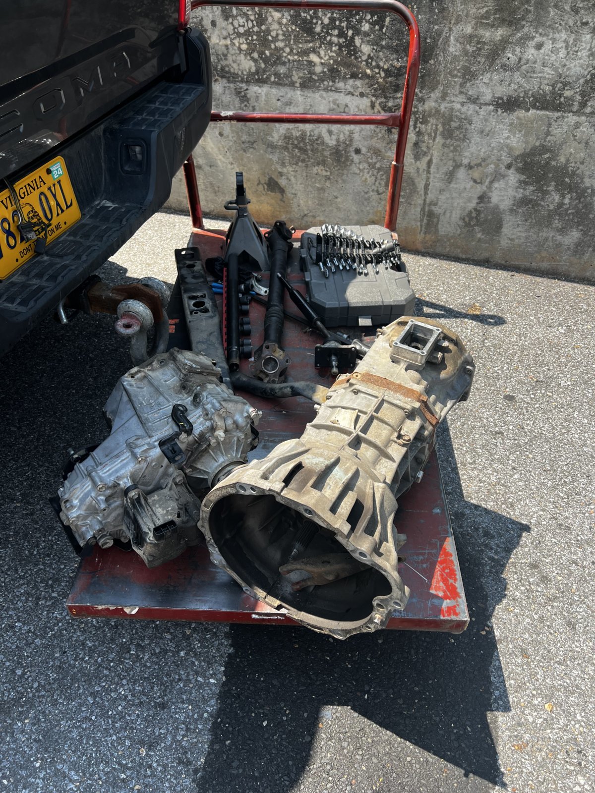

  9. Feb 3, 2024 at 12:23 PM
    Sep1911
    Sep1911 Well-Known Member
    Oct 2, 2015
    #165670
    1,237
    2016 Taco
    It’s fairly straightforward. Need to disassemble the center console, remove the shifter assembly. Then everything else is pretty much under. Compared to the clutch you did 30 years there’s going to be more wires and hoses. Gotta disconnect all that patiently and hold it out of the day.
    Would be a good time to do your transmission fluid. When you remove the transfer case oil will come out the transmission. I benched my transmission in so I separated them to lighten, if you’re not doing that then no need.
    I would get new fly wheel bolts personally. The threads in the crank go all the way through and the factory bolts have that goopy thread locker on them, and they are torque to yield. But this engine is so overbuilt that I wouldn’t be surprised if people reuse them with thread locker.
    Torqueing the bolts was a challenge. It’s some value + 90 degrees. You have to really hold that crank. I don’t recall what my situation was since this was a while ago, whether I couldn’t find my breaker bar to put on the front of the crank or what, but you can mark the 12 o clock and 3 o clock and just impact the bolt ~90 degrees. ‍♂️
