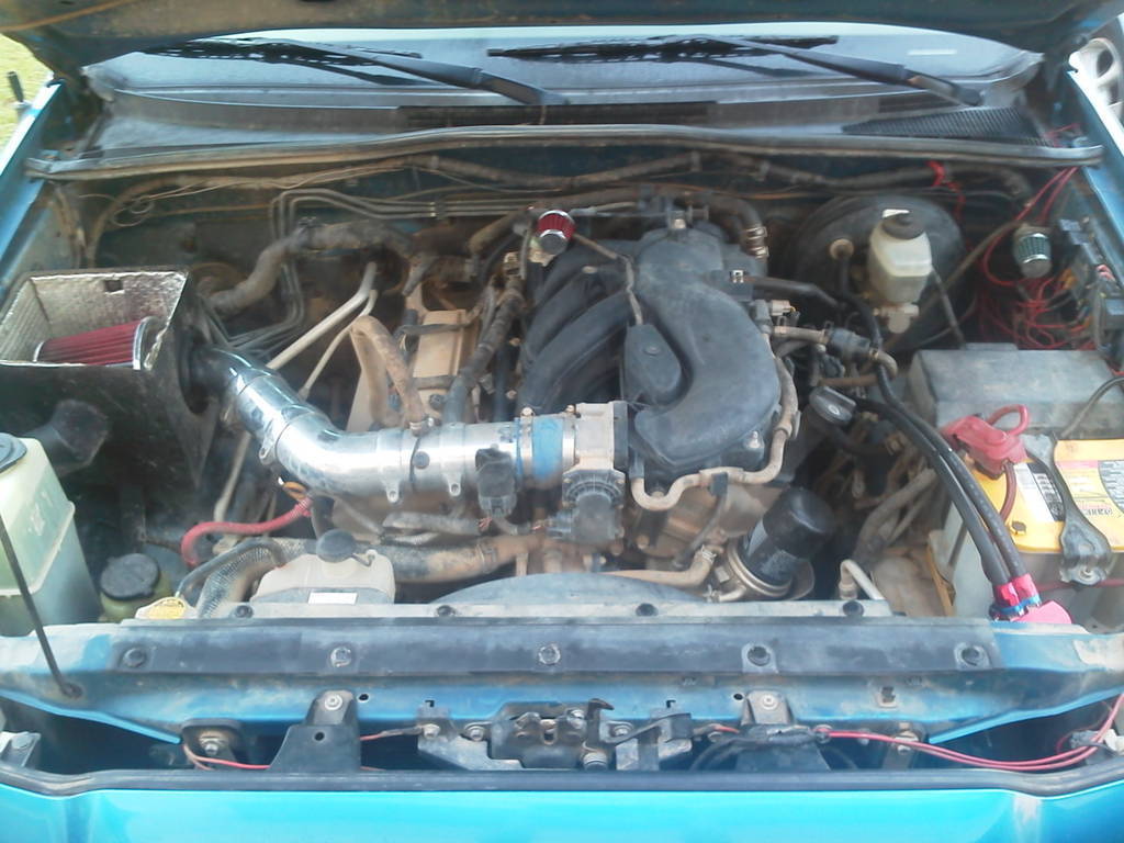

    I built mine a little over a year ago. used some clamp together pieces for the tube, a universal oilless cone filter, and welded up my own box with a tube taking air from the factory spot in the fender. It's not pictured, but i did build a top to seal off the box, but i rarely have it on. when i monitor my intake temperature, an open vs closed style box does not vary the intake temp. whoda thunk?
    no gain or loss in the mileage or performance areas (as we all know and expect). i think it just sounds fun :rolleyes:

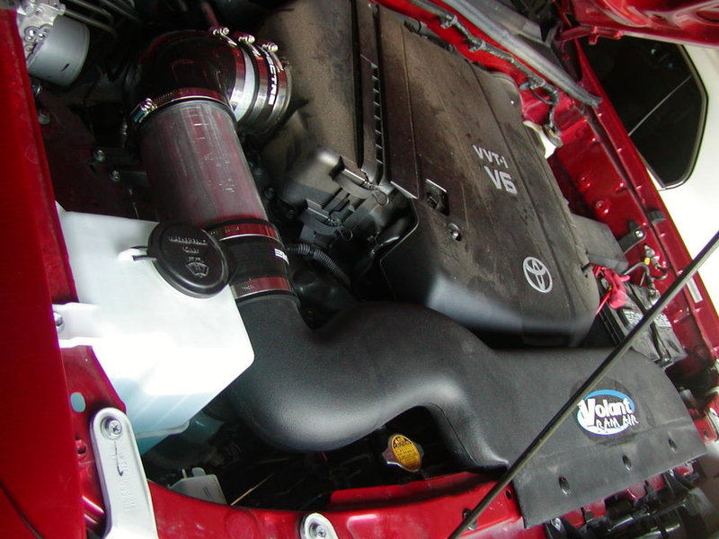

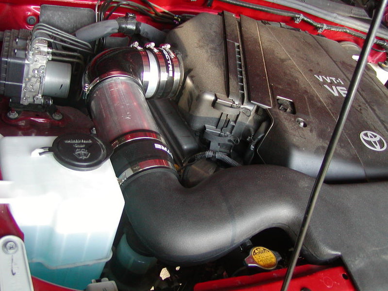

    Not wierd, looks like my pics were removed. Not sure what I did with them now. Basically what I did was found a used Volant AirRam and plumbed it into the stock intake box (the one on top of the engine) with a couple of silicone couplers, an elbow and a chunk of aluminum pipe.

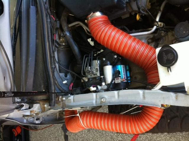

    here is my cold air intake. It was built more to keep water out of the intake (not having to use a snorkel) and dust/rocks form entering the intake in teh fenderwell since I have glass fenders its completely exposed. People always laugh and say its a true cold air intake cause when you have the AC on it cool air form the cab (i guess in the winter time is means warm ;) )
    a guy in socal here on the forum contacted me for a parts list - he posted a video of the sound in the cab. Its no worse than a cone filter under your hood. You hear it growl under hard acceleration but unnoticeable when cruising:

    ^^^ that sounds badass, and now thats a true custom intake, nice thinking....did it actually help at all?

    The point was to keep water out of the intake and not having to install a Snorkel.

    Bingo! was expecting or wanting any performance enhancements - purely for water, dirt and debris.

    Nice! Question though..
    Why not just leave the OE intake tube as is then, and do your mod with the red ducting from the fender elbow on, leaving the engine bay stock...if what you wanted is an internal snorkel type device..
    Seems like removing the stock "intake tube(between fender and airbox)" is your version of an Intake Flow Accelerator mod or Intake Silencer Removal mod.(which is what I'm looking to do)
    I would be worried the red ducting might be too flimsy. So im considering a hard plastic tube
    http://trdparts4u.toyotaofdallas.com/scripts/prodView.asp?idproduct=-9264
    Anyone know if ^this^ works with stock airbox, replacing the OE intake tube?

    No and not flimsy at all
