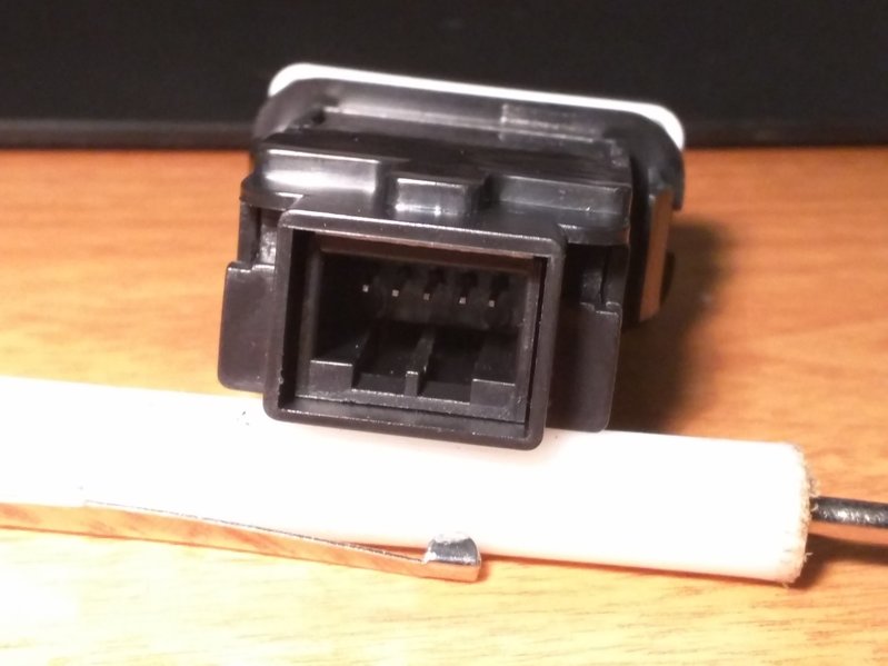

    I'm swapping out my foglight switch for this switch for my light bar! #aironboard. This will show you how to convert your push button switch to work with factory fog light wiring. You will need to cut two traces and solder in two wires to make this work.
    Parts:
    aironboard.com push button switch
    Sumitomo TS 025 Female Terminal
    22ga or smaller wire
    Comparison
    Factory fog light switch wiring pinout
    Disassembly
    Original switch wiring diagram
    Modified diagram, with fog light circuit for reference
    Finished wiring
    just scratch of the two traces and solder 2 leads between the pins as shown.
    Finished Installed

    Isnt the upper led suppose to only come on when switch is closed?
  3. Dec 26, 2015 at 4:39 PM
    Sandman614
    Sandman614 [OP] Ex-Snarky TWSS elf, Travis #hotsavannahdotcom
    Oct 26, 2010
    #45273
    35,879
    Tim
    Garner, NC/Boone, NC
    '06 SR5 Off Road
    Yes, and it does. Switch on upper led is on and the fog light circuit is on. D1 = upper led.

    Awesome! Sorry got confused with the pics posted

    Oh I see what you mean. There is some bleed through from the lower led to the upper window of the switch.

    Yea after i looked at it i noticed it was bleeding through
