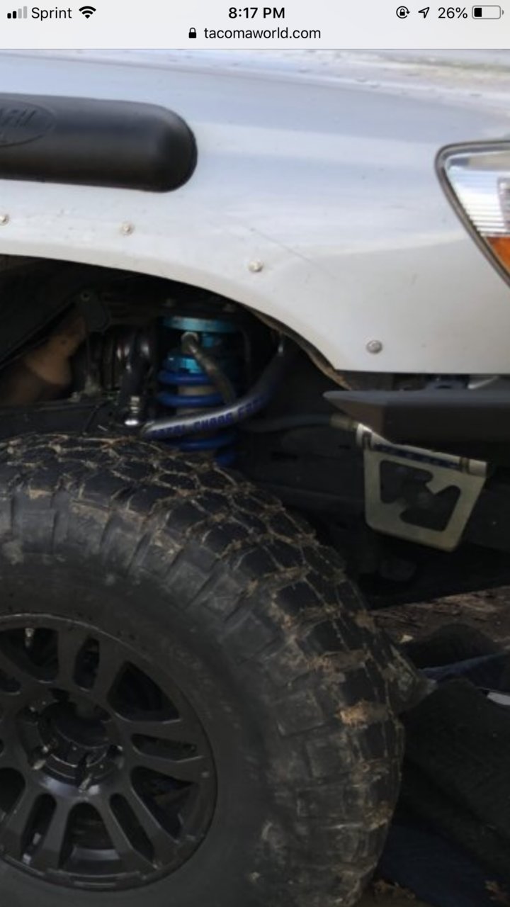

    Lt coilovers never come with the resi Mount either. These are 100% std travel or ext travel oem replacements

    Oh okay well learned something new. Regardless of what I have now, what steps do I need to take to prepare for what I want to do later? Something with good travel off the street but descent specs for on the road
