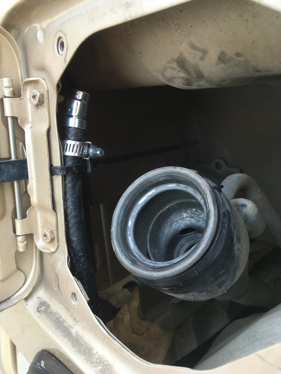

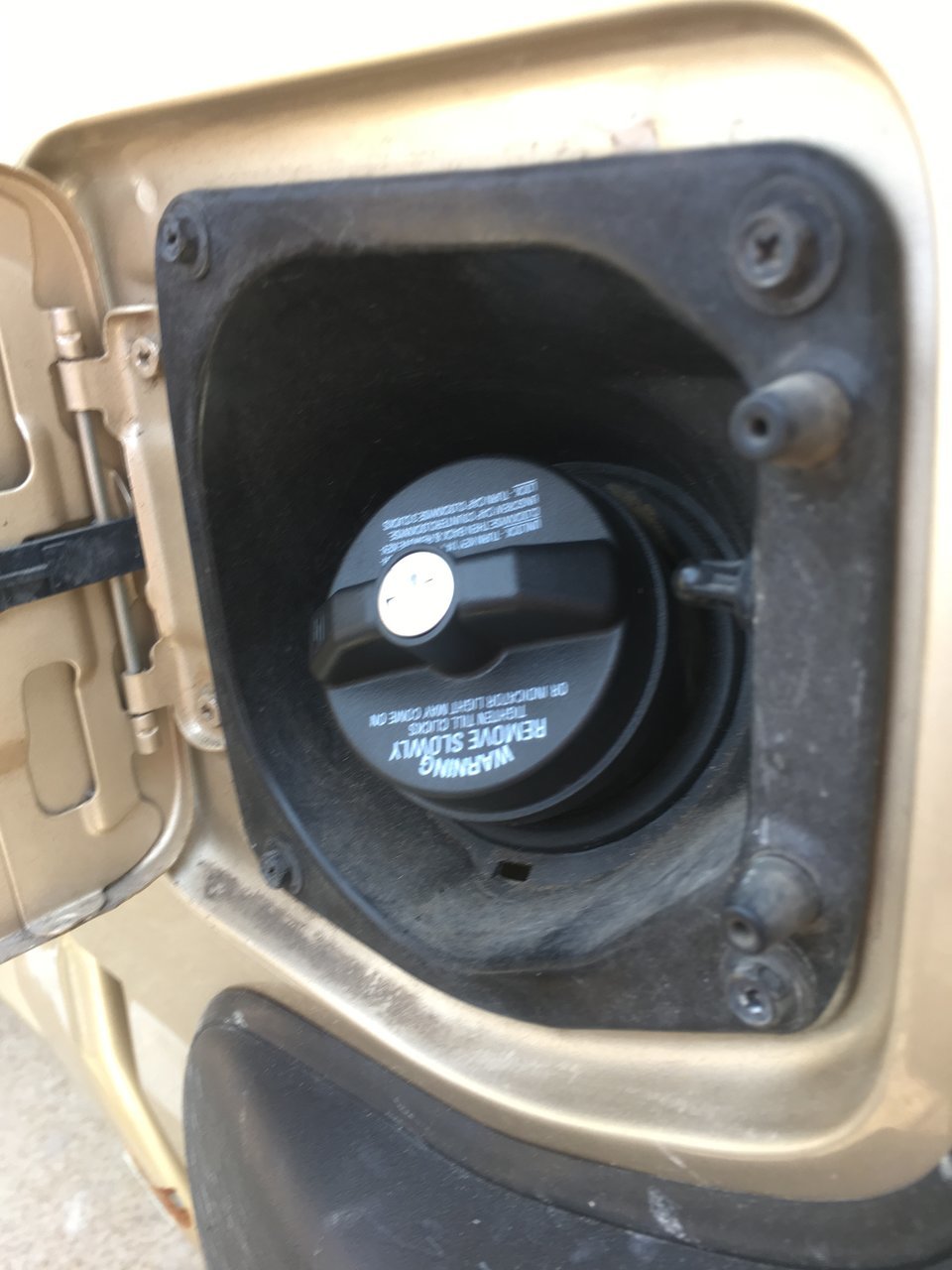

    Finally did my diff breather. Just zip-tied the new breather valve on the inside of the fuel door opening. That way it’s straight up and down, and out of the way.
    Anyone see any potential problems with this location?

    dorkknight likes this.

    That is probably what I will be doing too, I don't find it necessary to route it to the inside of the fuel door, kind of pointless IMO.

    Only advantage I can see is if the gear oil seeped or not.
    Don't know if that's a diagnostic for anything serious wrt pressure in the diff or not.

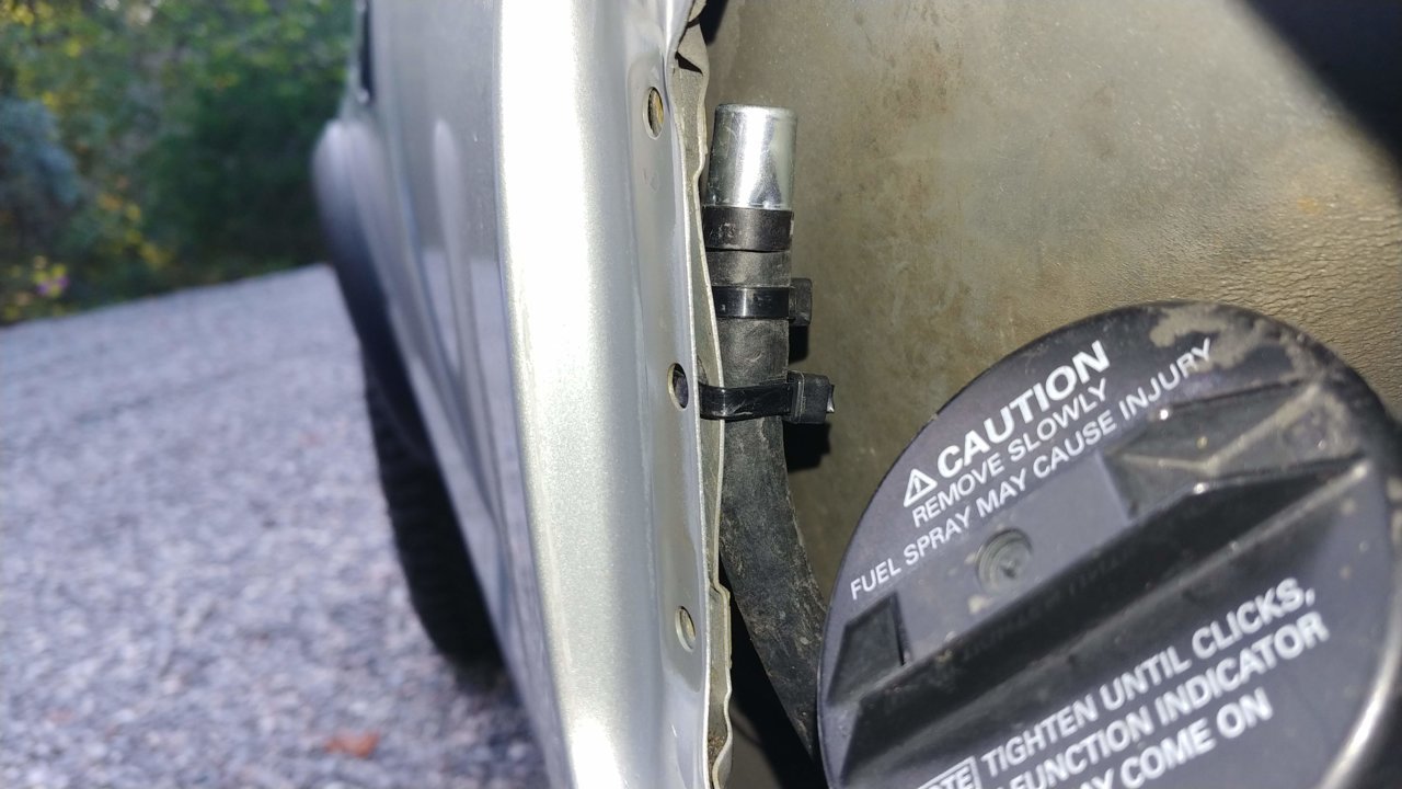

    I followed this installation as well. I didn't have hose clamps small enough for this size hose; I figured without how tight the hose was on the breather that a zip tie would suffice. I took advantage of the situation and thoroughly cleaned the shite on the side of the gas door.

    Has this been high enough for you so far? I ended up bringing mine to my snorkel but I think that's overkill
