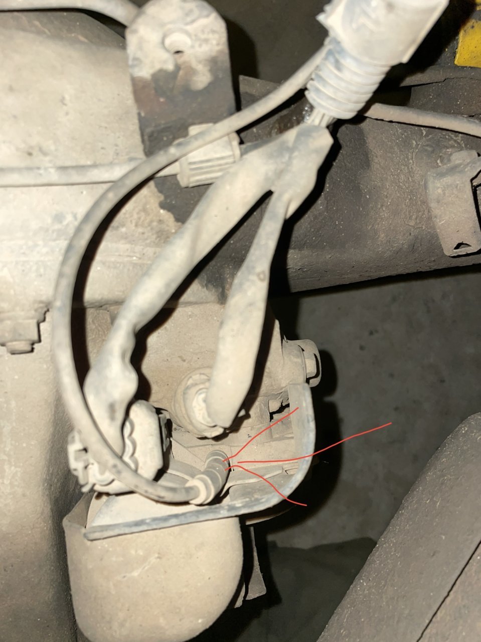

    What is this Tube? Comes out of the actuator motor. BD3E0869-E1A4-46CA-8F73-AF412CB987D4.jpg

    Man, I cant remember. Maybe someone else can pop in and be able to answer.

    Trace it back. I'm almost 100% that is a breather line for the actuator.

    When I first saw it I thought that it was a vacuum line. But after tracing it back up it just goes to a grommet in the frame and stops there it doesn’t continue on. So I can confirm it is just a breather line .
