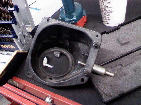

    finally doing this tomorrow after work along with some maint and suspension work. will post some pics asap......

    union installed with thread sealer

    using a 86 honda accord filter. since i work at honda it was cheap and available.

    fitting nice

    all finished. took no time time and came out awesome. great mod, great thread!
