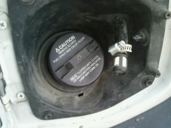

    Quick suggestion here...I had a revelation that instead of using an inline fuel filter I should just use a chainsaw fuel filter, since it attached to the end of the fuel line inside the petrol tank. Only 3 bucks at a parts store. The result after I tightened the hell out of the hose clamp:
    It's final place is pulled back into the filler neck covering...I pulled it out for a better view.

    I think it looks like sh*t when you mount the breather where the gas cap is;not to mention the clamp is sharp, will eventually rust, not mounted vertical which is incorrect and you don't want to potentially cut your finger (someone elses) while removing the gas cap on the medal clamp. Good luck.

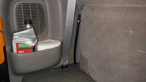

    just relocated mine today but put it into the cab instead of by the filler neck. way less dust i have to worry about getting in and wont get in the way of filling up with gas.

    2) Mount vertically as appropriate; not near gas cap. Looks like sh*t and is proned to get water in, if placed there.

    alright guys silly question here... but does the relocation inside the gas door get in the way of filling up or closing the door at all?
  19. Nov 5, 2012 at 10:01 AM
    #99
    garys05tacoma4x4
    garys05tacoma4x4 OneLife
    Jun 10, 2011
    #58072
    78
    Agawam, MA
    05TRDSportLB4x4
    Synthetic oil/lubes used throughout. NGK Iridium Lazer 100K spark plugs. Rear differential breather extension modification. Toyota front skid plate, roof rack, bed mat, chrome exhaust exhaust. Runs like new!
    This applies to 2nd generation Tacoma's (05 & up) as to a good breather location. 1st generation Tacoma's. I'm sure you can find a better place than the gas cap area and mount it horizontally so it breathes properly. Only takes plastic wire ties to mount underneath somewhere.
    (Copy & pasted from prior post) I don't agree w/using gas/misc filter-not needed. I don't have the part #'s but your simply using differnt factory parts to replace what you had a in adittiion to a 6'0 rubber 3/8" hose. I'm sure if you tell a decent Toyota parts department what your doing they willl be able to look up & sell you the screw in piece at the rear diff to attach hose (aprox 6'0) which will end with a stock breather part for the end of the hose. My mechanic & I took out the recessed box located on the bed Drivers side-toward rear of truck located inside bed) drilled 4 holes, wire tied the hose in 2 places (for secure connection over time) and "kept the hose vented in the VERTICAL direction like it is suppose to be done" (just like you viewed it coming off the rear diff originally).
    I notice many people mount them sideways. Not correct according to my 30+ mechanic. Good luck. Upgrade to synthetic oil ALL AROUND so you will not have to touch again for a very long time is sugested. If you have limited slip rear diff, I could only find the proper fluid at NAPA at about $16 a quart-discounted price. Note: Front diff, transfer case and engine oil can all be purchased in sythnthetic which is better and long lasting for your vehicle. Try to find all your fluids at Walmart 1st for best price. Good luck.
  20. Nov 11, 2012 at 5:42 PM
    #100
    Kirk1589
    Kirk1589 Well-Known Member
    Aug 18, 2012
    #85019
    5,196
    Dave
    Sticks-RI
    03 SR5 Off-Road
    Pasti-Dip Grille, K&N drop-in, Magnaflow 14", Custom tail light mod, Fog light mod, diff vent mod, Alpine Components, Sequoia JBL radio
    Not at all.
    I have vent cap on now
