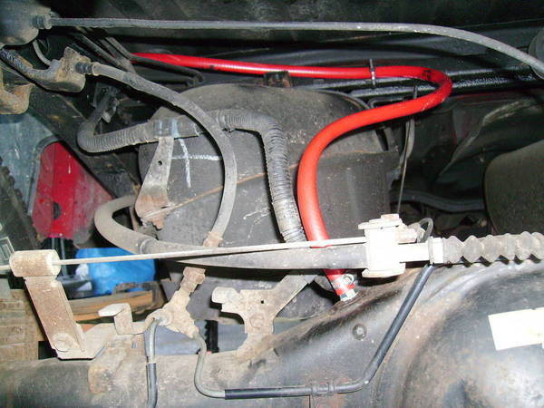

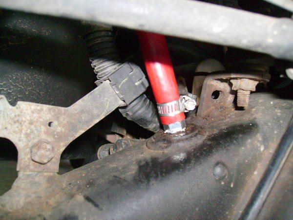

    Did the rear diff breather today. Happy with how it turned out.

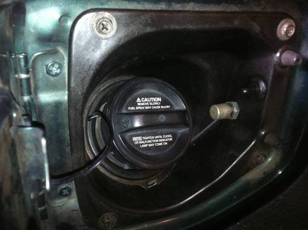

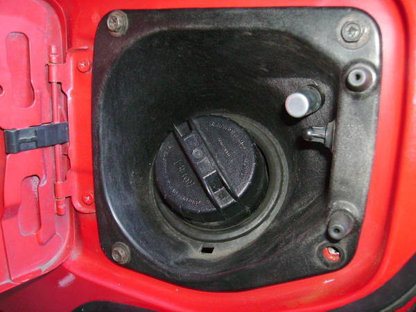

    The stock breather is threaded on the side that goes into your diff. Trying to push the tubing and secure it to the threads is not a good option. Thats why people buy a new breather that's barbed as opposed to threaded. Make sense?
    Look at the top two breathers in the pic below. The one to the right is what is in your diff stock and the left is the one people buy to put in its place (usually in the gas filler pocket)
