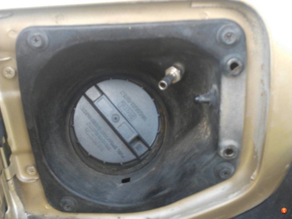

    Did mine today. Wasn't planning on it but I got up under the truck to look at something and the breather caught my eye. I dug through my tool box misc drawer and found a hose barb that probably came with a gauge or something, the thread pitch was the same as the stock breather. I taped it and installed it and then dug around the garage and found some nylon 3/8" high pressure pneumatic hose. Slipped it over the barb and clamped it down with a crimp clamp. I fed it up into the wheel well and drilled a 3/8" hole in the filler neck plastic and put another barb on that end to keep it from slipping out. I left enough room for flex and zip tied it to the crossmember. Cost: FREE. Time: 10 minutes.

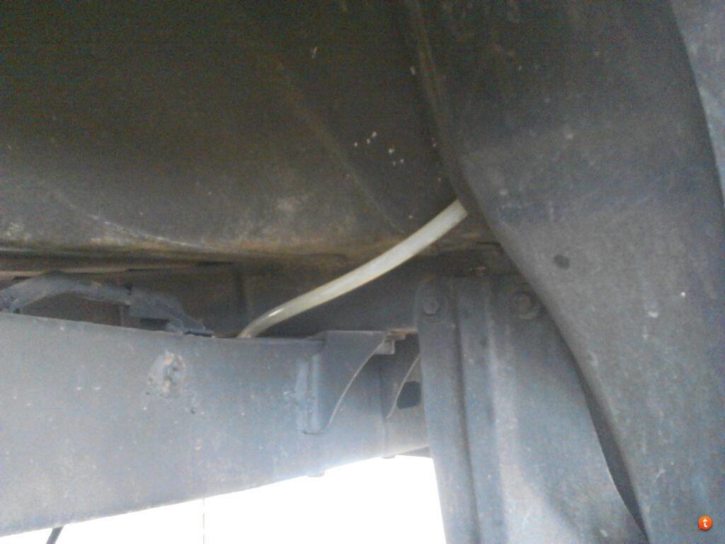

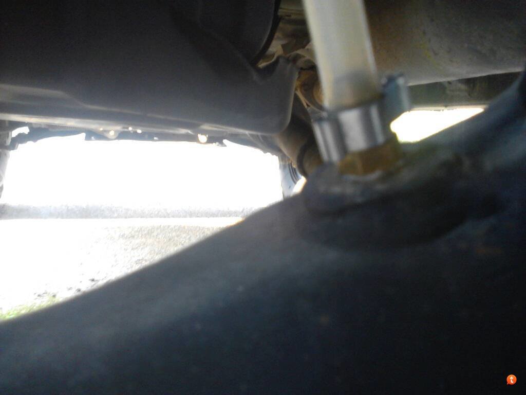

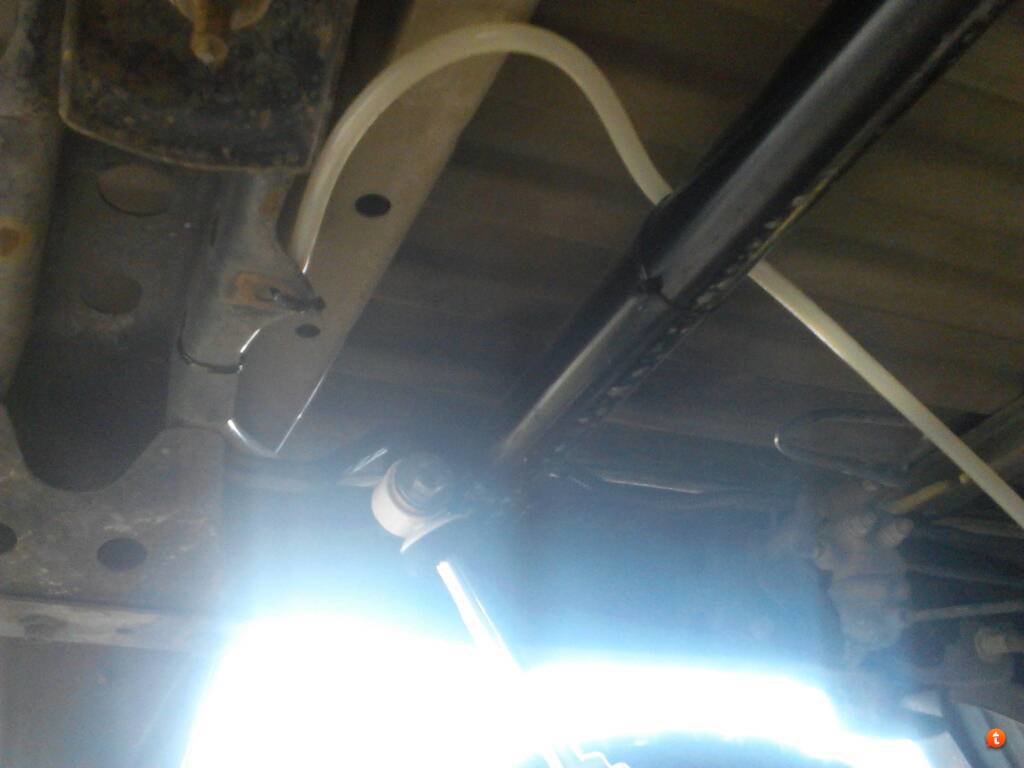

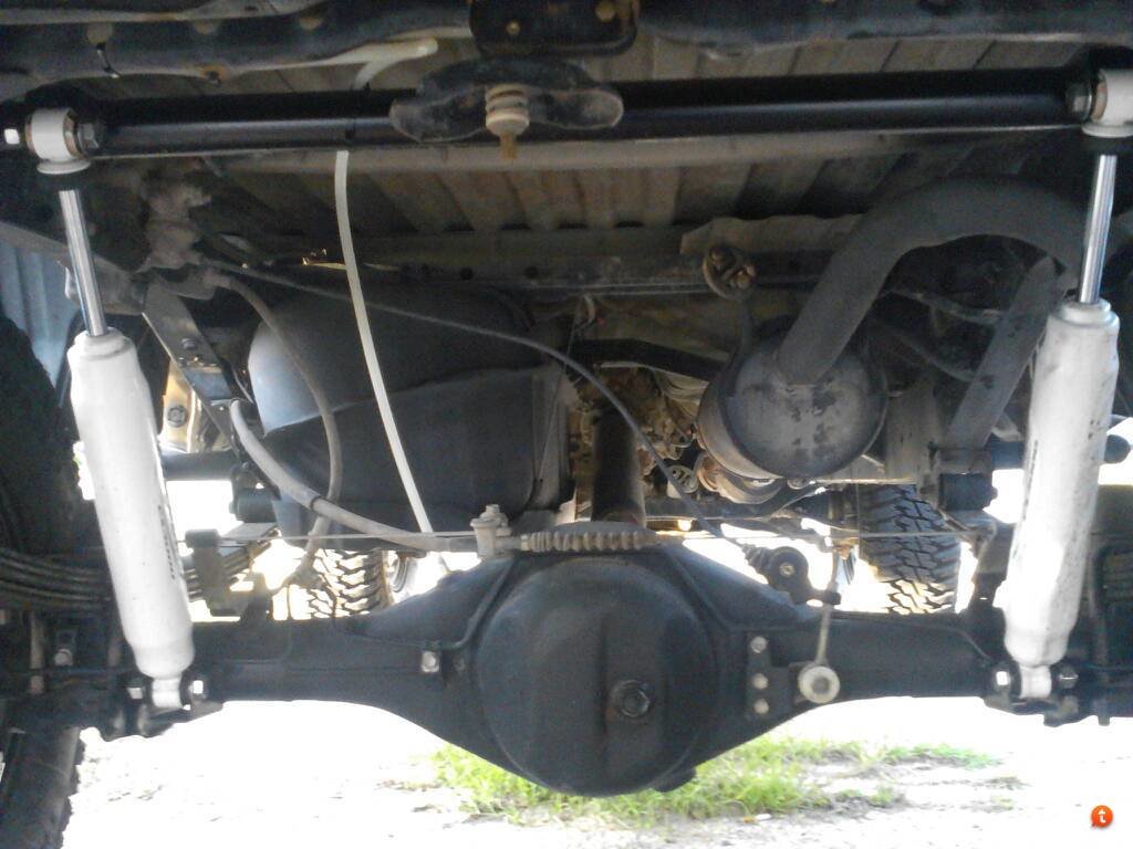

    Rear view...
    Hose barb with 3/8" nylon hose clamped...
    Routed up and zip tied to shock crossmember...
    Over the frame rails and behind the inner fender well cover...
    And out of the fuel neck with another fitting to keep it from slipping out of the hole...
