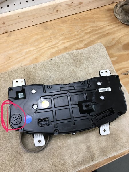

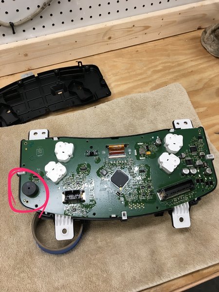

    5. The chime speaker is built into the back of the cluster. You need to remove the black plastic panel to gain access to the speaker. There are a few tabs you need to pry up to remove it. Be careful. The round black thing with a hole in the middle of it is the speaker.
    6. The speaker is soldered onto the cluster's circuit board. I just twisted it back and forth until it broke off. No more annoying door chime if you open the door before shutting off the engine.
    It took me longer to figure out where the sound was coming from than it was to actually remove it.
    This is a permanent solution unless you want to solder the speaker back to the board...

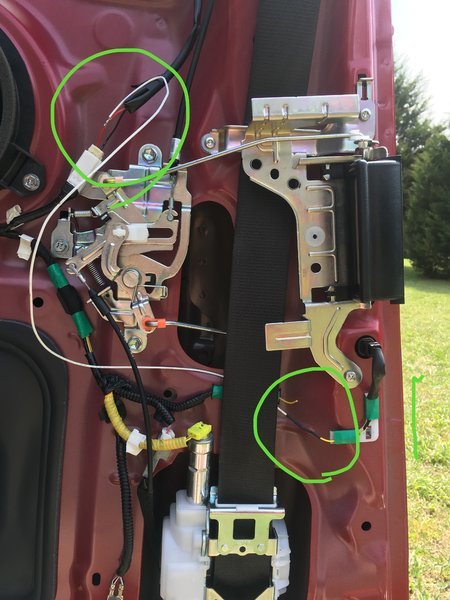

    Another member found the switch in the ignition and removed some parts to silence the annoying beeper.
    This is what I did on my AC:IMG_0245.jpg
