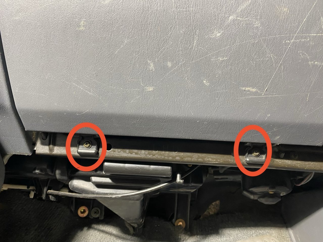

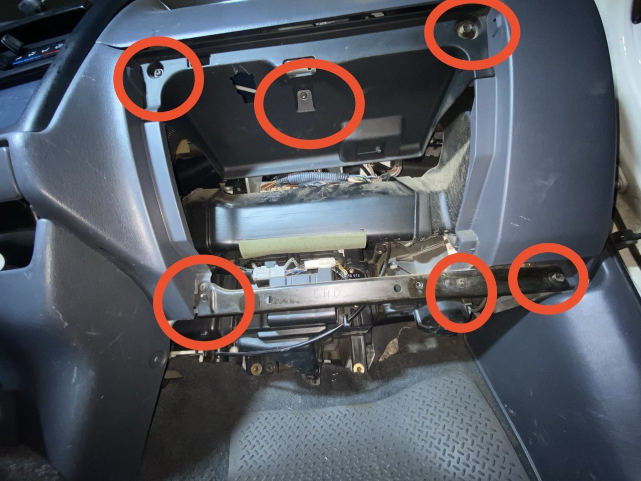

    1.Remove the glove box

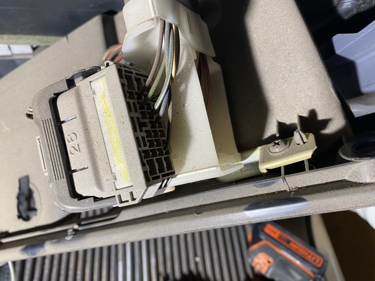

    2. Remove all this screws and remove the steel bar and the upper plastic cover which has 1 screw holding a harness. Remove that screw also.

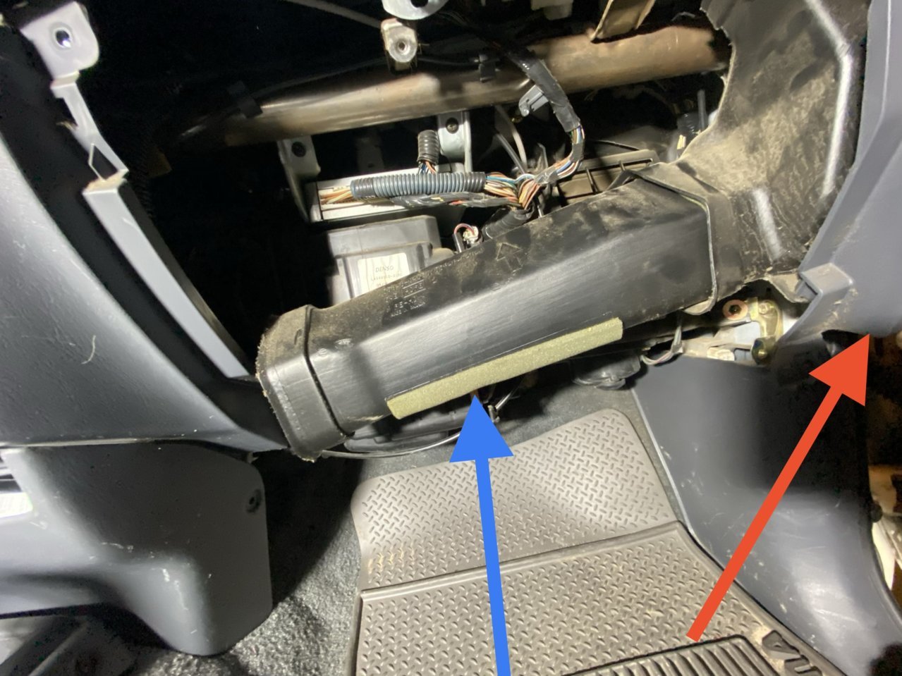

    3.Remove the middle duct by pulling gently the right side of the dash(Red arrow)

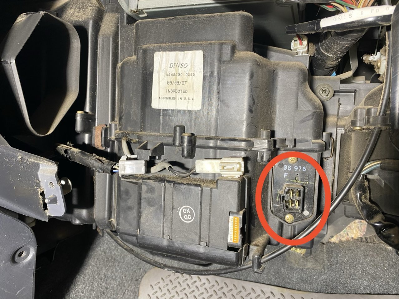

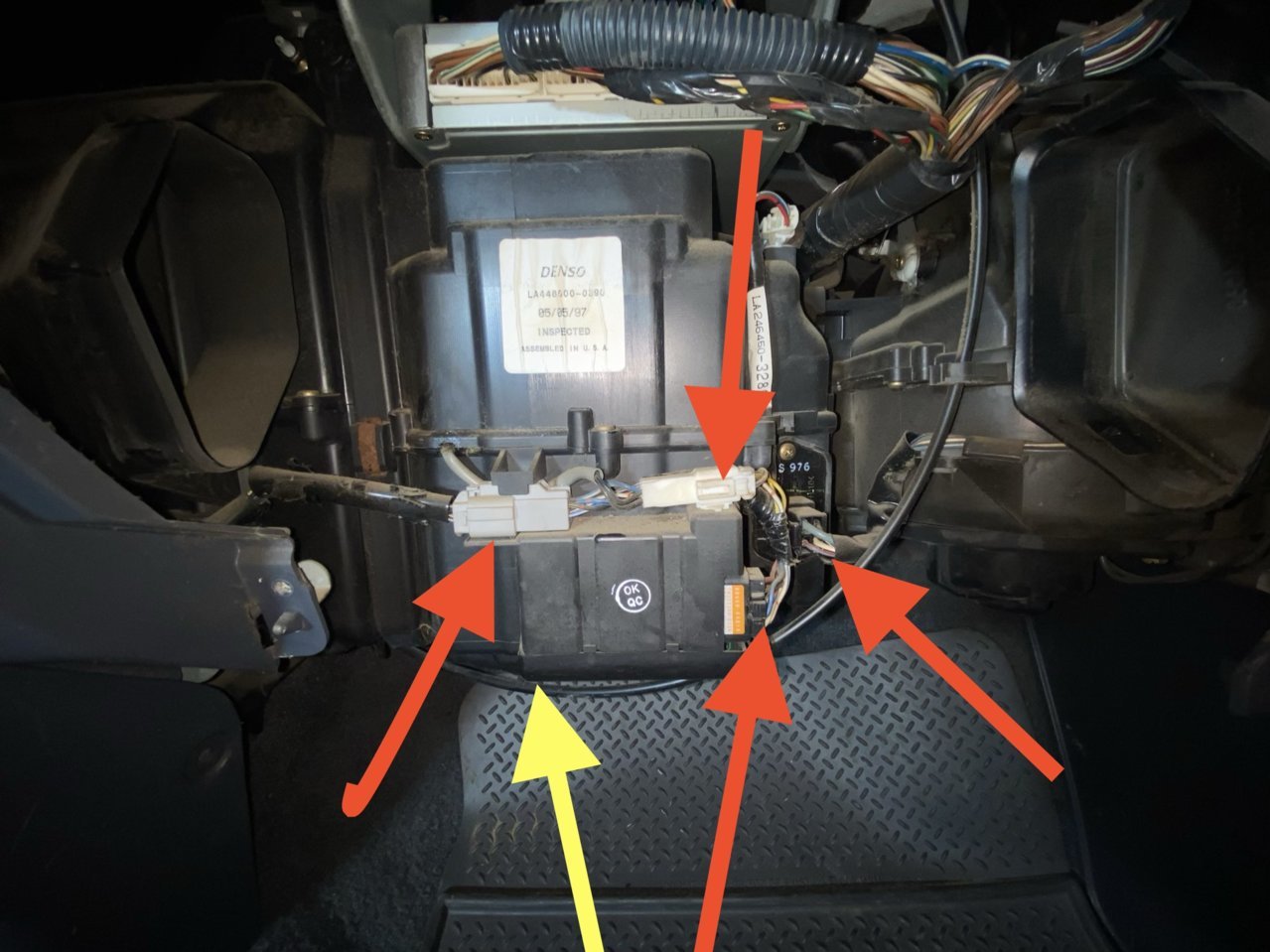

    4. Disconnect all these plugs. And move the wire out of the way(yellow arrow)
    5. Remove these holding pin and screw.
    6.Remove the fan blower resistor

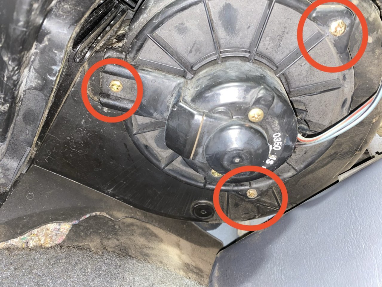

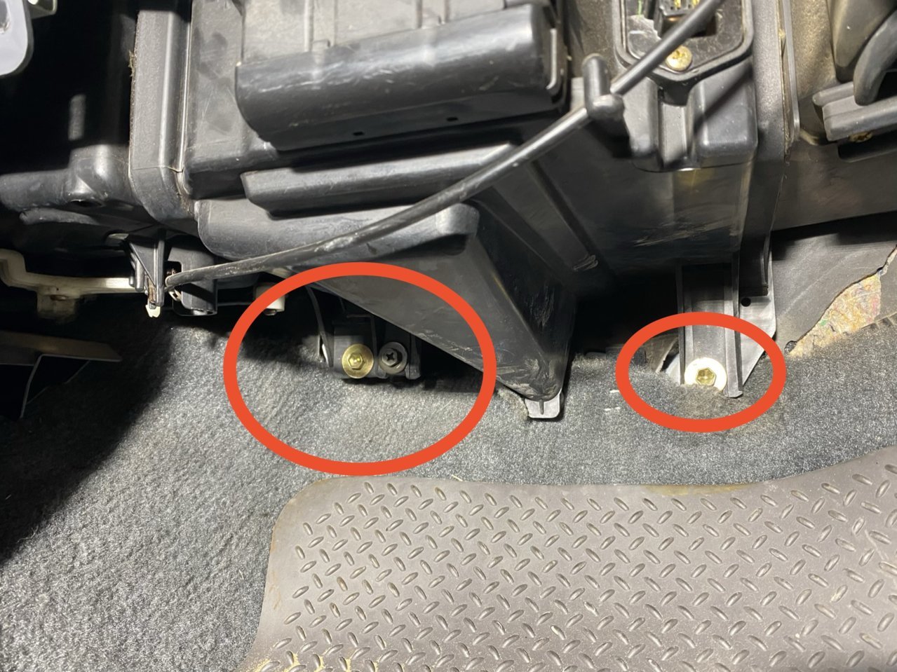

    7. Remove the bottom screws

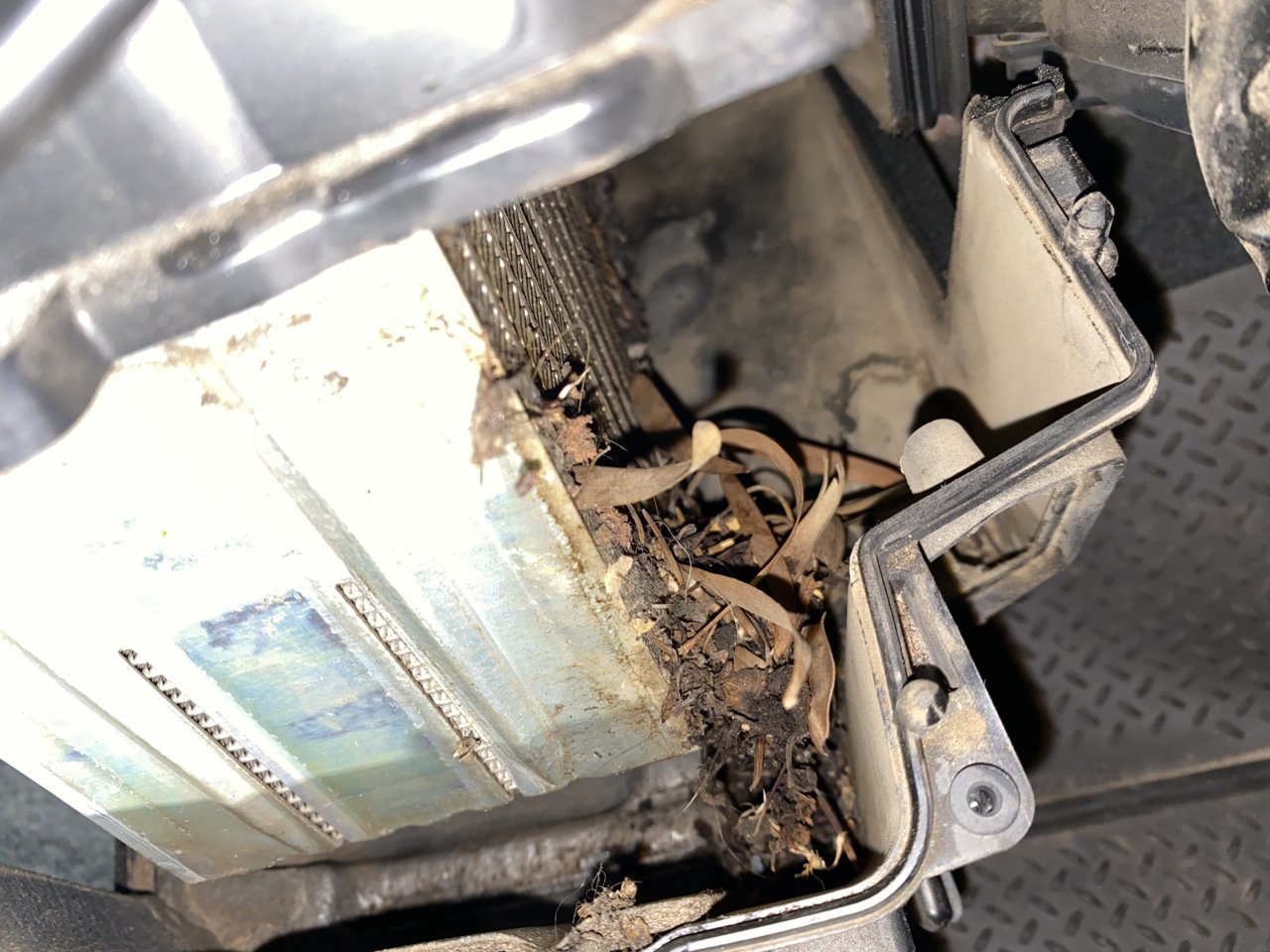

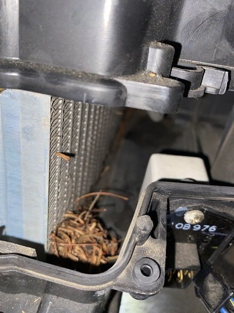

    8. Gently open to expose the evaporator. Will not open completely since has more pins behind. But this will give you enough space to work on.

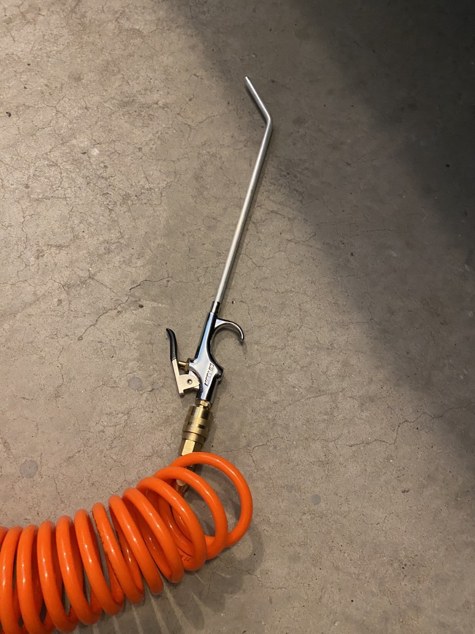

    9. Use compressed air to clean first

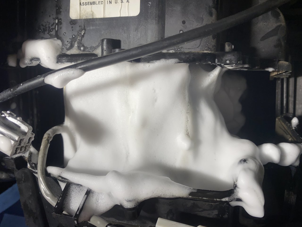

    10. I used this spray. Is water based and scented with lemon. Home depot $5
    11. Spray foam and clean with compressed air. Repeat 3-4 times until spray foam comes without dirt
    Dry as much as you can the evaporator. Use shop towell to absorb any moisture and water. Also make sure the drain is in place after reinstalling everything.

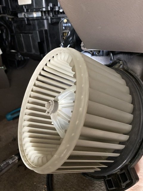

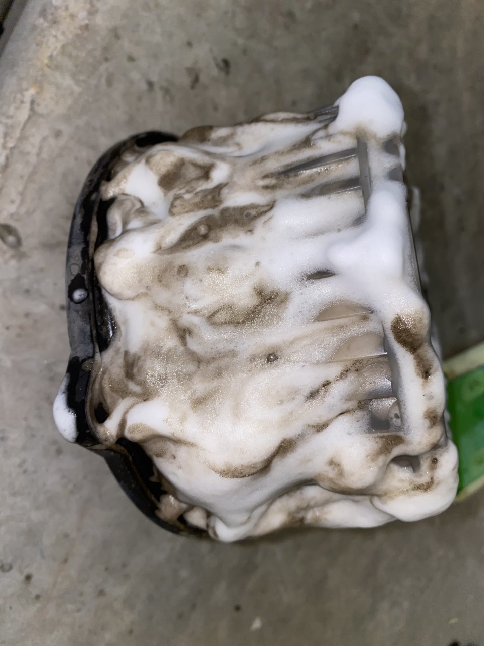

    12. I also cleaned the blower
