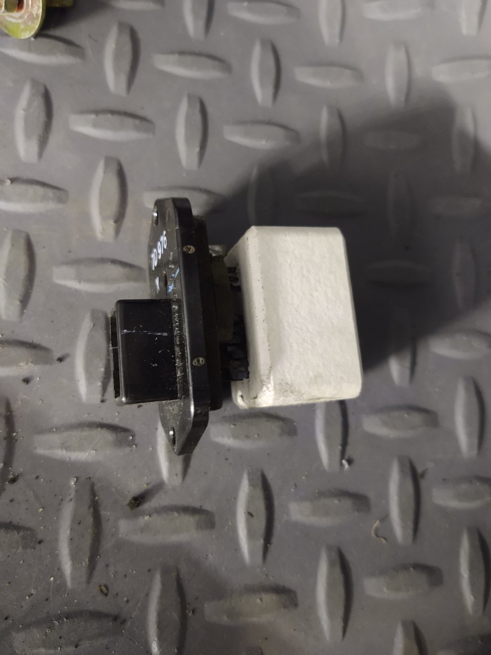

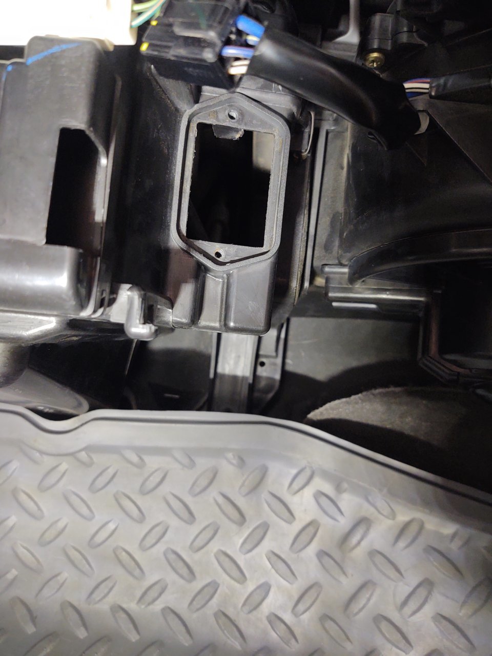

    Just completed this task. Was able to vacuum out some moldy needles.
    Curious if anyone can tell me what this white material is. Thought maybe some kind of moisture absorber.

    That is a ceramic material they use to encapsulate the resistors & fuse to protect it from the environment. It will take a hammer to break it open, but unless it is burned out, DON'T as it destroys it & you have to buy a new one!

    Ahhh. Makes sense. Thanks!

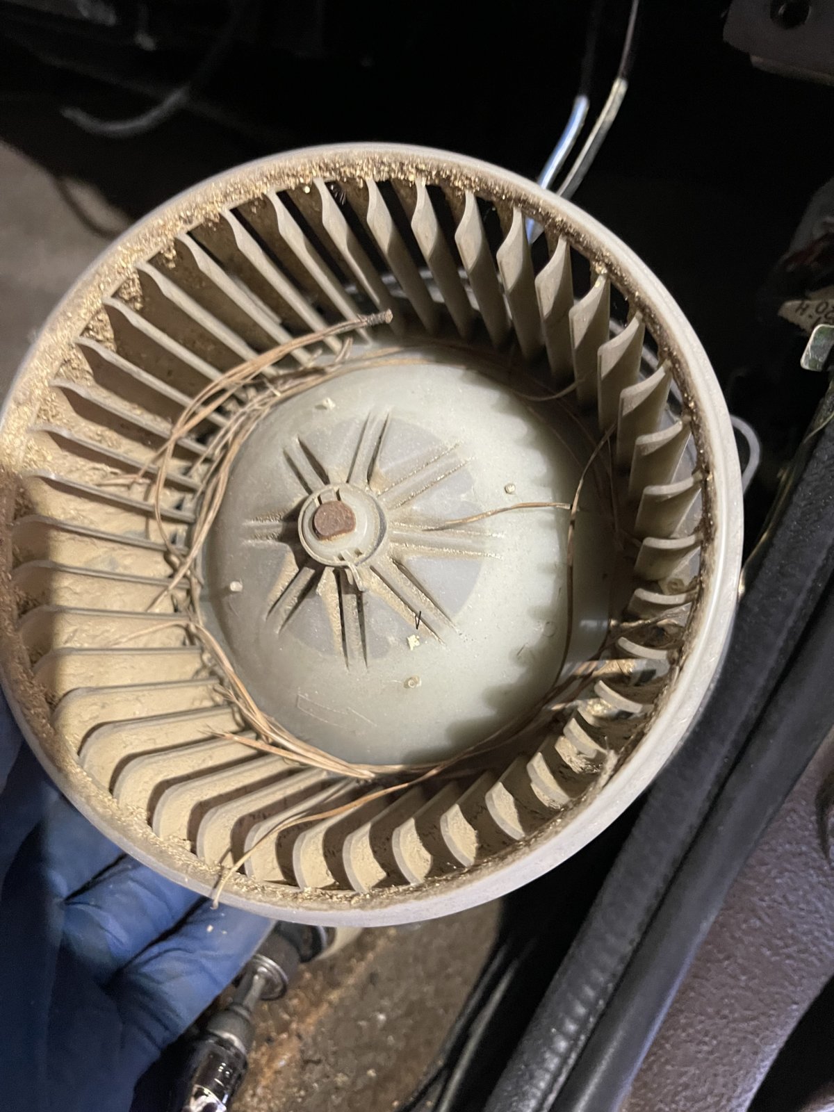

    took out the blower motor...it was full and been running all winter...so was looking where to start...found yours Oh man this is killer!!!! you da man

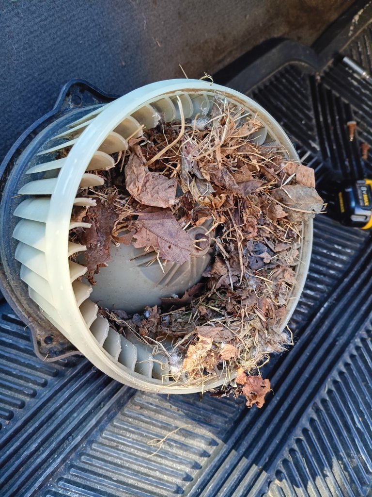

    Thanks for bumping this. Never realized it was that easy to split the box open. I've taken the fan out, was full of pine needles.

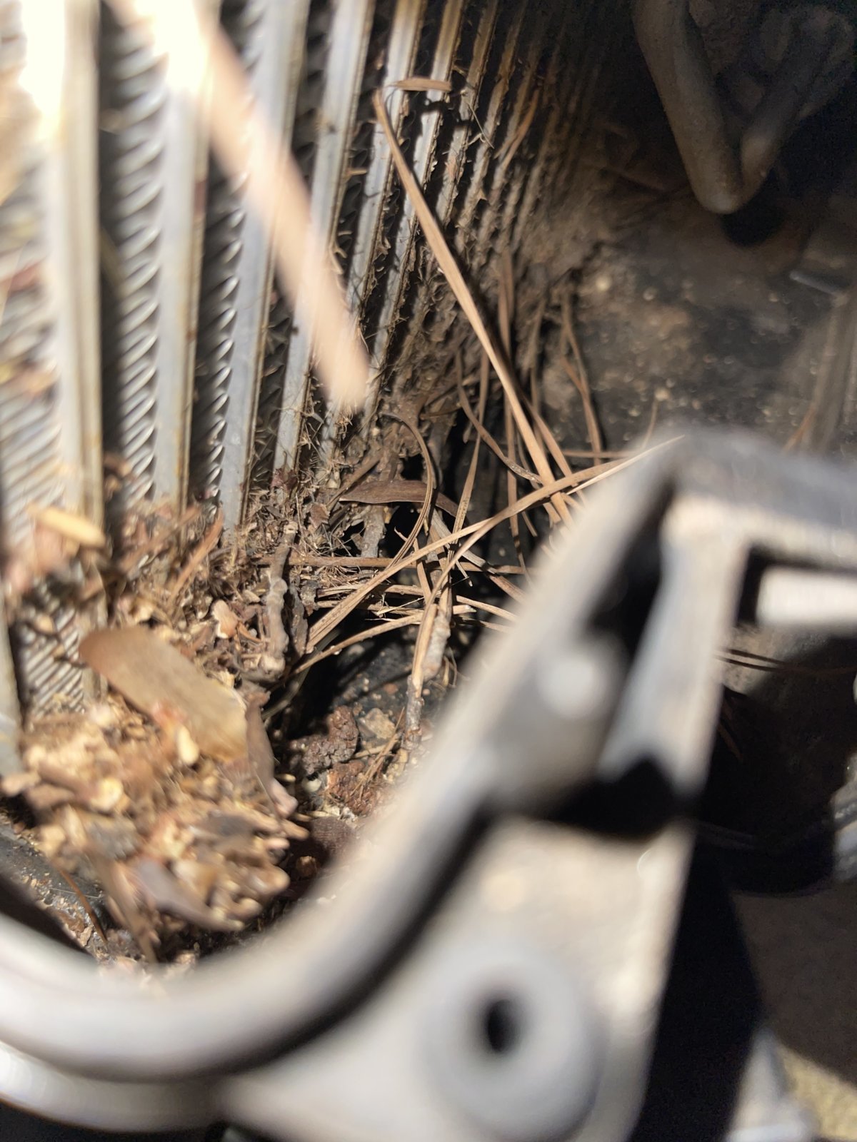

    Very good post! Decided to clean the evaporator today to get ready for A/C use and was initially pleased not to see much filth to be removed. Just as an afterthought, I decided to put the shopvac on the evaporator box drain hose inside the engine compartment to remove any dirt/debris in the hose. After putting suction on the drain hose, I also blew the drain line out back toward the evaporator. Glad I did because a large amount of debris was hiding inside the evaporator box down by the drain which required vacuuming/blowing out the inside of the evaporator box again. Had to repeat the process several times to get all the debris out. .02

    Great write up. Found 27 years worth of dirt and plant + a bonus rag with duct tape!
