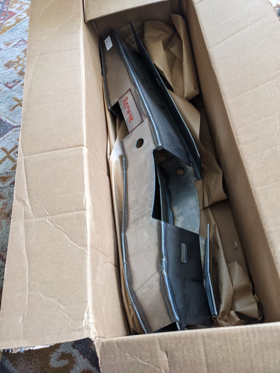

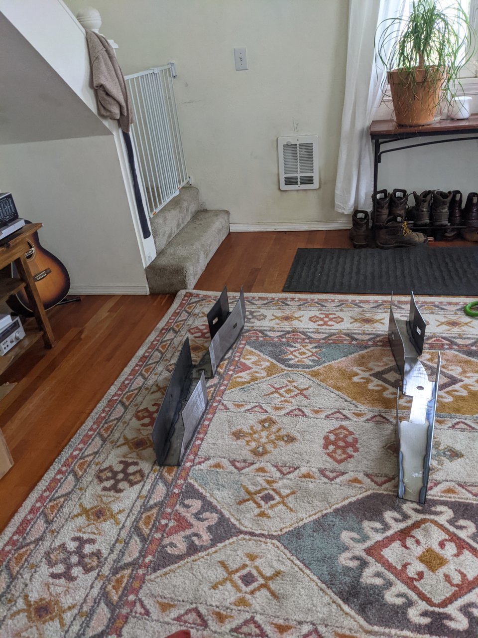

  5. Mar 23, 2021 at 9:13 PM
    #25
    dernuld
    dernuld Member
    Mar 12, 2021
    #359126
    12
    06 tacoma access cab 4wd V6
    They did have the front section in stock when I called and I ordered a pair for the front of my frame.. they are en route now

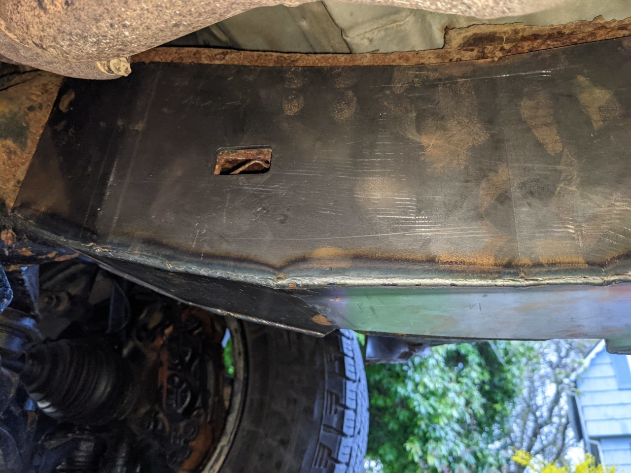

  16. Apr 3, 2021 at 9:31 PM
    #36
    Bruce988jl
    Bruce988jl Well-Known Member
    Oct 29, 2015
    #168035
    4,966
    Jason
    Southern NH
    08 Tacoma Dbl Cab TRD Off-Road & 05 Mitsubishi Evo
    Fitment for mine sucked... But I already cut up the frame so my fab guy made it work.
    The aft flat section was way too narrow from the manufacturer.
    Here's the finished product - some of the holes didn't line up so I had to drill or cut them out so I can mount the sliders back up.
    I will be reaching out to safe t cap to notify them of their tolerance issues and lack of fitment. I only used the passenger side piece for now.
