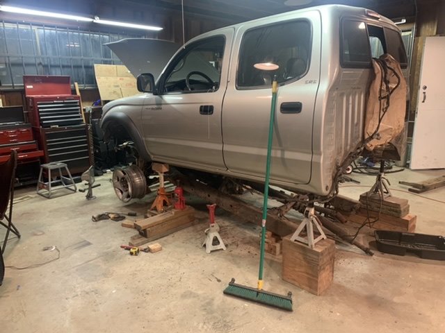

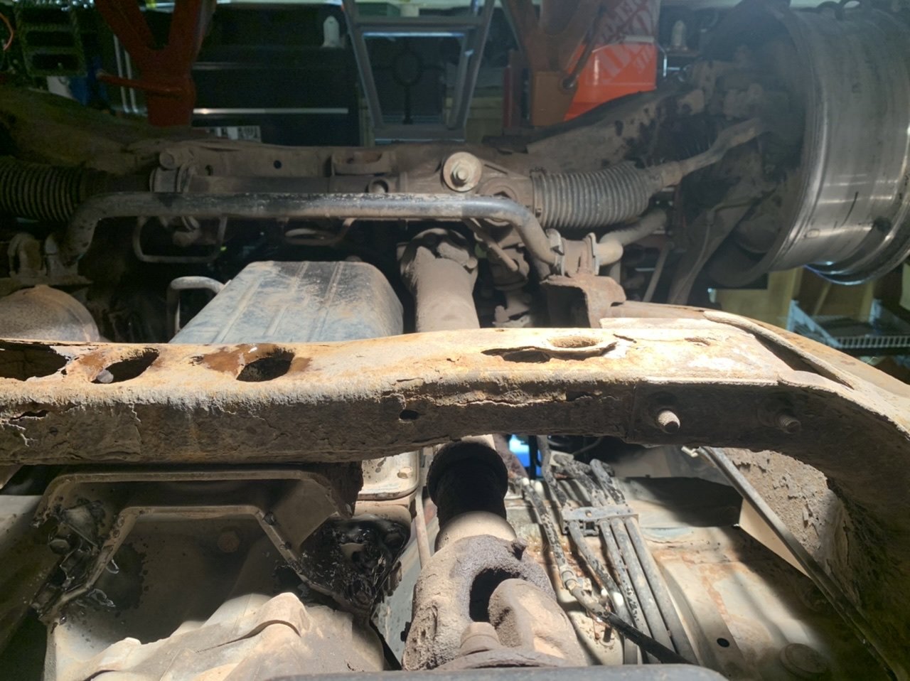

    jase
    Oregon
    2004 4x4 DC
    Rebuilt / frame swap at 200K
    Holy crossmember, idk why my pics are upside down

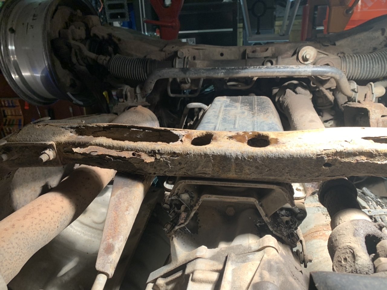

  4. Apr 23, 2021 at 12:13 PM
    #24
    Jase
    Jase [OP] Well-Known Member
    Mar 30, 2021
    #361044
    471
    jase
    Oregon
    2004 4x4 DC
    One more
    surfishjoe, JudoJohn and SwampYota like this.

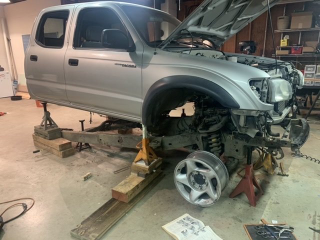

  10. Apr 25, 2021 at 9:08 PM
    #30
    Jase
    Mar 30, 2021
    #361044
    471
    jase
    Oregon
    2004 4x4 DC
    More progress

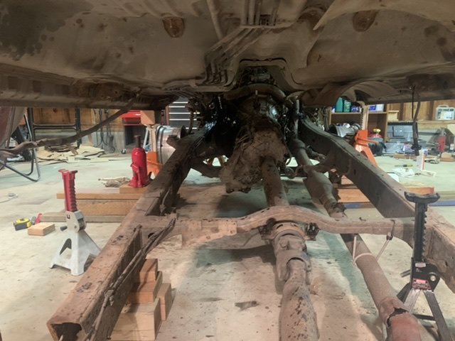

  12. Apr 25, 2021 at 9:10 PM
    #32
    Jase
    Mar 30, 2021
    #361044
    471
    jase
    Oregon
    2004 4x4 DC
    Underside

    12
    Very nice. I'm preparing to do the same on my 2002 double cab. Cab removal makes me nervous since I don't have a lift. Your method looks good. Would you say its going smoothly or is it a PITA? Im assuming you had to disconnect all the stuff like main wire harness, brake cylinder, heater, AC, etc just the same as if cab were taken off with a lift.
  15. Apr 26, 2021 at 12:10 PM
    #35
    Jase
    Mar 30, 2021
    #361044
    471
    jase
    Oregon
    2004 4x4 DC
    It’s going smoothly other than only about 1 in 3 bolts don’t either have their heads break off or need to be cut off, and I’ve had to cut my hard brake lines.
    The cab supports are currently in the way of rolling the chassis out, I’m trying to figure out what to use as cross beam support to widen them. 4x4 lumber? IDK.

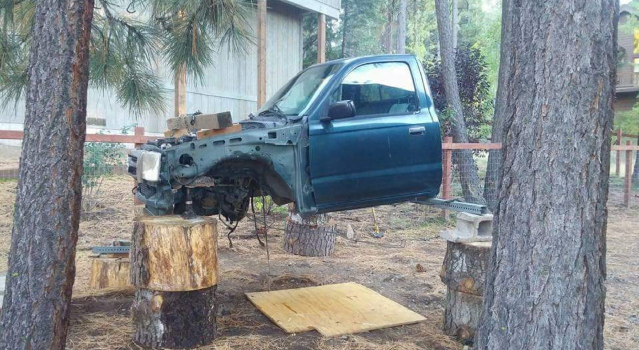

    When I did mine I used 3x3 steal beam spread way out on tree rounds. Make sure you have it high enough to get the front coil buckets out under the cab. Are you leaving the motor in the cab?
  19. Apr 26, 2021 at 12:17 PM
    #39
    Jase
