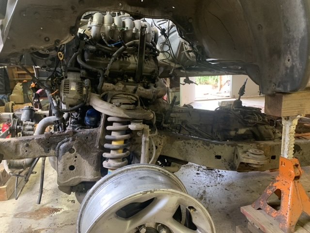

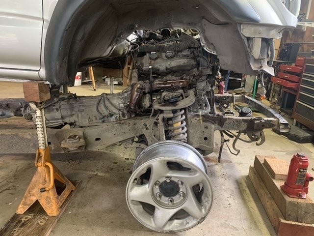

    Is there a reason you are doing that way? It is a lot less work to leave the motor in the cab.

    ? The motor is mounted to the frame ?
    I was going to set it next to the new one and just transfer everything

    Once the PS unit was out of the way I just ratchet strapped it to the radiator support.

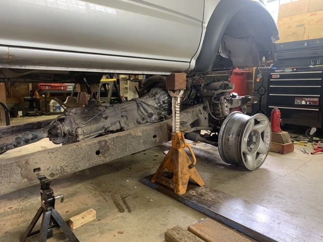

    Did you pull the trans and TC out from underneath before lifting off the cab+motor?

    No I did not

    If not for the rear main, would you have lifted the tranny and transfer case with the cab?

    Thanks, and yes. I think just throwing another heavy strap around the trans and can would have held it.

    Hey Jason. You can lift the entire cab with an engine hoist easy peazy. I built a simple wooden bracket that goes inside the cab.
