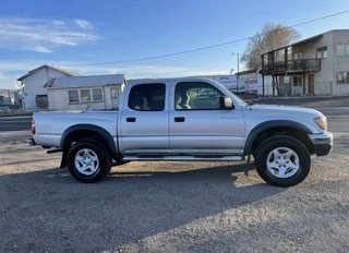

  4. May 5, 2021 at 7:39 PM
    #64
    Jase
    Jase [OP] Well-Known Member
    Mar 30, 2021
    #361044
    471
    jase
    Oregon
    2004 4x4 DC
    Rebuilt / frame swap at 200K

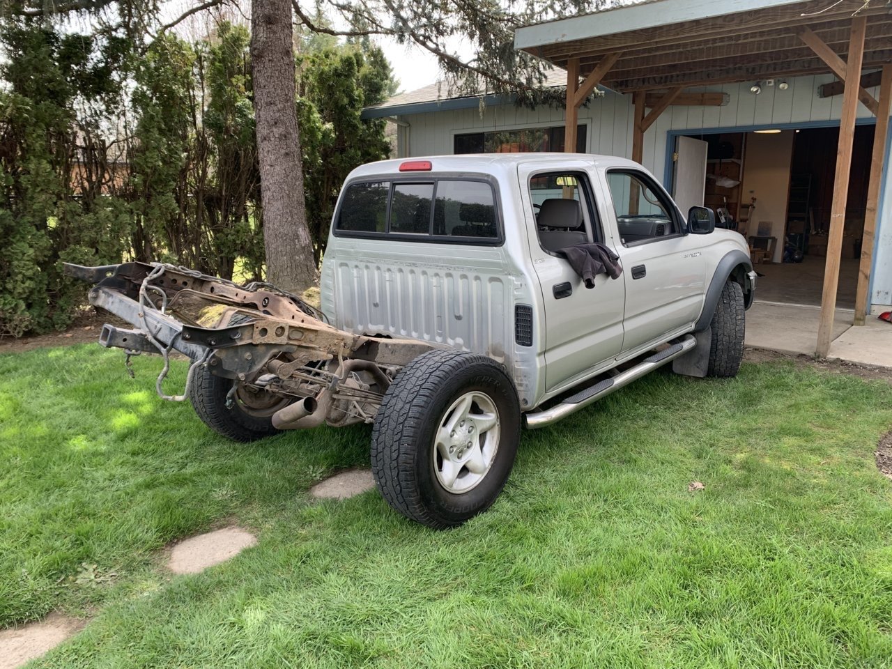

    This is right after I pulled the bed.
  5. May 5, 2021 at 7:43 PM
    #65
    Jase
    Mar 30, 2021
    #361044
    471
    jase
    Oregon
    2004 4x4 DC
    This is when I bought it, before I trailered it home

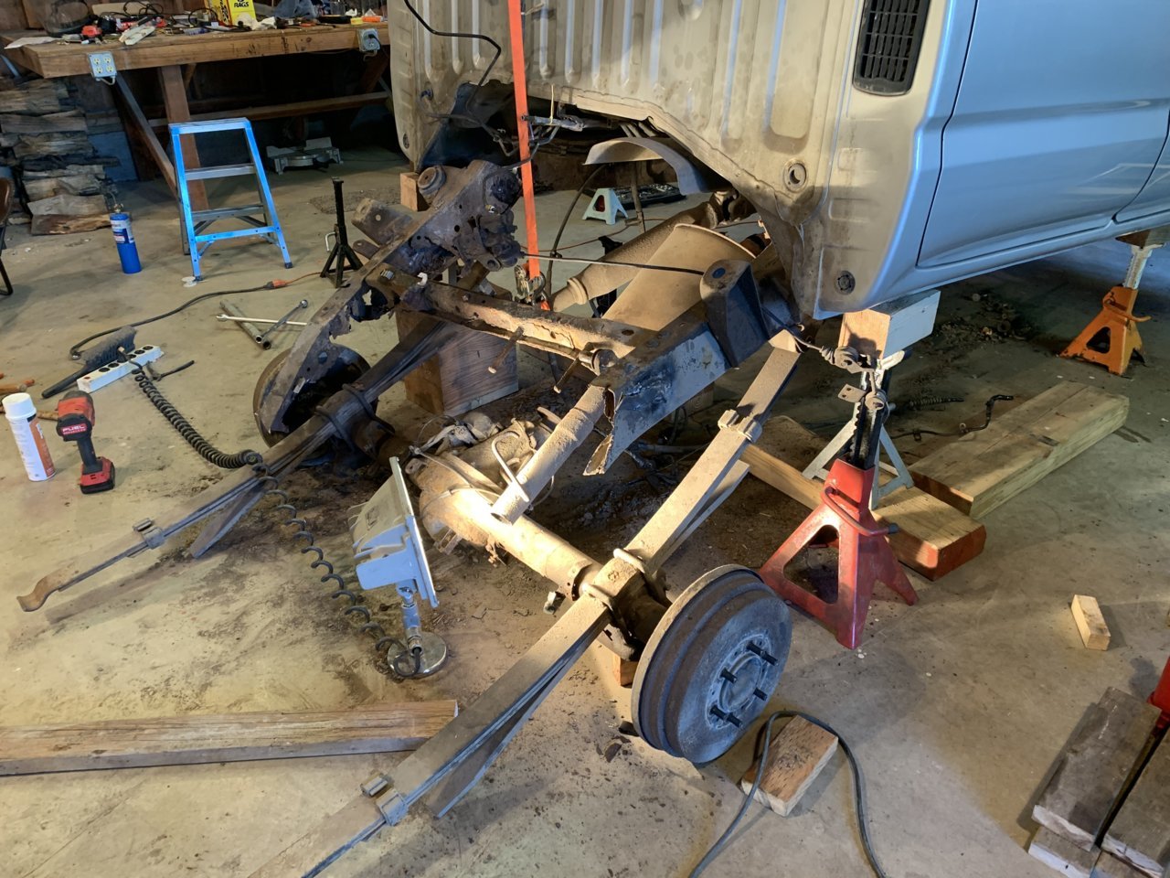

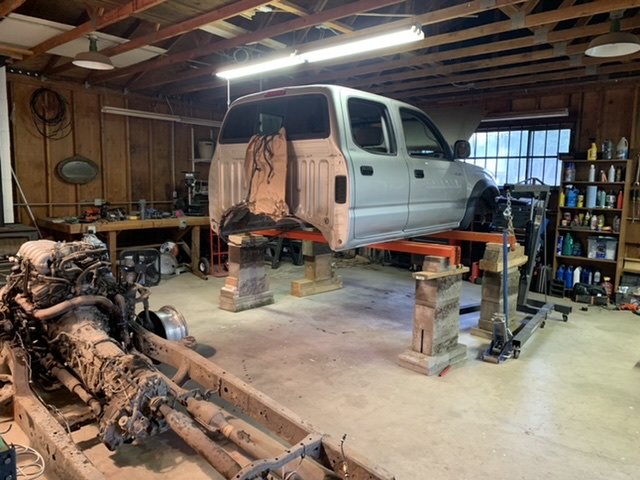

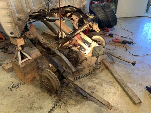

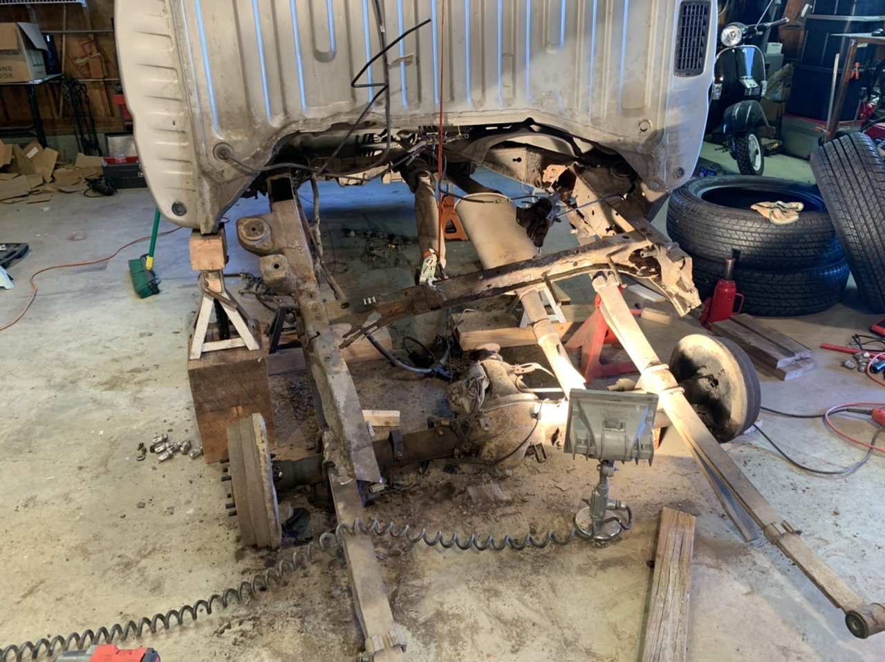

  9. May 8, 2021 at 8:05 PM
    #69
    Jase
    Mar 30, 2021
    #361044
    471
    jase
    Oregon
    2004 4x4 DC
    Productive day. I borrowed bars from the pallet racking at work. I used scrap lumber and dug up several concrete blocks around the shop. Used my engine crane/cherry picker to lift each corner and stack blocks until I was high enough.
    Note: this is unsafe and you should not do it this way.

  14. May 9, 2021 at 4:45 AM
    #74
    sykorabj
    sykorabj Member
    Sep 23, 2020
    #341735
    12
    Looking good. How high did you have to lift the cab to clear the engine and front suspension? Looks like you have tires off to get the frame lower.
  15. May 9, 2021 at 6:49 PM
    #75
    Jase
    Mar 30, 2021
    #361044
    471
    jase
    Oregon
    2004 4x4 DC
    I think I was between 46” & 48”

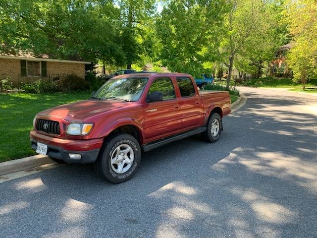

    You can have this one for 3k. 2002 taco 156k. All is well except for frame.

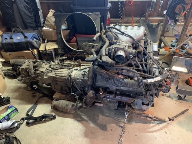

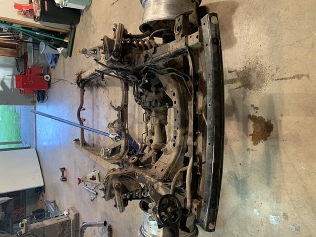

    Pulled the drivetrain out of the old chassis
    PzTank, Tour991, SwampYota and 2 others like this.

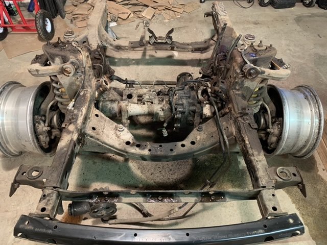

    Cleaned up a tiny bit

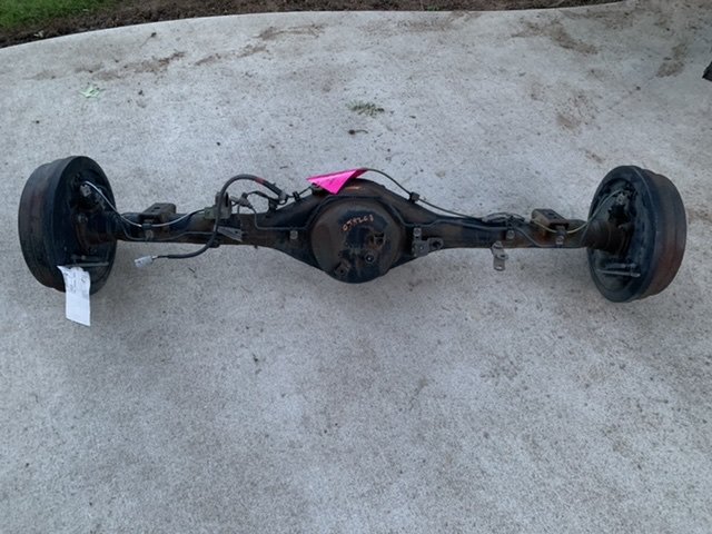

    E-locker rear was too far gone. I wanted to regear anyway so I bought an OEM 4x4 4cyl 4.56 rear axle assembly with 121,000 miles, and a low mileage front assembly with 4.56 for a total of $750. Fixing the old one was over $1300, and I think I’ll be happier with an Eaton LSD than a locking diff. So roughly the same price with an essentially free gear ratio change.
