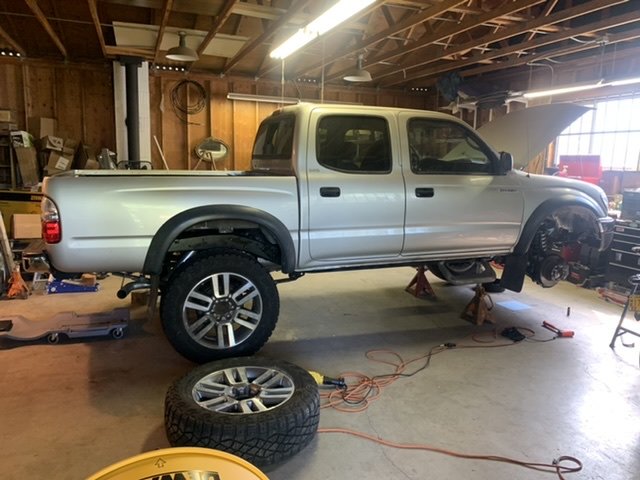

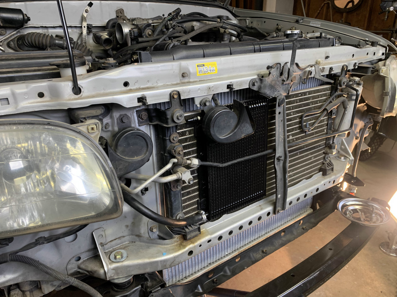

    Got it to fit, almost got my trans cooler installed.

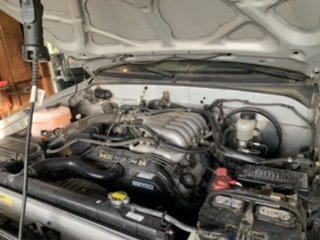

    Today I put in the evap can and the fuel tank, and let it idle for about 42 minutes. First time it’s run since last last April!

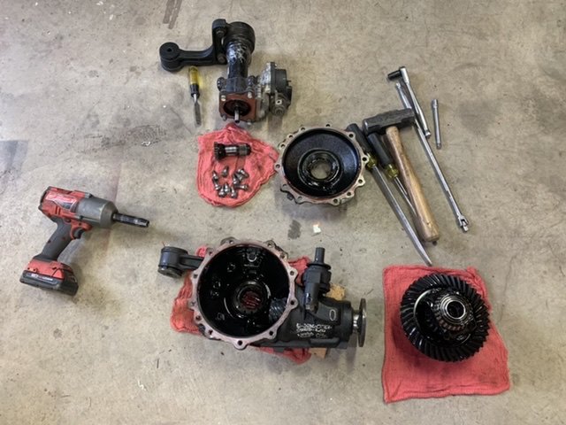

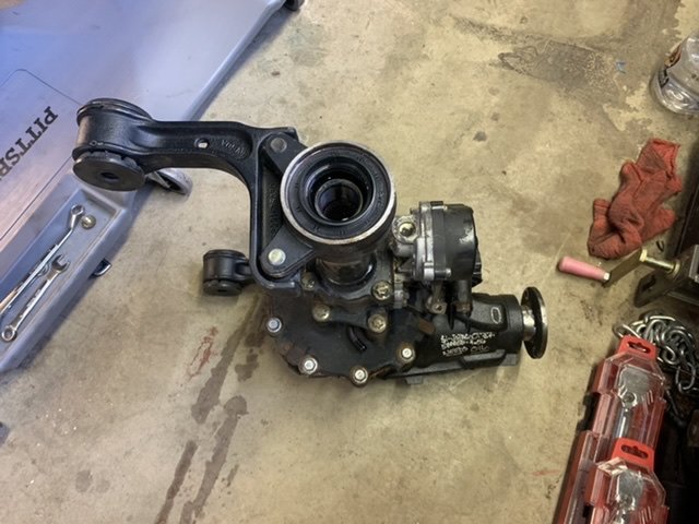

    Well I read in another thread that 4.56 fronts are unicorns, and apparently a lot of salvage yard diffs go by the door code, which is often wrong? I verified that my junkyard rear diff is 4.56 when I pulled it for the TrueTrac, so I put it on 4 jackstands and put it in 4LO with tape on the tires and the floor.
    They don’t turn at the same rate. :( (I also tried reverse, hoping I was wrong) :mad:
    So, looks like I’m pulling the front back out and splitting the case to count teeth.
    PzTank likes this.

    Wish I’d have checked before, but it was low mileage, marked 2003 - 4.56 with a paint pen, and I heard splitting the case is a PITA, so I just replaced the seals and the mounts.
    Was easy to install before I put the engine in, kinda dreading pulling it now.

    Front diff back out

    Tooth count: 41/9
    very interesting. I verified the rear differential gearing when I had it apart. Also 4.56.
    With all the wheels off the ground, in 4wd, chalk on sidewall and floor the wheels don’t turn at the same rate. Must be different under load, or maybe it’s because the front is open and the rear has a TrueTrac?
    I guess my next question is can I reassemble this and run it, or does the disassembly mess up bearing preload or backlash or something else I don’t understand?

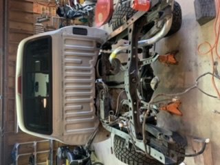

    Progress report

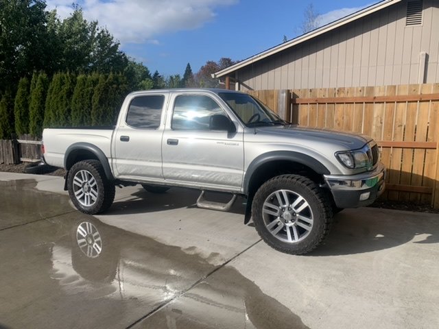

    Almost 16 months later, I drove it to the gas station. Got an alignment Friday then off to the DEQ for new tabs.
