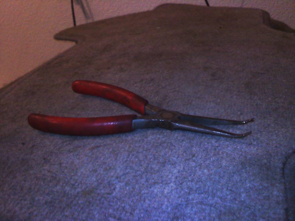

    Been postponing a pad change for a couple weeks... procrastination has been a problem so far this summer with the nice sunny days.
    But seriously are you kidding me?? Could toyota have made this any simpler? The only other brake jobs I've done previously had me taking the caliper off to get to the pads, and that's how this started... I kept grabbing the wrong size socket for the caliper bolts, then spent another 10 mins walking back and forth to the garage looking for a socket extension (and a drink... or two).
    Then I jumped in here, and stared in confusion at the first post, trying to figure out what was really going on. Then I grabbed the laptop and went out to the truck to look while I read.
    Then... the lightbulb turned on, and 10 mins later I was done. Seriously, there needs to be a photo in the first thread that shows a pair of these as the only tool needed (aside from those required to remove the tire):
