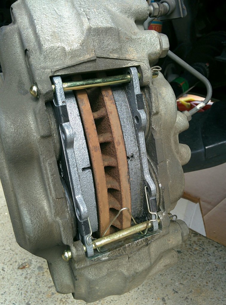

    Went to change my front pads and saw this situation below. Bought this truck and decided to check brakes. Pads need replacing however the brake pad pins are seized and won't move. I'm going to buy new callipers, already have the brake pads. Would you recommend changing the rotors while I'm at it? Or is it in ok shape? The other side is in the same condition as the left side(pictures below).
    Thanks
  10. Jun 8, 2015 at 3:31 AM
    #250
    RBK51
    RBK51 Member
    Feb 6, 2014
    #122401
    18
    Mark
    Barrie, ON. Canada
    10 Tacoma TRD Sport DC LB
    Tint, wetokole covers, weather tech mats, kenwood DNX570HD Stereo, db DRIVE S7 6 C 250 watt 6.5 component loud speakers front doors, db DRIVE S5 60 v2 350 watt 6.5 2 way rear door speakers, db DRIVE A7M 100.4 800 watt 4 channel stereo AMP under rear seat, tri fold soft tonneau cover, auto starter, Bilstien 5100's all around front @1.75, Spidertrax 1.25" spacers front and rear, K&N air filter.
    I would replace them. You are in there anyway putting fresh pads on. Look at at Msport rotors. They are a bit more in price but worth every penny. It's one thing I wouldn't cheap out on. It's stopping your truck.

    If you have a micrometer and know the spec, you can check to confirm if a new rotor is needed. But you have a lot of rust inside the rotor so I would second the motion to replace.

    Mike,
    You might consider painting the new calipers. I had a Dodge Ram that had the calipers flaking apart as in your picture;
    I blamed it on the road salt. Shortly after I bought the Tacoma, I brush painted them, then re-sprayed them last year during my pad change; they are still in good condition after 7 years.
