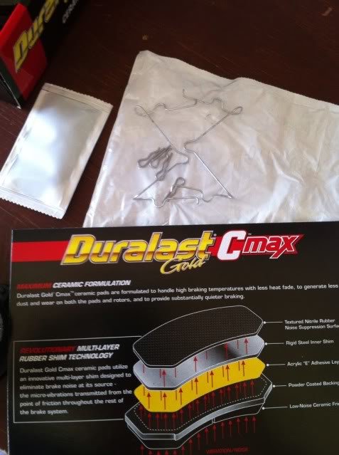

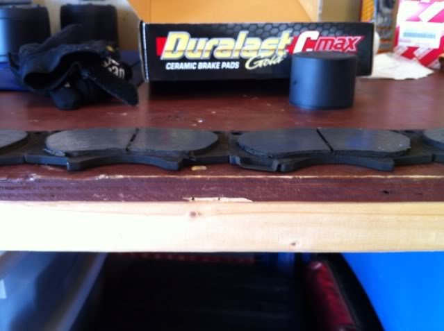

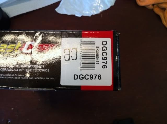

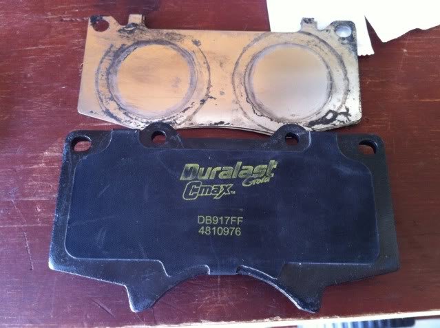

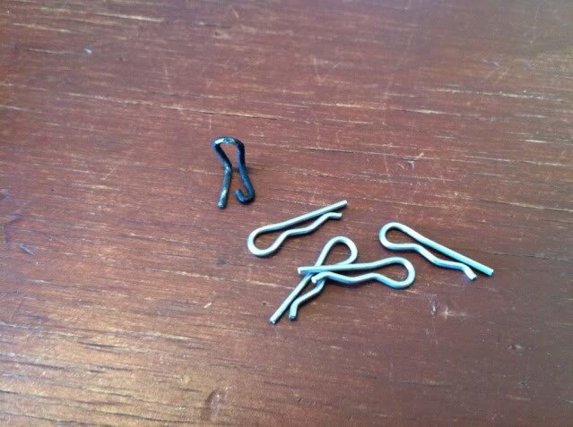

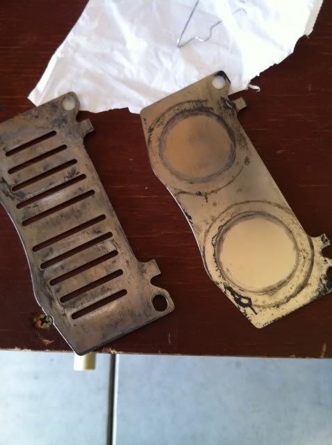

    Changed out my pads today using the same Duralast Gold Cmax pads as the OP.
    A couple quick observations:
    * The Duralast pads come with shims that are pretty much permanently attached to the pads so there is no need for the OEM shims.
    * The pads come with clips and "anti-rattle springs" (what the Haynes Manual Calls them) as the OP mentioned but I reused the OEM clips because they are a different design to the Duralast supplied clips. I thought they OEM clips are a better design and less likely to fall out.
    * I have a Haynes Automotive Repair book that I referenced when changing out the pads and it recommends to remove 2/3 of the brake fluid prior to changing out the pads. I did this by using a "medicine dropper" and placing into a empty water bottle so I could reuse the fluid when done.
    A few misc pics...
    Supplied grease, clips and anti-rattle springs
    Clips comparison (OEM clips the black one)
    OEM shims compared to the Duralast shims. I was a little confused on which to use but found the Duralast shims are pretty much permanent.
    OEM Shims (2 pieces), not sure why?
    OEM pads are toast!
    Part # for Durlast Gold Cmax pads.
