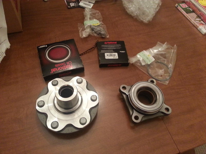

    Hey guys My bearings in my front left side have gone. I've Watched the video probably a dozen times but I am still left with a couple of questions.
    Since I'm doing essentially what this guy did here:
    http://www.tacomaworld.com/forum/2nd-gen-tacomas/240545-front-wheel-bearing-change.html
    and replacing the bearing module and the hub assembly so that I have a spare.
    Now I must say my knowledge of mechanical parts isn't the greatest. (I'm a complete newb) and I just want to start learning about this and being able to take care of my own Truck and do some of the easier jobs myself. (you know, screw paying someone $60 an hour to change my oil or breaks)
    So Here is the attached picutre of all the parts.
    Some of my questions are:
    1.) Do I have to press the OEM hub assembly into the Bearing module assembly? There is a brown teflon? ring inside the bearing module that kind of blocks the Oem assembly into the unit nicely does this come out?
    2.) Will I require any grease for the reassembly part? C.tire mechanics told me that there is no need to press anything together. THis is just a double check with what he said since its hard to take the word of a mechanic who has clean hands :D
    Thanks for your time.

    Yes you will need to press the new hub onto the bearing. That ring inside the bearing is to just hold the bearings in that unit so they don't fall out I believe. I'm sure someone will correct me if I am wrong. As far as greasing goes. When I've done mine before I have pulled the ring out of the bearing and pulled those bearings out of that unit and greased them or atleast one of them I can't remember but you shouldn't have to do that. I think I did it as an extra step cause I got tired of changing it and wanted to do something different.

    Correct, ring is just holding bearings in place. Be sure to apply some grease to the hub portion that presses in the bearing, it will make it easier for next time.
    And I coulda saved you a bunch of coin on that pretty hub...and had the bearing on it already, lol. Good luck.

    I'm not exactly sure what you mean here and it's one of the parts that i'm sort of confused on. Does the grease go into /around the inner circle on the bearing module? or do you mean around the shaft of the hub assembly (the part that sticks up?)
    Since i've never done this before or anything really remotely mechanical. It may start to make much more sense once i get the hands on time with it.

    Shaft of hub assembly, so next time it presses apart easier.
