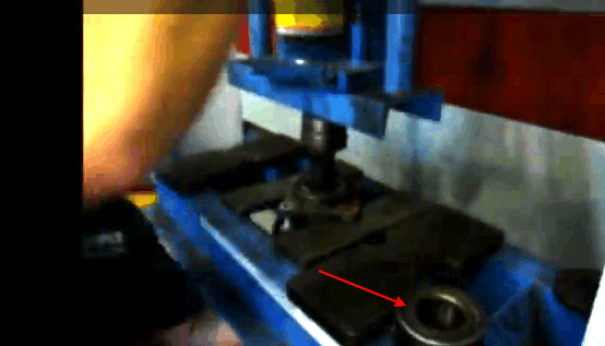

    at 2:27, there's a round part that is sitting on the blue press table, while you're pressing out the hub from the bearing... does that have anything to do with what we're doing here? And what is that pipe and stack of rings that is pressing the hub out of the bearing? is that just for convenience so you can keep the press high so you can see what you're doing?

    regarding 2:27. this is what I'm talking about. what is that? thx again

    Use the press, that'd be a total PITA.

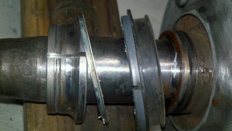

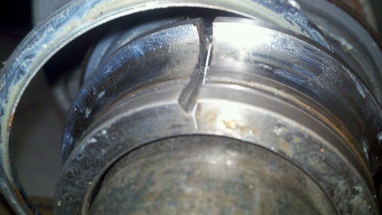

    Basically a brass punch or brass bar, soft so it won't damage the metal lip, you definitely don't want to damage the (nitrile) seal part though.
    As far as cutting off the inner race you'll need to make a diagonal cut on the bearing race that doesn't come off the hub with the rest of the bearing. Just notch it, don't cut into the hub, and then take a chisel and hammer on it. It'll crack and you can slide it off.
    I can't find any pictures of front bearings but here is from my rear bearing. Basically the same thing. You just have to change the angle of the cut.
