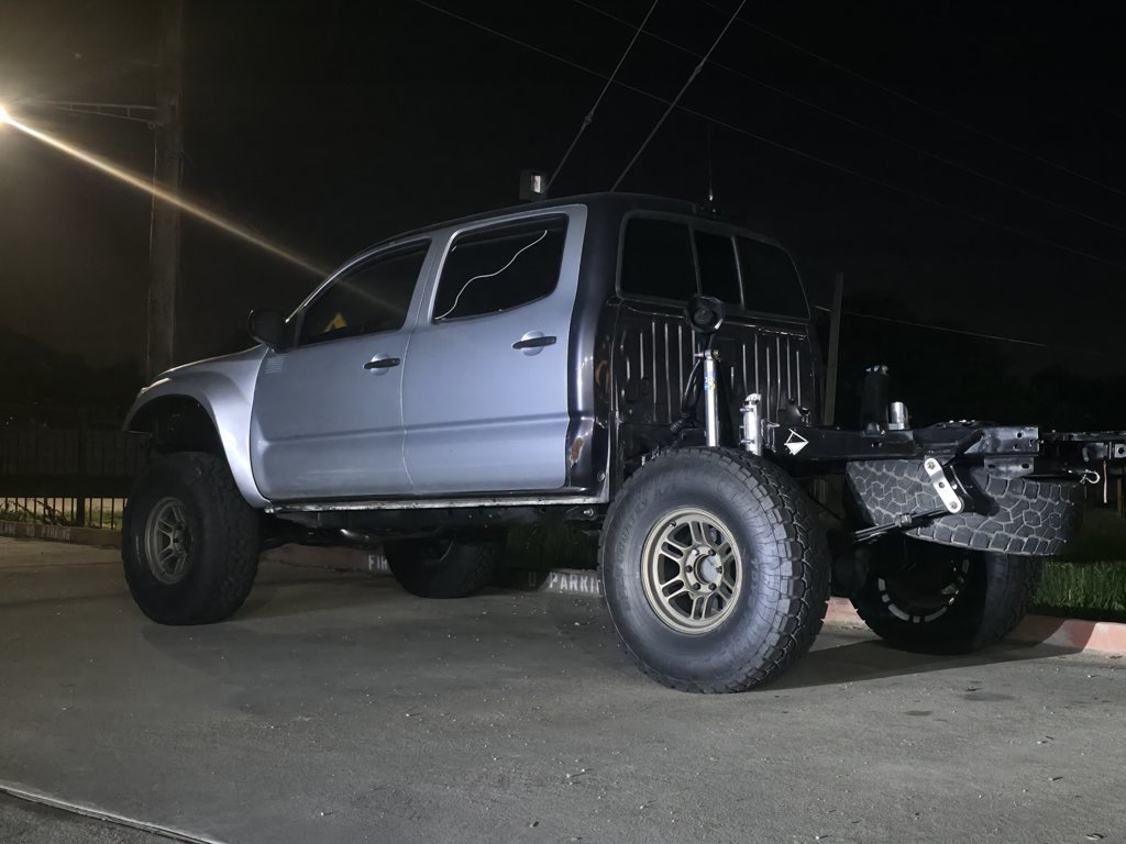

  14. Jun 15, 2025 at 11:32 PM
    #34
    Stubert90
    Stubert90 Well-Known Member
    Jan 23, 2025
    #464651
    78
    First Tacoma - 2007 Dual Cab Pre-Runner 6ft
    Anyone got any suggestions for a fuel hose?
    I have just discovered this issue..
  15. Jun 15, 2025 at 11:56 PM
    #35
    will.i.was
    will.i.was Well-Known Member
    May 6, 2018
    #252688
    1,705
    Will
    Houston, Texas
    SC 2.5
    Amazon has a few qualit
    Go to oreillys and get a length of gates fuel rated hose. I actually got this oem filler awhile back, crazy to hear its discontinued
    Its currently just zip tied as I spent dozens of hours getting the fuel door just right and trimming the oem filler enclosure to fit.. its still eh.. I like the rubber seal in the original post. I tried to find this thread for a long time now to reference the part number.20250614_215123.jpg
    Stubert90[QUOTED] and Taco2525 like this.

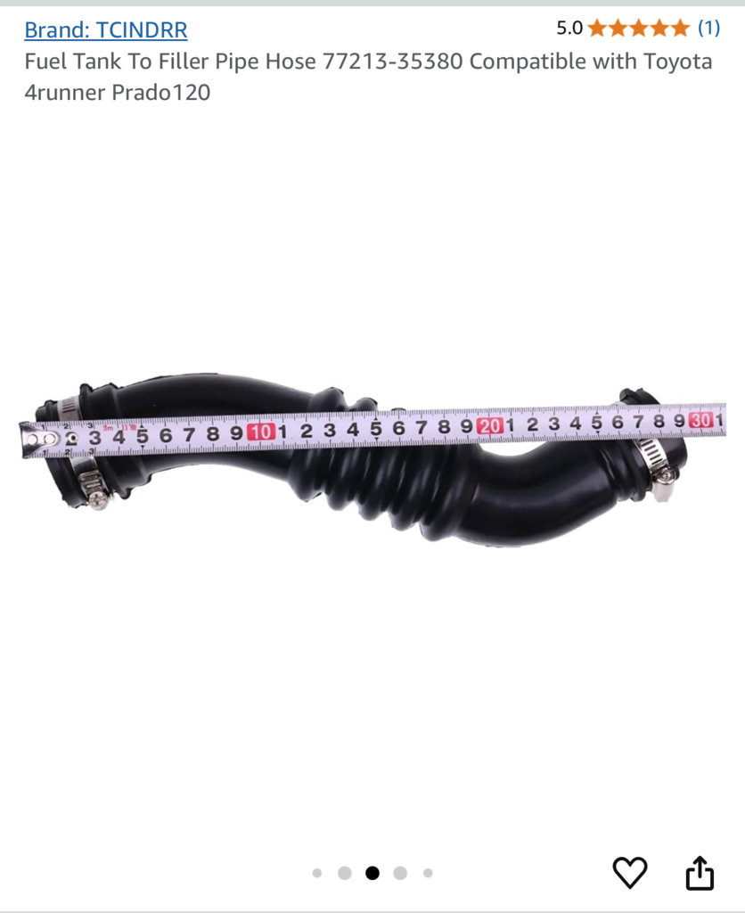

  17. Jun 17, 2025 at 12:01 AM
    #37
    Stubert90
    Jan 23, 2025
    #464651
    78
    Alright,
    Got a 1 inch diameter fuel hose from oreilys, no luck fusing it sufficiently to the pre exisiting outlet. Tried using hose clamps, the 1 inch hose is fine for the fuel tank end, but I can’t compress it down enough for the filler neck end.
    any suggestions?
  18. Jun 17, 2025 at 12:37 AM
    #38
    Stubert90
    Jan 23, 2025
    #464651
    78
    Caved and ordered one of these,
    going to see if I can make it work.

  20. Jun 22, 2025 at 7:52 PM
    #40
    Stubert90
    Jan 23, 2025
    #464651
    78
    Got mine done,
    The part identified is no longer available. So I got a close enough replacement and Jerry rigged it with the stock hose.
    No leaks or codes so i guess success!
    TRD10 and Slashaar like this.
