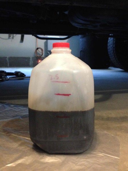

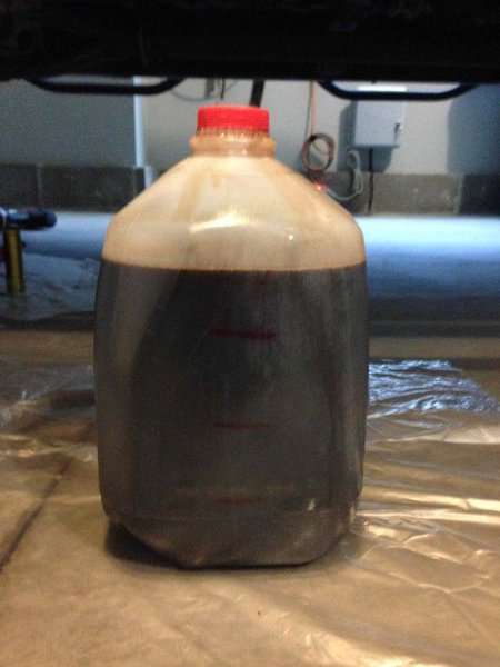

    My initial drain from the plug got me just about 2.2 quarts. After dropping the pan and removing the filter I got a littler over another quart for a total of 3.5 quarts. Having the valve body removed for a week waiting for it to be shipped back netted another quart. I'm not sure if the fluid from removing the filter would have eventually drained out or not as I proceeded with removal of the pan once it was slowly dripping.
    The pics of the jug was the with the drain plug removed, and then after removing the pan and filter.
    In any case, you flushed out the tranny with that amount of fluid. My truck took about 30 min at 50F in the garage coming up to temp using the wire to jump pins 4 and 13.
