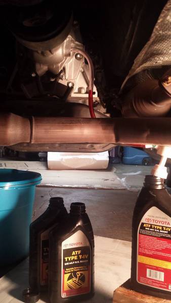

    Just drained and flushed my '09 with 119,000 miles on it using Mountain Lion and Fortech's guide. Thank you for creating these guides for us mechanical FNGs.
    Everything pretty much went off without a hitch by carefully following their instructions. Took me approximately 3 hours to complete. I used Toyota WS Type IV ATF fluid ($79.15/12qt; $6.60/qt; http://amzn.com/B00EV5A5NC ). I bought a couple extra quarts from the dealership just in case. The pump I bought from Autozone for 6 bucks. It's slow (~100 pumps per quart) but it didn't break.
    I drained and filled the pan, draining ~3 quarts. I drained and flushed twice, each time flushing ~2.75-3 quarts for a total of 12 quarts. I pumped in an extra 1/3 quart to top it off. Once I brought the transmission to temp, I ended up having to pump in another 1/6 quart to get the fluid coming out of the overflow.

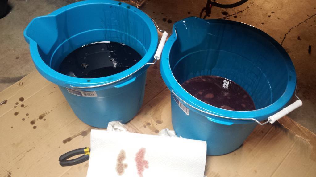

    You can see the comparison of the old fluid, the left bucket after the first flush, and the right bucket after the second:
    The old fluid was black like motor oil. I definitely should have done the drain and before 100,000 miles (almost all city/highway driving, no towing). My truck shifts so smoothly now, I think better than when it was new :D

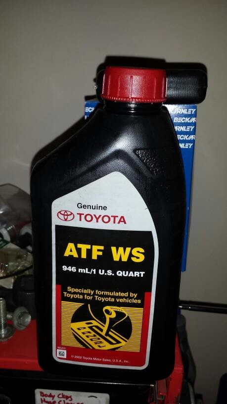

    I believe you used the wrong fluid... Toyota WS Type IV ATF fluid doesn't exist. its either WS or Type IV...

    Yes he did. This is the ws fluid.

    Damnit!
    Type T-IV should be fine, right? Just a shorter maintenance cycle?

    It's not like you added gas or motor oil, so in that respect you're OK. The friction modifiers, viscosity, or other additives may not be what our trannys need though. Unless you get a more definitive answer stating it's not going to do any harm, I wouldn't wait a long time to replace it.

    Re-did the drain and flush with the correct WS ATF fluid. I doubt any permanent damage was done, but just in case, I performed step 6 an additional time to remove any leftover type iv fluid.
