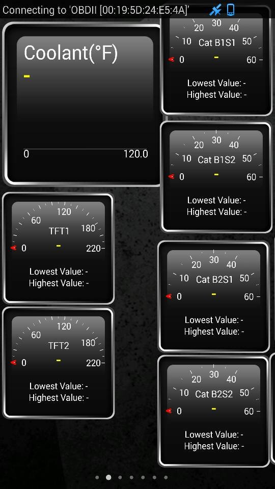

    Toyota's scheduled maintenance gives a basic outline of Transmission fluid inspection interval, based on daily driving and towing. It's your truck do as you wish, not as dealers tell you. As you have found out they contradict themselves.
    There's a thread somewhere around for the scan gauge or ultra gauge Trans temps. Search and ye shall receive (I'm on my phone). I used a similar method with the Torque app.

    "it's a Bingo", I'd change it. Sorry I'm not much help with the scan tool codes. I've got two readings and the usually don't differ much, only when driving/hauling.

    Why bother with the scanguage?... 6" of #16 wire between the 2 contacts and you've got it man... Don't cost nothing..
