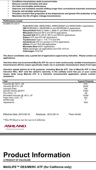

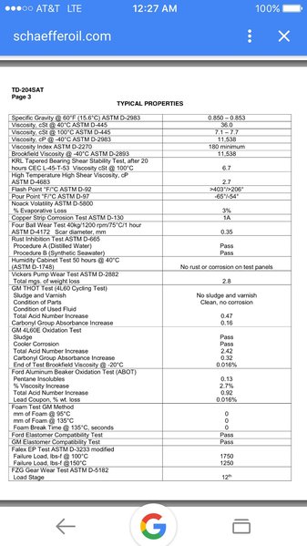

    I've also noticed that on Schaeffer's #204SAT All-Trans Supreme® automatic transmission fluid which says it can work on both Type-IV and WS. Wonder what the quantitative differences between the two are. It would be nice to have one ATF I can use for both power steering and automatic transmissions.

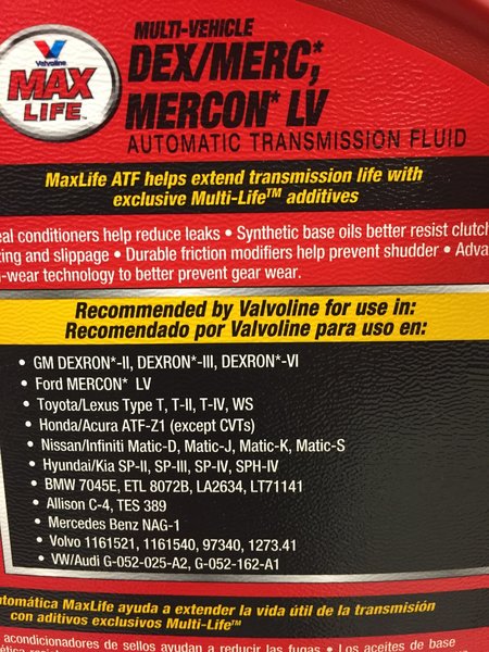

    For whatever it's worth, I'm using Valvoline Maxlife Dex/Merc in my 07 and my brothers 10 Tacoma power steering with no issues.

    It looks like to me that the Schaeffers is actually a better replacement(closer in specs to type IV) based upon viscosity and Brookfield viscosity than Maxlife is. (If you're needing an ATF for T-IV I would go with schaeffer's, for WS I would choose the Maxlife.) It's a Dexron replacement as well so it should work great in your power steering system as well. The lower the Brookfield viscosity, the easier it flows.
    WS has a viscosity at 100°C of 5.4, I forgot to pull up the WS specs.
