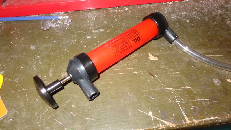

    Thank you everyone who posted here, it was a straight forward service because of all the excellent information. This was the 3rd oil change for this trans, at 100K, so the oil was clean and not broken down. 1st 2 done at dealership, I used the Valvoline Max Life this time. What I did notice was an improvement in the smoothness of the transmission. It was working fine, no known problems, and I thought I was having the placebo effect. No way, it runs better, period. I used a pump I got at Walmart, $13, it works great, comes with hose adapters etc, but the best thing is 3/8" clear hose fits it perfectly , is much sturdier than what comes with it and you can see the oil flow.
    I really appreciate the help on this site.
