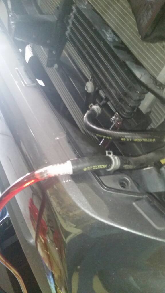

    I just got done doing the flush. I bought 3 gal of Max Life ATF at Walmart. Used the drill pump method to fill and drained from the front at the cooler. I do a fair bit of towing, 4 wheeling and mtn driving so I work the tranny. My truck has just under 55k mi. Honestly the fluid wasn't bad so I can understand Toyotas logic that it can go 100k if your not too hard on it. I also changed the motor oil and air filter plus topped off other fluids. All that in about 2 hours or so taking my time. note if you use the drill pump you need 1/2" id clear tubing but you need to reduce it to 1/4" to get it into the fill hole. Luckily I got a 1/2 the 1/4 coupler and 1/4 tubing at the same time at home depot. The pump worked beautifully. So I'll be using it to do my wife's Acura MDX soon. First time doing a trans flush btw. no sweat thanks to this thread.

    I did the same as well. What a freaking mess. I drained the pan 1st, then filled 3qts using pump, then let the truck drain 3, put 3 in, etc. Everything from the one cooler line disconnect. Warmed truck up and using the ultragauge, 110 and was a little low 1st attempt. Added 3/4 qt (all I had left). warmed her up again, checked level and some came out, success!!!!
    My pump had a 3/4" in-out, downed that to 3/8" line then clamped the crap out of it at the cooler. Used 1/2" line for the output from truck.

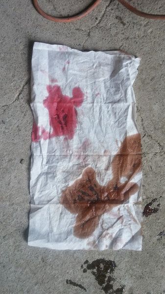

    Here's what my fluid looked like with 97k on it versus the new WS fluid:

    I followed his procedure here....
    DIY: Full Flush for Automatic Transmission
    Except I used these lines here....
    Truck pumped out the old fluid and the drill pump pumped in the new fluid. No need to do 3 qts at a time, since the drill pump can keep up with the out put
