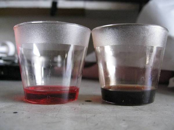

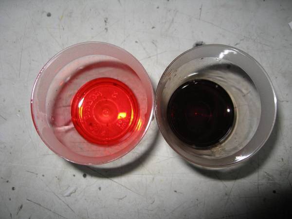

    The same argument could be made for changing the oil (you mess up, you pay for it).
    With any procedure there is risk. But this is basic fluid change, not rocket science. And when we do our maintenance we have the peace of mind knowing it was done correctly.
    Perhaps your right. But look at Krookz tranny fluid at ~65,000 miles!
    That is a terrific idea! :thumbsup: Practice getting the truck into temp check mode. Thank you for that! :)

    Got mine changed at the dealer some time back. I think it cost me $260 or something like that. They did the full flush -- on the receipt it listed 16qts. Tech said they flush a few extra through.
    As far as the interval is concerned. IMO changing it every 60k is a good idea. If you do any towing or any other activity like crawling over rocks in D you run the risk of hitting high temps. Any oil synth or not will get destroyed if it is over heated for enough time whether it's at 2000 miles or 60k miles. Be sure you know how not to increase your chances of over heating the oil and you'll be fine.
    I say this because I replaced my oil on a Z71 after 23 k and it was as dark as used motor oil. I had been 4wheeling and did it all in D. It being my first auto I did not know how to properly use 4x4 with an auto. Luckly I am Anal about maintenance and I did a flush at 23k. And yes color does not indicate the condition of the oil but the smell was unmistakable.

    Oh man, I know what ya mean. My T100 just absolutely fried atf and the stuff smelled and looked like rotten brown gravy when you drained it, by the synthetic lasted soooooo much longer and no slipping or AT heat idiot line coming on. My trucks do a little lite off-roading, but my T100 hauls heaping loads of firewood throughout the winter so some pretty tuff duty there.
