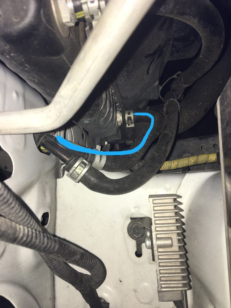

    I just popped the hood to look at the six cooler. I see the two lines that feed the cooler and started to follow them as they go through the wall back into the engine compartment. One of those two lines goes into the side of the radiator. Why would a line carrying gear oil run into the radiator?

    So the line i marked in blue comes straight out of the aux cooler (out in front of the radiator) and runs into the radiator. Why is this?

    The primary cooler is in the radiator and must be connected to the auxiliary cooler.

    That line runs fluid OUT from the bottom of the radiator, into the aux cooler, just so you know. The aux cooler then returns the ATF back in to the transmission pan (you use this line to put fluid back in). If you're directly facing the cooler with the grill off, the return line hose is either at the top (2005-2011) or the left (2012-2015). To flush, disconnect that hose and run some clear vinyl tubing from the cooler outlet to where ever you're flushing it to, like a bucket, then run a line from where you're pumping the new fluid to the return hose.
