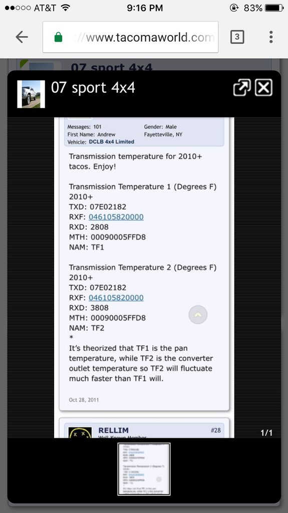

    That's a great question. I'm not sure if the TFT (Transmission Fuel Temperature) on my Scangauge X shows the pan temp or the torque converter temp. I used the programmable codes made available by Scanguage. I'll have to verify and confirm. Thanks!
    Scangauge's X-Gauge shows two options for tranny temp:
    https://www.scangauge.com/xgauge/toyota-lexus-scion-cansf-transmission-temperature-2010/
    https://www.scangauge.com/xgauge/toyota-lexus-scion-cansf-transmission-temperature-2010-alt/
    Not sure yet if they're for different locations in the transmission (ie. pan vs torque converter).
    I was planning on using my Scangauge to to get into temp check mode as well.

    These are the codes for the scangauge, I used these to derive the codes for @JD'STaco ultragauge. As far as I know the codes we came up with are working perfectly.
    Captain Nemo[QUOTED] likes this.

    I just tried this. They both worked. Thank you!

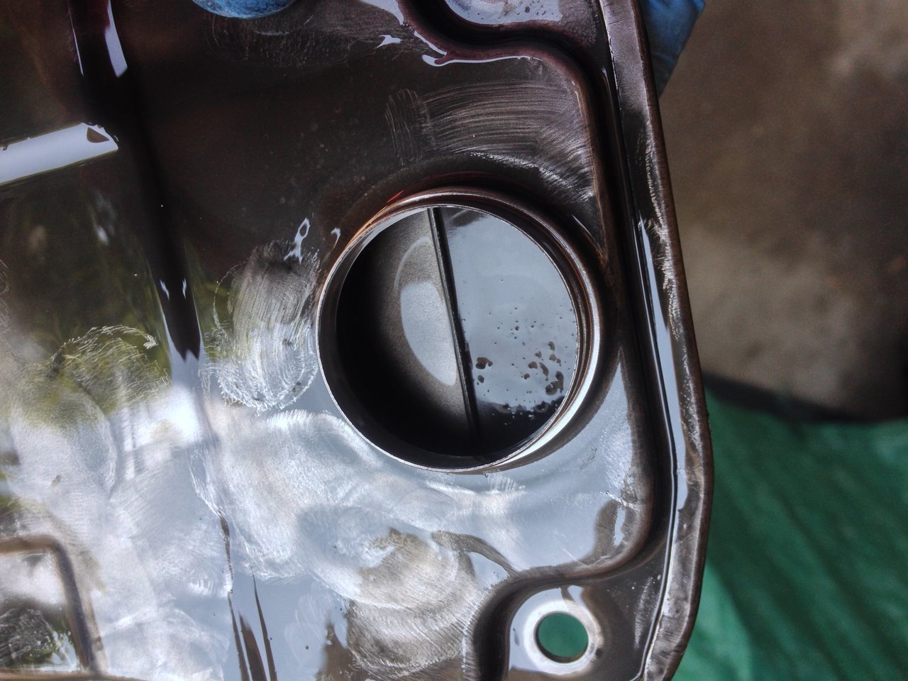

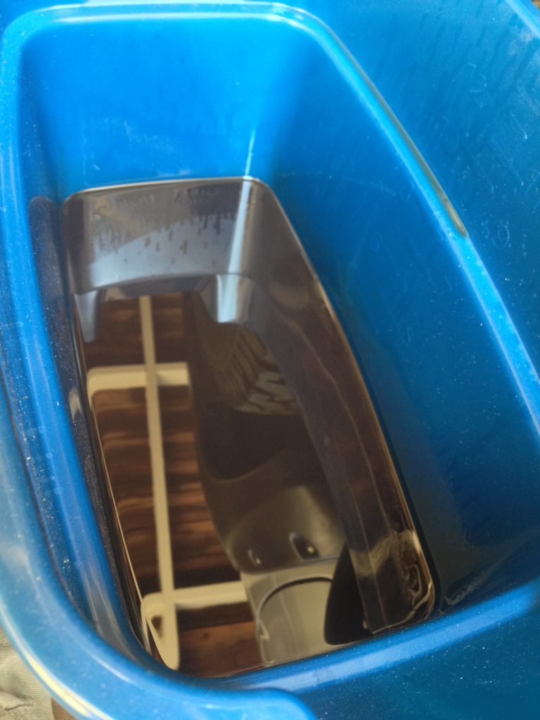

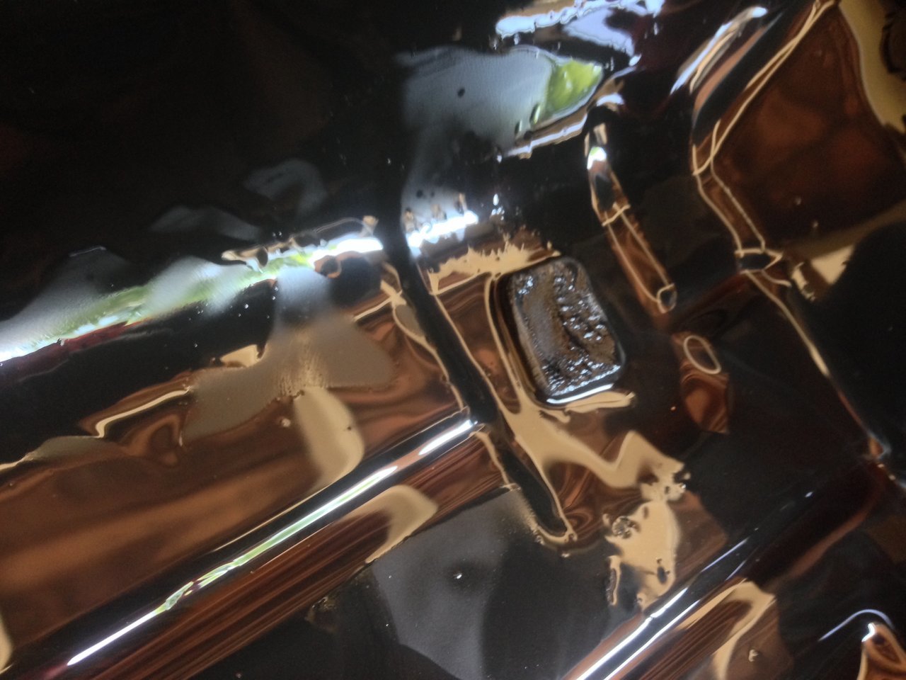

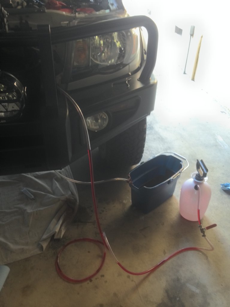

    I finally got around to doing this today. Took me nearly all day, mainly because I took my time to take breaks and double check everything I was doing. A pretty straightforward process once you've done it yourself.
    At 52,000 miles the old transmission wasn't too bad. It was brown and obviously compromised since it wasn't working well in terms of keeping cool.
    I followed Crom's method.
    1. Drop pan, replace filter, o-ring, clean pan and magnets, replace gasket, and install pan.
    2. Remove front grill.
    3. Remove hoses from ATF cooler pipes (see pic)
    4. Attach 7/16 vinyl tubing (store was out of 3/8) after stretching out the tube ends. Direct both to bucket to see which one expels fluid - it's the bottom one.
    5. Attach tube to garden sprayer
    6. Pump in 3 qts (drained this much during pan drop). Then start engine and stop after 2 quarts expelled. Pump in 2 quarts. Continue process until expelled fluid runs clean - took me 10 qts.
    7. Added an extra 2 quarts since I didn't want to mess with the fill hole.
    8. Start engine and let transmission fluid temp warm up to 115 -120 F. Took about 30 mins. Obviously much longer with the new fluid, before it took only 10 mins to get to 120 F.
    9. Open overfill plug and drain until dribbling fluid. Tighten plug.
    10. Clean the condensor and transmission cooler while the grill was off.
    Many thanks to the OP and others like Crom that improved the process.
