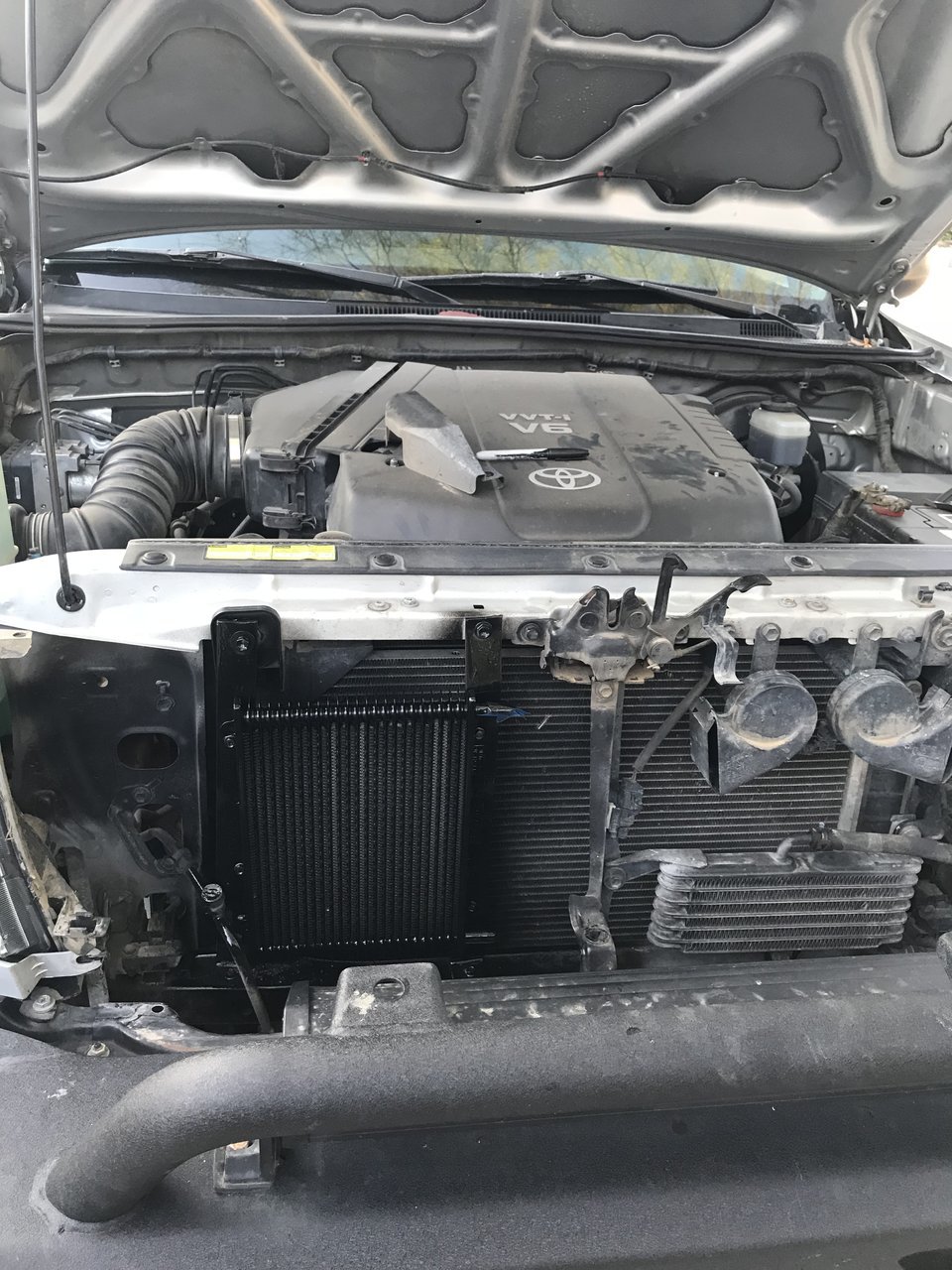

    Did you guys do 3 or 4 quarts at a time? Gonna be doing this alone

  15. Oct 30, 2017 at 11:35 AM
    #795
    nd4spdbh
    nd4spdbh Well-Known Member
    Oct 7, 2013
    #114055
    14,602
    SoCal
    13 DCSB TRD OR v6 Auto
    Pan only holds right around 3 quarts.... you dont want to pull more than that otherwise air will get into the system. Stay safe at 2.5 quarts max, 2 quarts for easier measuring.
    07 sport 4x4 likes this.
  16. Oct 30, 2017 at 11:53 AM
    #796
    anthony250f
    anthony250f Well-Known Member
    Feb 18, 2012
    #73066
    16,778
    Anthony
    San Diego, CA
    2008 dcsb trd offroad 4wd
    5E2EA11E-2A0B-422A-B8B9-6726AA669E13.jpg I’ll do 2... I just installed a tranny cooler so I guess I will do the flush first and add a extra quart
