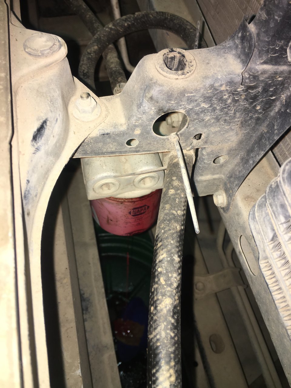

    Plumb in a remote filter mount and run a spin-on filter to help clean up the fluid as debris washes out of the TC and valve body. I'm running one. I used a 3/4-16 base so I can use the same filter as my engine later on if I can't get the 1269 for whatever reason. The 1269 is a 10 (2/20=5/17) micron nominal hydraulic filter with an 8 psi bypass, which should ensure that fluid can flow in case the filter ever clogged.
    Even an engine oil filter will be far superior filtration compared to the pickup screen.
    https://www.fleetfilter.com/filter/24764.html
    https://www.fleetfilter.com/filter/51269.html

    That would be a good idea. Does that make a mess when changing the filter ??
  20. Nov 20, 2017 at 3:43 PM
    #880
    07 sport 4x4
    07 sport 4x4 Well-Known Member
    Dec 24, 2010
    #48165
    1,453
    Blake
    Southeast
    2017 Duramax
    Where mine sits it will drain into a pan under the truck. I have accidentally splashed a little onto the inside of the front bumper cover on accident. If you're careful you won't make a mess. You can mount them anywhere you want, but there are two holes already there that fit the base perfectly and it's up where it won't get caught on anything off road. You shouldn't have to change it very often. This was mine after 4 years/20k miles. https://bobistheoilguy.com/forums/ubbthreads.php/topics/4570398/Napa_1269_/_Wix_51269
