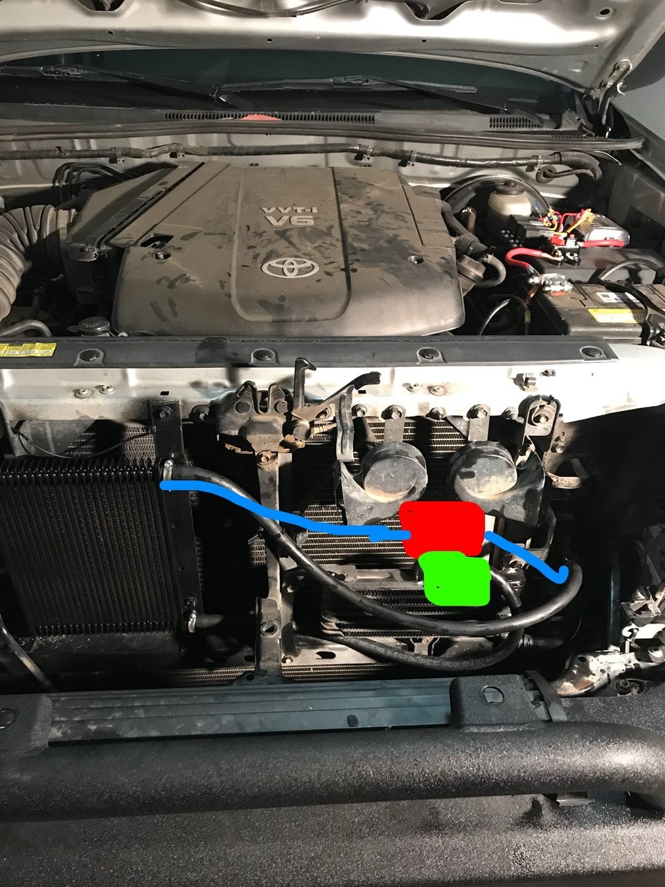

    Is that the derale base?i would probably mount mine here due to winch clearance DF763918-6DEE-4977-9CEA-041164F8E32E.jpg

    So for flow direction it would look like this ? And the green parts would use the plugs?

    The loctite should work as long as the atf doesn't have something in it that will break it down, I haven't tried anything other than the high temp thread sealer for atf applications so I can't say for sure if anything else works or not.
    That looks right.
    Look closely, it has flow arrows on it. Fluid should flow from outside to inside. Clean fluid comes out the middle of the filter through the threaded part and returns to the transmission. You can use one inlet on one side and an outlet on the other, which would be best for where you're putting your filter, or you can put the inlet and outlet on the same side like I did.

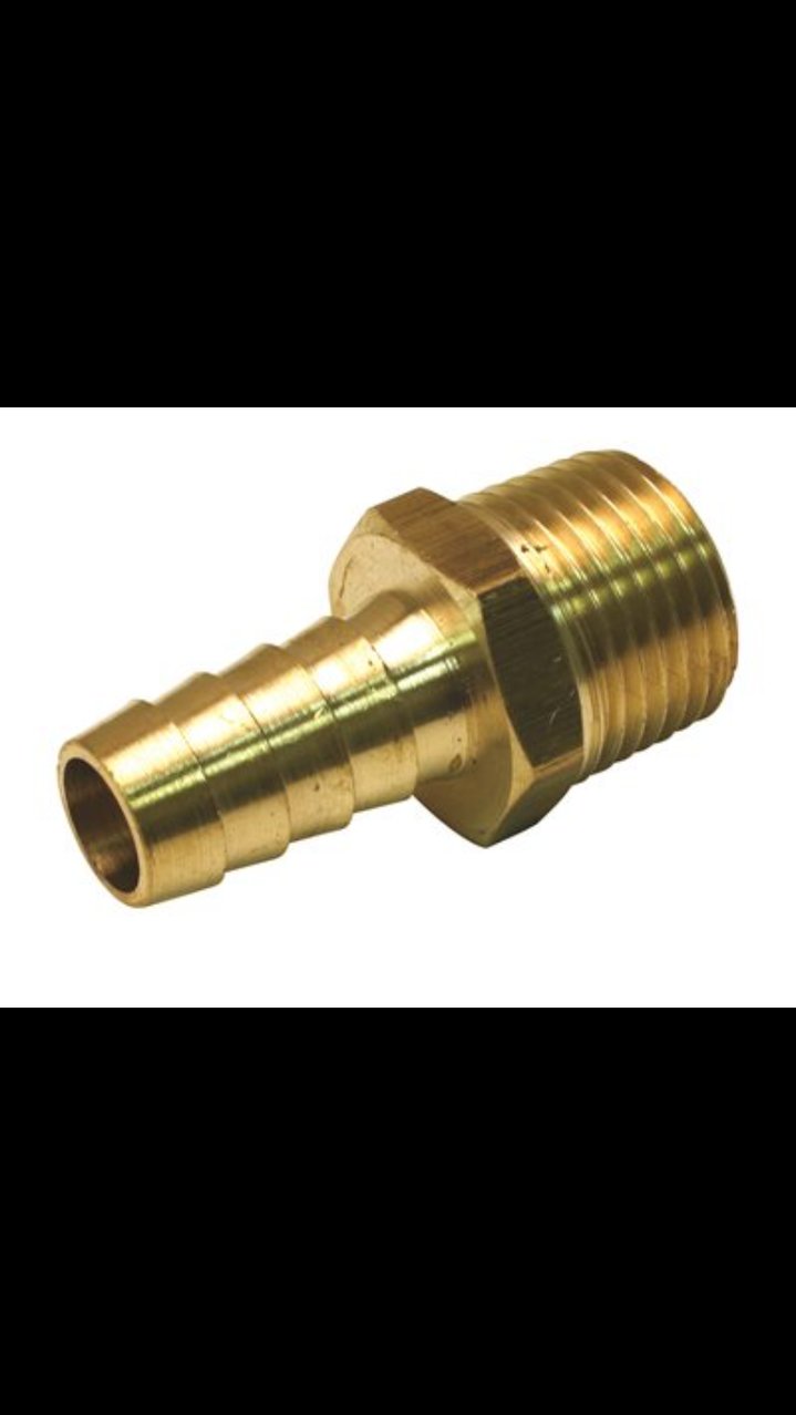

    Cool wasn’t sure if it had to be on the same side. I will order the filter/base. Did you use barb fittings ?

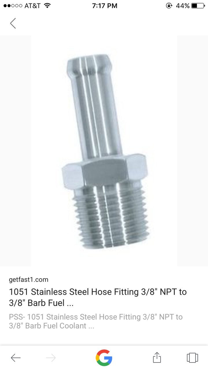

    It might help you squeeze a little more life out of it. I used a barb fitting for one and a flared looking fitting for the other, that's all my local napa had in stock. I had to get two adapters to go from 1/2 to 3/8 to fit the base Iirc. The barbs were 3/8 npt and the base was 1/2 npt, best I can remember. The hose barbs looked like this: (both were brass I think)
    I prefer the one that's flared like the OE lines, but they both work fine and don't leak.

    I looked, the fittings I like are a "beaded barb" type.
