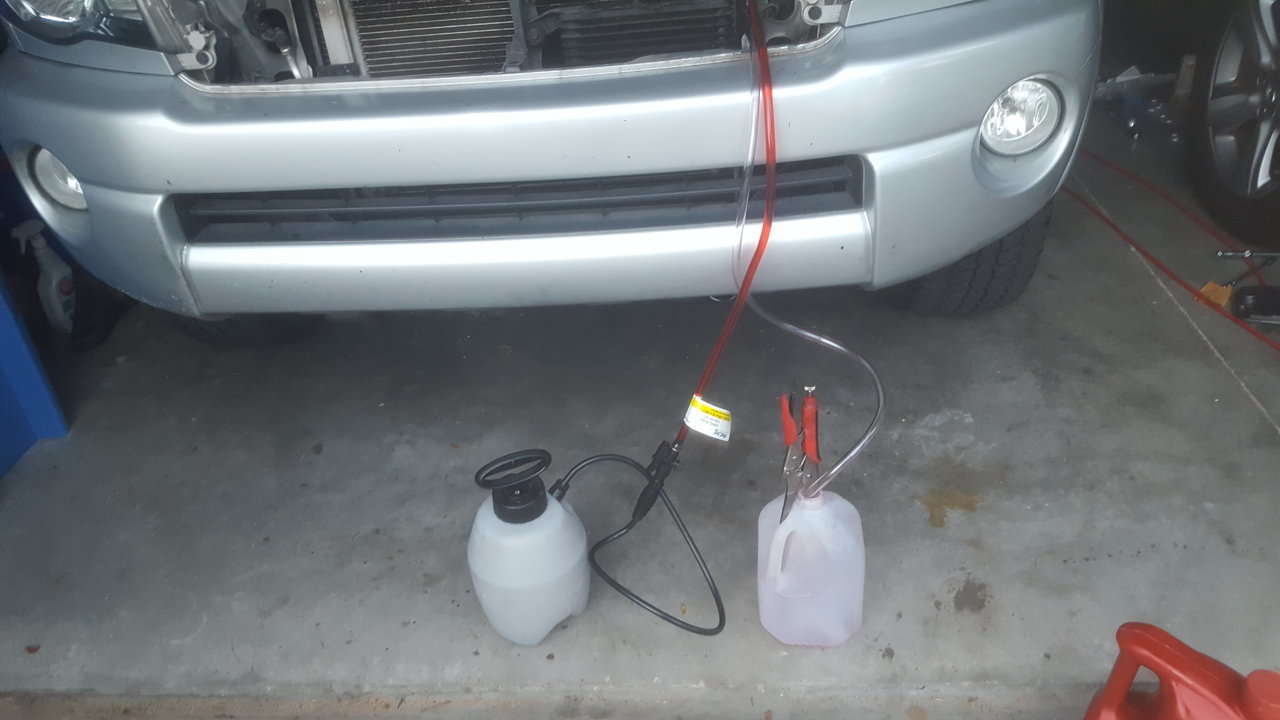

    sprayer pumps
    what did u use to pump the new fluid in?

    07 sport 4x4

    I ran the vehicle and pumped new fluid until nothing but clean fluid ran out of the line.
