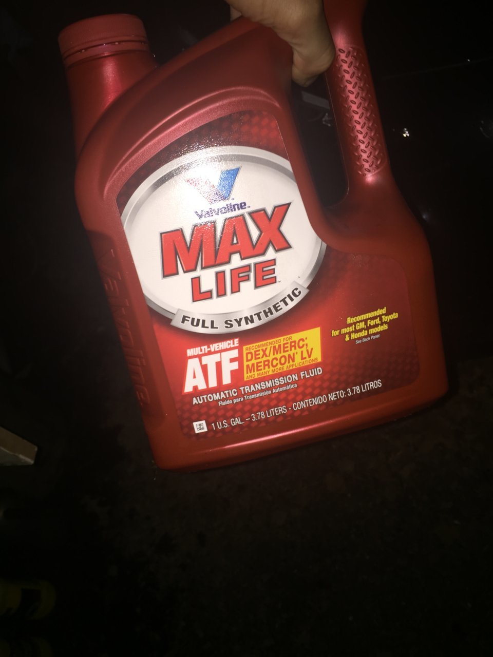

    I'm sure this has been mentioned several times in this thread....but Valvoline MaxLife is an excellent substitute for Toyota’s WS fluid. Been running it for years in my FIL's '04 Sienna and my daughter's '10 Yaris. Both are well north of 100k miles and shift flawlessly
    At about $5 a quart....it's hard to beat

    That’s what I ended up getting. I’ve noticed that it’s frequently sold out at my local Walmart. You gotta grab it when it’s in stock because it won’t sit on the shelf very long!
    The 1 gallon jugs are $18 at Walmart, the auto parts store wants $28 o_O

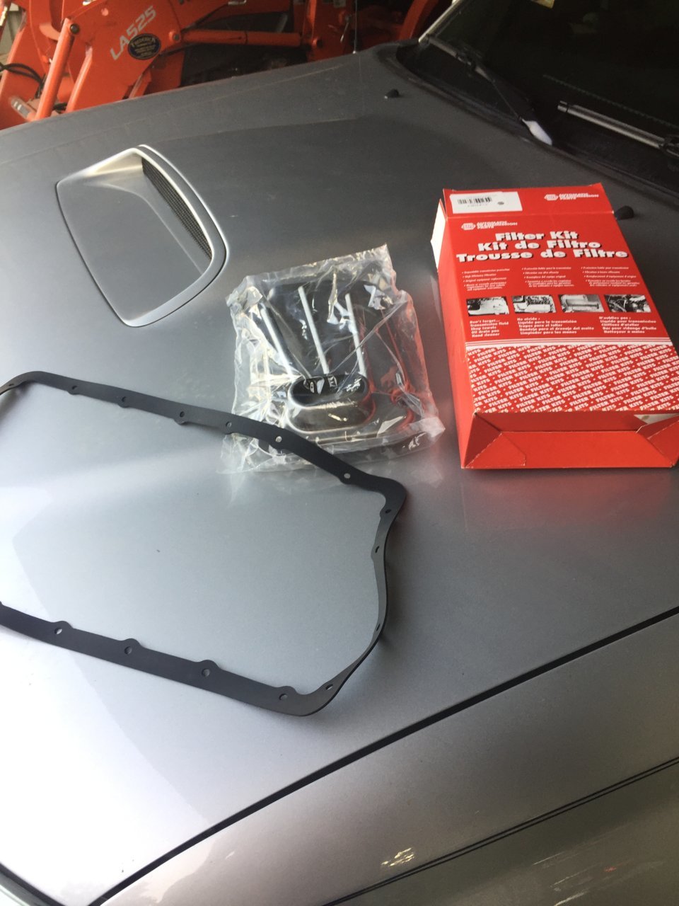

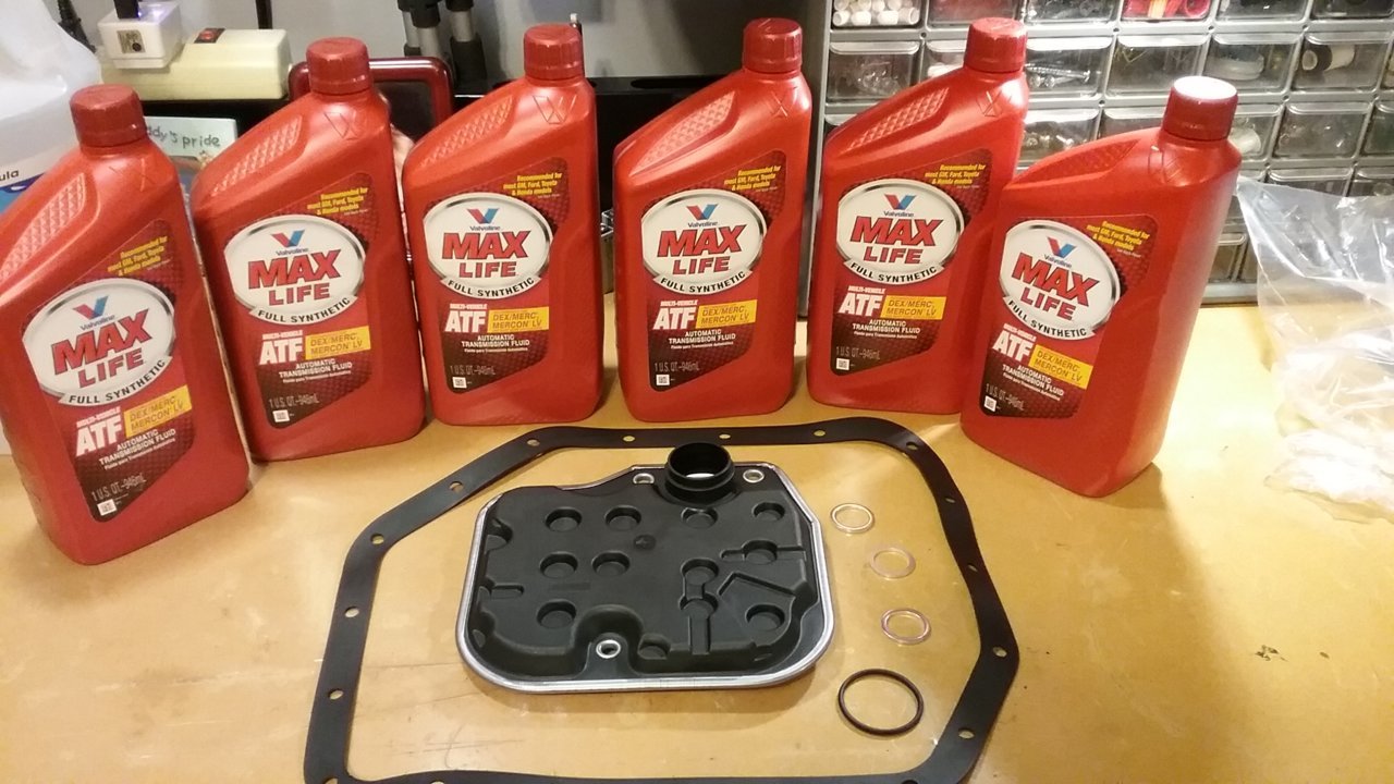

    Picked up the filter and gasket from NAPA today. One bolt hole on each of the 4 sides of the gasket is slightly smaller to ease installation (stick a bolt in those holes to keep the gasket lined up correctly). Also, the metal screen is very fine. Could almost make coffee with it. Def a good idea to replace every so often.
    Count the number of bolts on your tranny pan. There’s a 19 bolt version and a 20 bolt version. Mine was the 20.

    WalMart store didn’t have Valvoline Max life synthetic atf in stock so I ordered it from WalMart online. I wanted quart bottles so I could use my pump. It was $5/qt online with free shipping so I got 15 quarts. They mailed each individual quart in its own box. 15 boxes showed up. o_O
    Still an amazing deal, I’m just surprised how they shipped it.

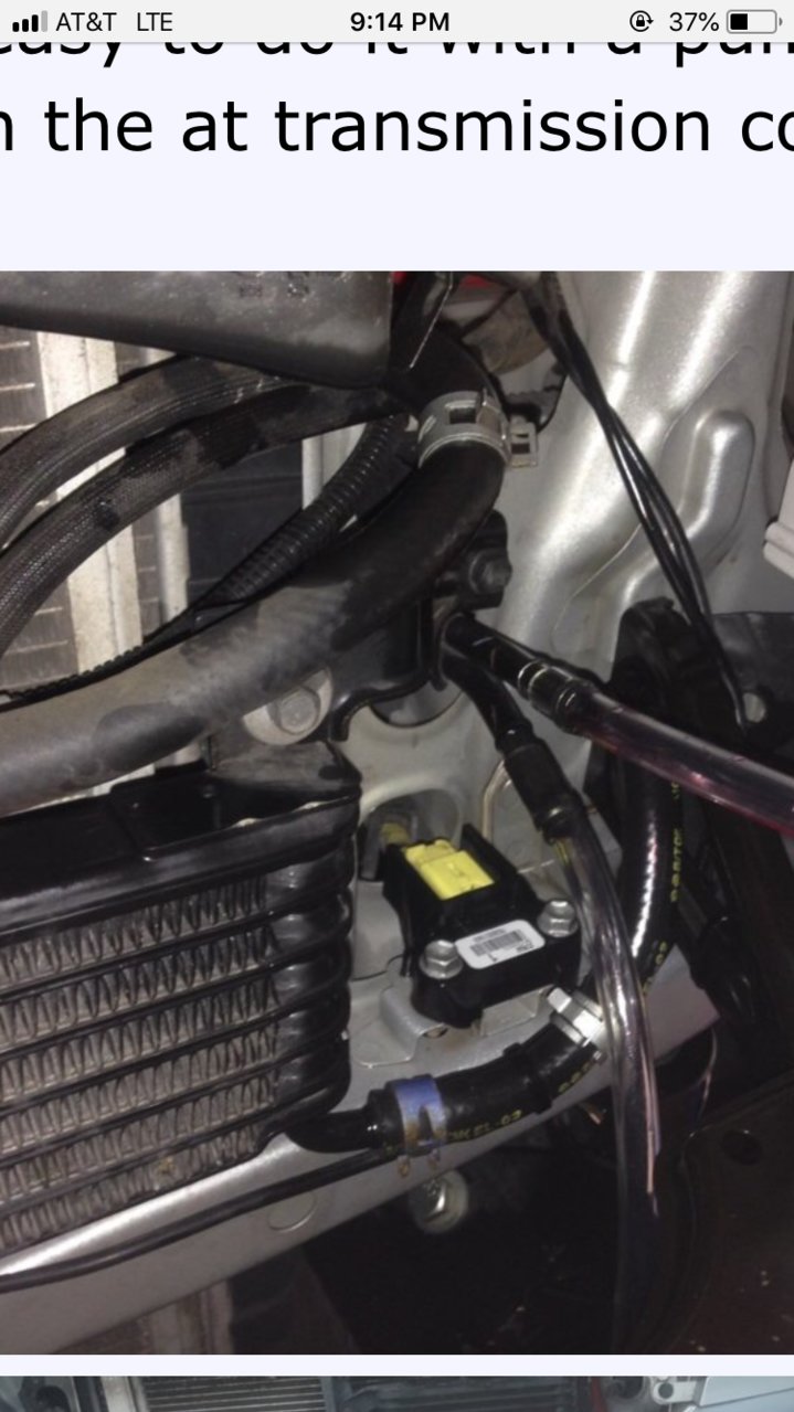

    Next time get one of these and a 3/8” ID hose barb connector and pump your fluid through the return cooler line, it’s so much easier. I haven’t even pulled the fill plug the last couple times I’ve done this.

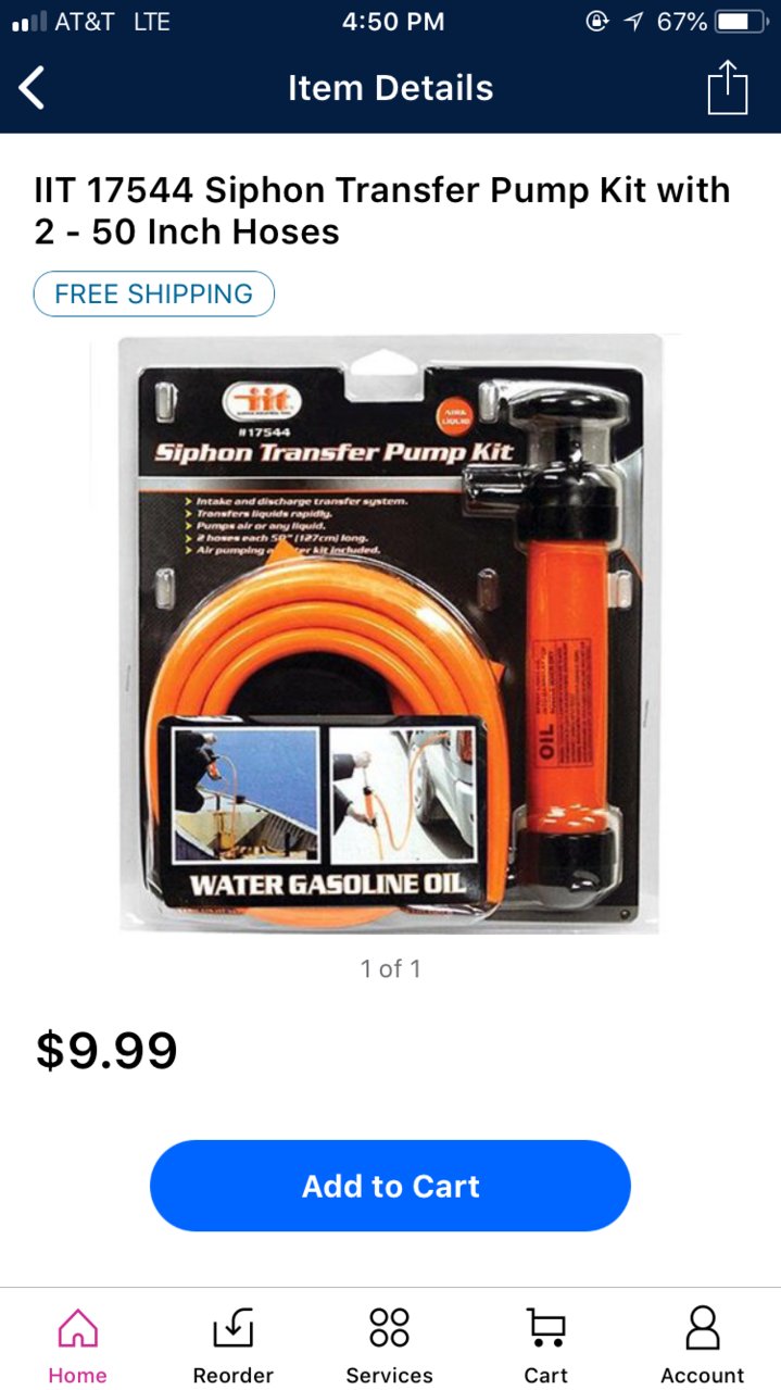

    I'm doing this service this week and have a siphon pump. Which one is the oil cooler return line to fill from?
  14. Sep 1, 2018 at 2:50 PM
    #1054
    TheDevilYouLove
    TheDevilYouLove You can’t polish a turd, but you can polish a TRD
    May 26, 2016
    #187953
    2,897
    Steve
    Marylandistan
    2010 Tacoma TRD Sport Access cab 4x4 silver streak
    Top line coming out of tranny (passenger side). Trace that up front. I think it’s the more forward/upper line at front of truck. You’ll have to remove the skid plate

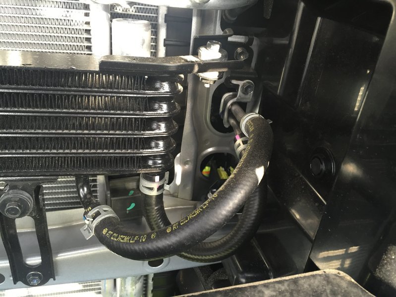

    If you have the towing package you’ll be collecting old atf from the bottom fitting and pumping fresh fluid back into the top. If you attach the lines as shown in this pic, you don’t need a hose barb.
    Edit: if you have a newer truck the atf cooler will look different than the older trucks, but should hook up the same.
    Newer style cooler
    My truck, line connected to pump out old fluid. You could connect a hose using a hose barb to pump in new fluid or remove the other end of that rubber hose to connect to the hard line directly and skip the hose barb.
    Another view of the old style cooler like my 07 has. DF31AE46-2C1D-4BED-9B7E-1ADBC504218D.jpg
