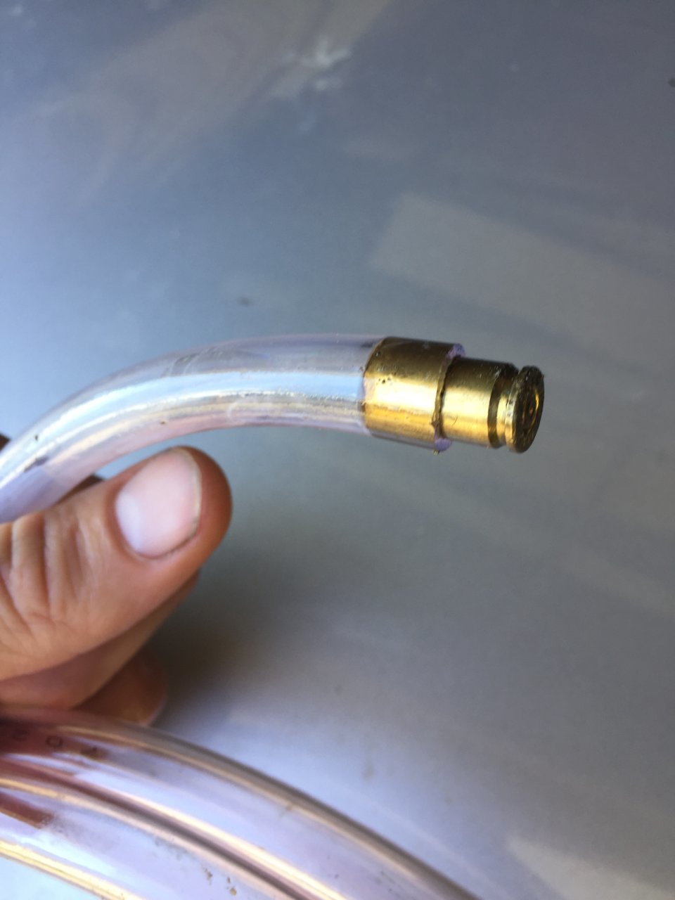

    I am saving my 3/8” clear tubing for next time. A 9mm shell casing fits in there perfectly to keep dirt and debris out.

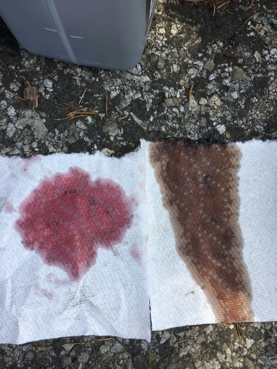

    I’m not sure what the specs are but here’s what mine looked like at 127k of highway driving (no towing) compared to new fluid. I don’t think every 60k would be overkill.

    This was the first collection after draining the pan contents first. Not awesome looking after ony 39,000 miles. Glad the old stuff is out, along with all the other fluids.
