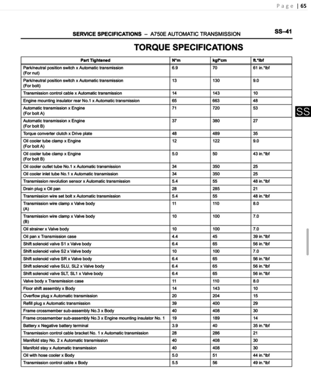

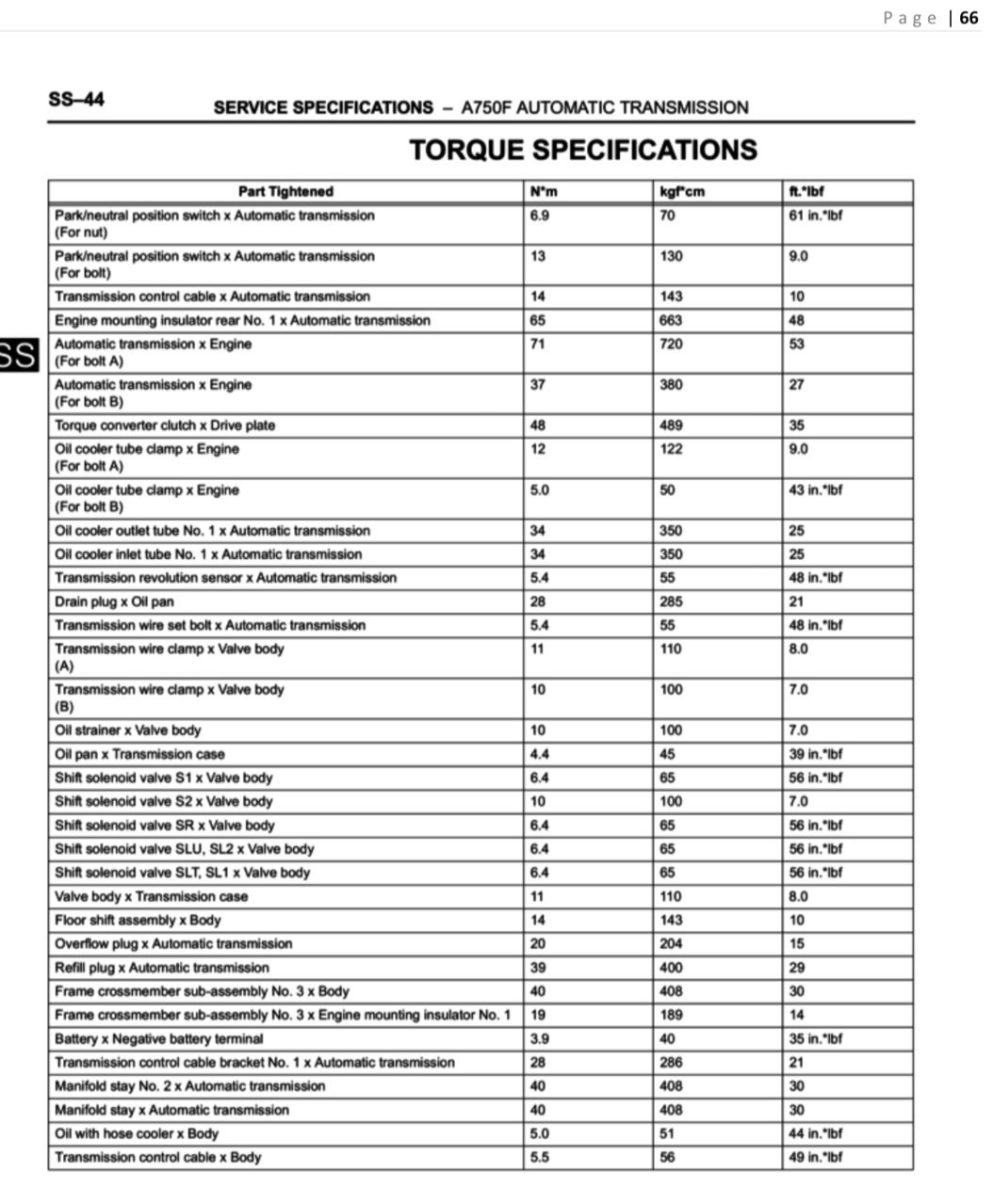

    For all of you that are dropping the pan and replacing the screen filter, what are you torquing the 20 or so drain pan bolts to and what about the bolts that secure the filter. I know there’s a couple torque spec postings floating around on TW, but couldn't find a listing for these bolts. I’ve done tranny services on Toyota’s before and usually just used a 1/4 inch ratchet to gently tighten the 10mm bolts to “feel”.

    yes just gently tighten when bolting pan back.. pan was not leakin i just figured since doin a full system flush i would do the gasket. no need to replace the filter cuz its a metal screen. i barely put any torque into gettin the pan bolts off, so i just tightened them back lightly to feel(not tight at all), i mean they were so easy to remove i surprised there werent any leaks. im second owner and im sure no one tampered with doing this before me so thats how lightly tightened the factory does them..i got truck at 40,0000 miles. as i said no leaks under pan but i just did the gasket so wont have to worry about it in near future..

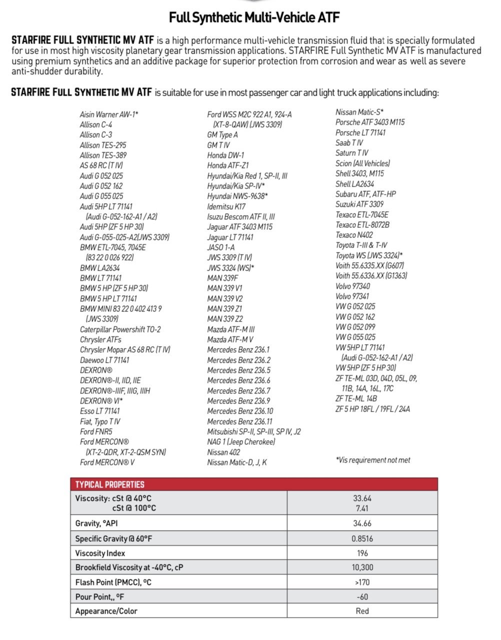

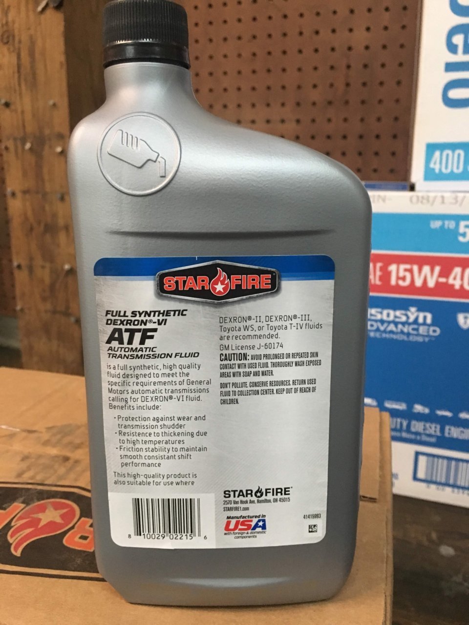

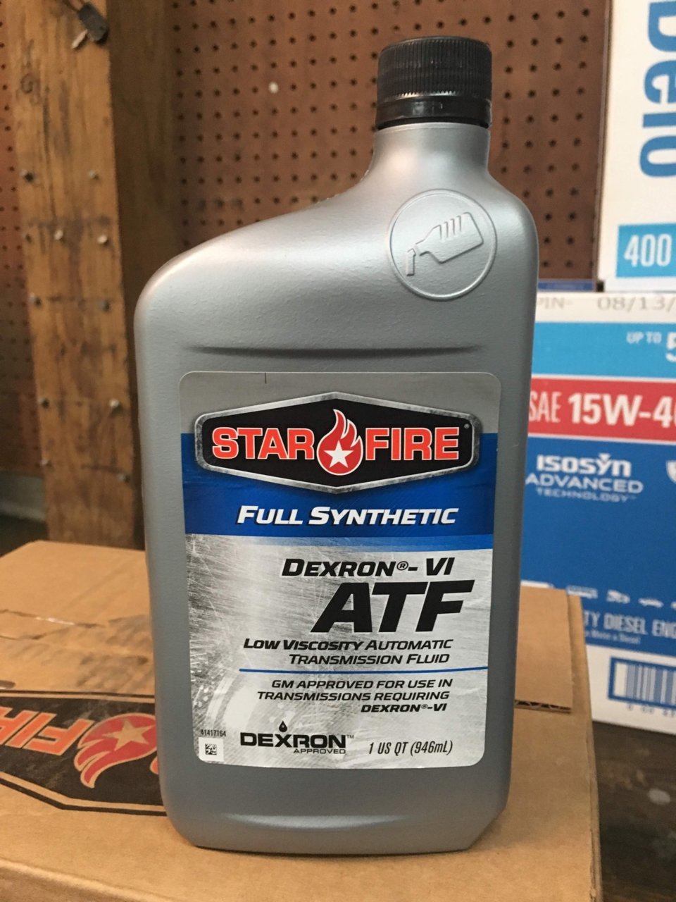

    Has anyone here used Starfire full synthetic ATF? I work for a Lucas/Starfire distributor and can get it pretty cheap.

    I’m using the Dex 6 in my Chevy’s. It says it’s “suitable for use in WS applications”. The Full synthetic that you are referencing is this one I assume, it’s a higher viscosity more like a Dexron III/Mercon V. Either one would/should probably work fine, but a low viscosity fluid like the Dexron VI is going to be closer to the viscosity of WS. For Toyota Type IV ATF I would use the multi-vehicle full synthetic if it were me.
