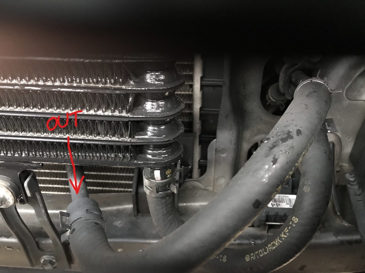

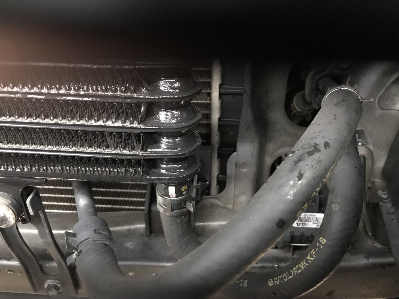

    I just did this over the weekend and to answer @Micbt25 post above the correct line to pull out to drain old fluid out is the one on the LEFT (passenger side) of the transmission cooler. My truck is a 2012 but if anyone has a similar trans cooler, this is the line to pull out and hook up your drain line to (I used 3/8" clear tubing).
    I routed a 1/2 inch clear tube down the back side of the engine down to the fill hole under the truck and attached the tube to a funnel up front where I can easily fill with new fluid. This was much faster than filling from the return line at the trans cooler since the fluid flows straight down into the fill hole rather than through the small hardlines with all the twists and turns coming from the trans cooler to the pan below.
    I drained exactly 3 qts from the pan. Filled with 3 qts Toyota WS fluid. Pulled the trans cooler line, attached drain tube, started engine, drained 2.5 qts, turned off. Refilled with 2.5 qts. Repeat until clear red fluid came out. Took 11 qts 12 oz.
    Hope this will help someone else who hasn't figured out which line to drain from with a similar transmission cooler. This method also flushes your transmission cooler rather than pulling the other line going into the cooler. Also, removing the front grill makes it so much easier to access. Enjoy!

    @Micbt25 I forgot to mention that contrary to what another guy said earlier in this thread, the ATF fluid coming OUT of the trans cooler actually flows back into the transmission pan. It does not go into the radiator so pulling out the line I indicated in my post above will flush out all the old fluid from radiator AND the trans cooler. Just wanted to make that clear.
    So for a better understanding, if you have a the towing package with the stock transmission cooler, transmission fluid will flow like this....
    From Transmission > Radiator > Trans Cooler > Transmission Pan
    I'm not sure if this is different with other gens or model years but on my 2012 this was the flow.
