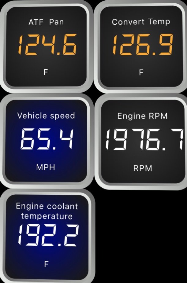

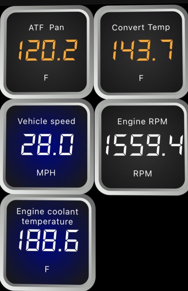

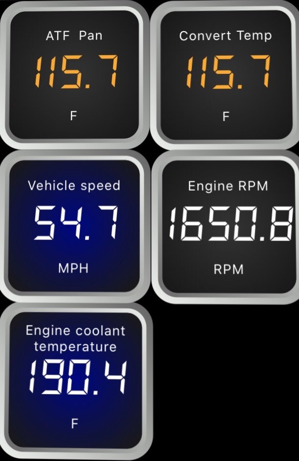

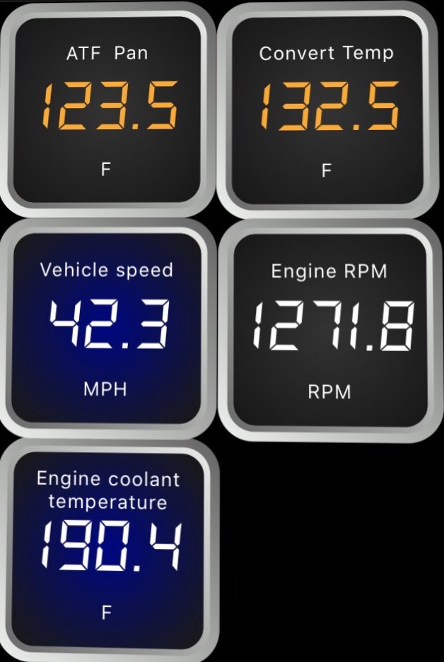

    it’s generally running about 10 degrees cooler, but I haven’t driven it too much since I installed the bigger cooler just 30 minute drives around town. Here are the screen shots from my ODB Fusion, these are all after the installation of the larger Tru-Cool LPD LPD4589 cooler:
