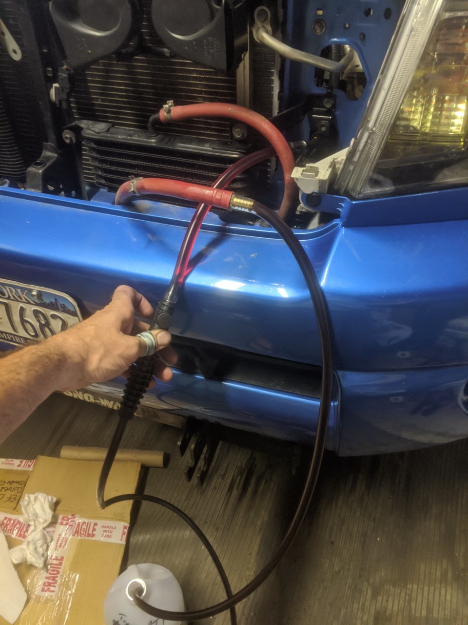

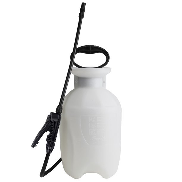

    That looks like an easier way! Did you use some kind of pump to get it back, or is there enough "suction" to pull the new liquid in from let's say a bucket ? How much did you use ?
  3. Jul 20, 2020 at 11:47 AM
    #1263
    spitdog
    spitdog Well-Known Member
    Sep 2, 2014
    #137440
    3,718
    2015 Access Cab V6 4x4 SR5 MGM
    He used one of these.

    I used what @spitdog referenced. I did about a gallon at a time. After pumping pressure into the sprayer I ran the truck to pump old fluid out until I started to see air in the fluid. Turned it off, repeat until done. I over-did it and used about 4 gallons/16 quarts. But I also did a pan drop first so needed to put back on the same amount of fluid first before flushing.

    The pump sprayer is a no brainer. Cheap and simple, and works good. Way better than hand pump.

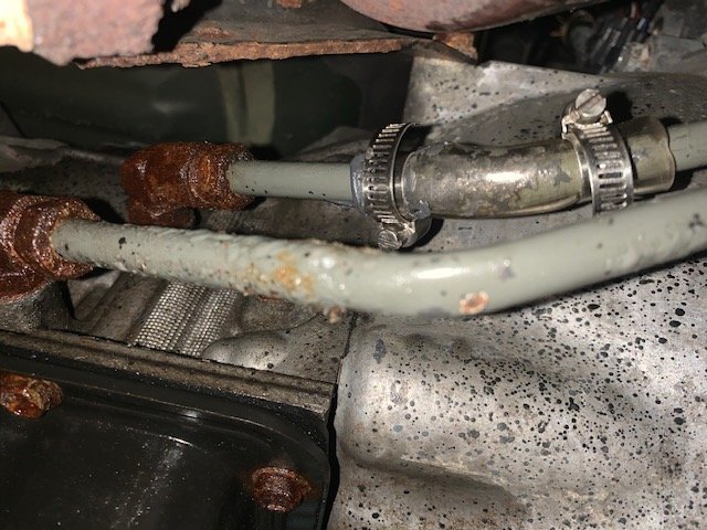

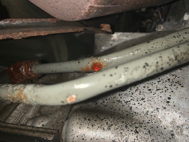

    Great write up. I am getting ready to have a go at this on my 2009 Sport with 100k miles. I also have a new filter to go in. But the real motivation for me is that I also need to replace a rusted out trans cooler line... the trans inlet hard line at the tranny. I have those coming today... and I need to inspect the other cooler hard lines which will be easy when I get in there to do the flush. Leaking tube shown below and again with my temporary patch.

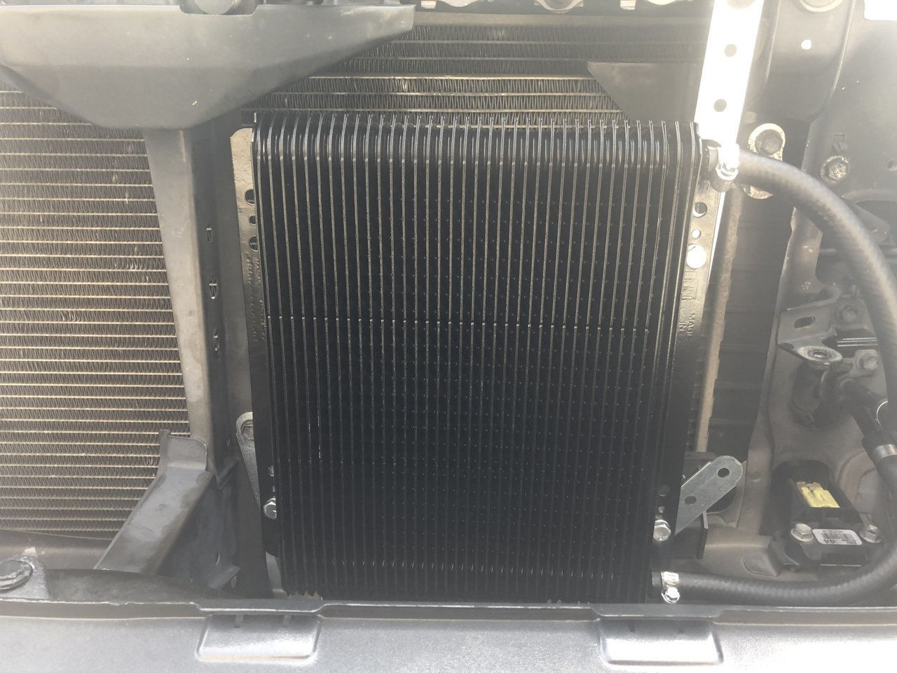

    looking at getting that cooler, are these two the same? One is $71, the other is $50??
    https://www.ebay.com/i/322408710403?chn=ps&norover=1&mkevt=1&mkrid=711-117182-37290-0&mkcid=2&itemid=322408710403&targetid=935065067427&device=m&mktype=pla&googleloc=1013697&poi=&campaignid=10897343686&mkgroupid=106040615014&rlsatarget=pla-935065067427&abcId=9300403&merchantid=101684232&gclid=Cj0KCQjw-af6BRC5ARIsAALPIlV0G5_S4KdAN_Y4NMn_Kl8Sg9cUU2RFmGx-6IxvKrX5dv0osjHXiRsaAmXYEALw_wcB
    https://www.ebay.com/i/253715270129...AdAK3MIRGSQbjTPEl92DzTBQqhYILSkoaAq-6EALw_wcB

    What size hoses/attachments did you use with the sprayer method, I’m ordering the sprayer now and might as well get the hoses and fittings too.
  20. Aug 29, 2020 at 7:03 AM
    #1280
    pmstoy10
    pmstoy10 Well-Known Member
    Mar 15, 2012
    #74978
    1,233
    hudson valley, ny
    2010 Tacoma DCLB TRD Sport
    Weathertech Floor Liners, UWS Toolbox, Seatbelt Chime Mod, Coverking Covers, Window Guards, Wheeler's 1.5" Single Leaf AAL, Rear Spring TSB, Front Bilstein 5100's @ 2.5", Rear Extended Travel Bilstein 5100's, removed front mud flaps, Lifetime LED Headlights, Firestone RideRite Air Bags with Daystar Cradles, Light Racing UCA's, ECGS Front Diff Bushing
    Damn good question.
    IIRC Pretty sure I used 3/8 ID tubing. No fitting needed on the sprayer end, I was able to just remove the straw wand from the sprayer and shove the tubing on. Then the tubing slid right onto the metal input line.
    The other line (which went into the container with old fluid) was a 3/8x3/8 barb from the discharge of the cooler so that got flushes by the trans pump too.
