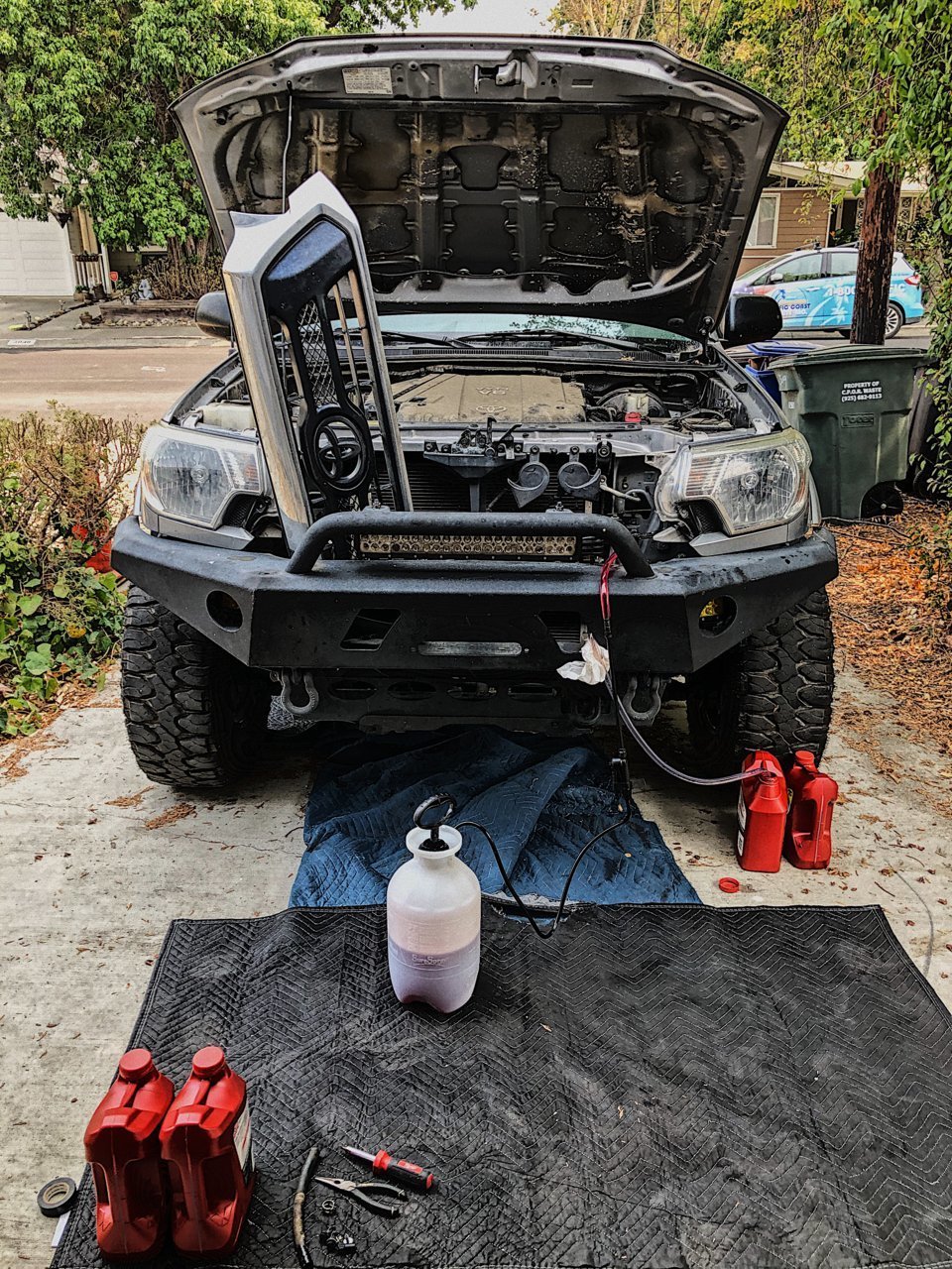

    Completed my full flush for my automatic transmission last week. Shout out to mountain lion(OP) and Fortech(OP) for their invaluable assistance. It took me awhile to finish, primarily because I'm a tad bit slow.
    I used the 5 gallon pump sprayer to refill my transmission with Valvoline Max-Life synthetic. That worked like a charm! When I put my Tacoma into AT temp check mode, it surprised me how quick it entered. I double checked the next morning with the air temps a little cooler and after about 11 minutes my Tacoma entered AT temp check mode. Just a trickle came out both times.
    Once I got comfortable with the procedure, it went as both OP's indicated. Felt good completing that task. Saved some $$$ for sure.

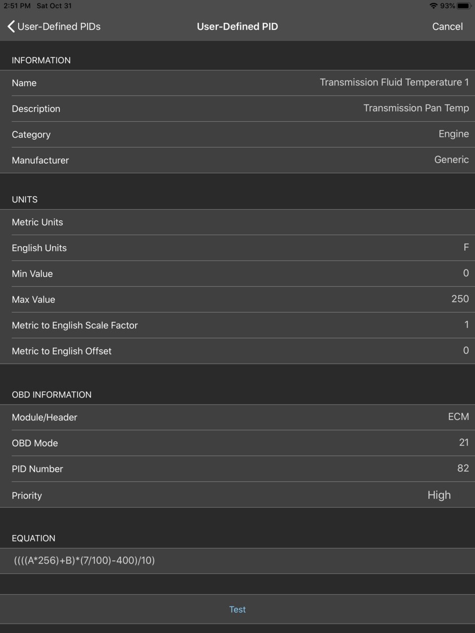

    I just installed the obd fusion app and both trans temps are there after adding the Toyota advanced diagnostics add on. Is the pan temperature #1 or #2?

    Its one if your equation is the same as mine.7A6F6408-4166-4954-B059-F462AE288760.jpg

    Thank you! So pan temp is #1.

    Yep

    Thanks for the write-up. I'll add a couple things that weren't in the OP but I'm sure have been mentioned at some point. I have a 2015 TRD Sport, when I initiate AT Temp mode the light will come on for 2 seconds but does not come on again when put in park. I tested it out before doing the flush and although this doesn't match the procedure from the original post, the truck was definitely still in the AT Temp mode (light comes on when the correct temp is reached).
    I picked up 12L of Toyota WS fluid for the job. I flushed about 11.2 liters of old fluid out. I added 300mL extra before initiating the AT Temp mode to check the level. When the light came on I removed the overfill bung and nothing came out. I added my final remaining 500mL and tried again. This time once the light came on about 250mL came gushing out before it turned into what I would consider a light trickle. So it appears mine was low ~550mL.
    My hand pump that threads onto the bottles took forever to pump all that fluid. Got me thinking of upgrading in the future. Anyone know of a good option? The Mityvac MV6400 looks like a good option but a bit pricey for what it is.

    How much does that aerate the fluid?

    .1%

    I'm just looking back at the recent posts about this sprayer method now. Wish I would have seen that before hand pumping 12 liters of ATF! Going to definitely use a sprayer in the future. Thx for the tip
